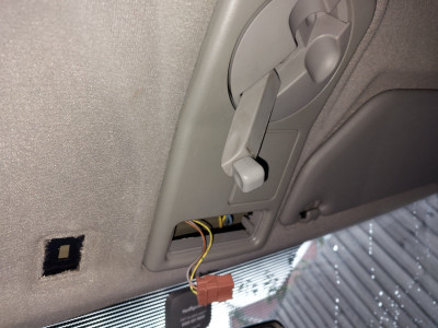

I struggled to find information with illustrations, hopefully it will be useful for Saxo owners.

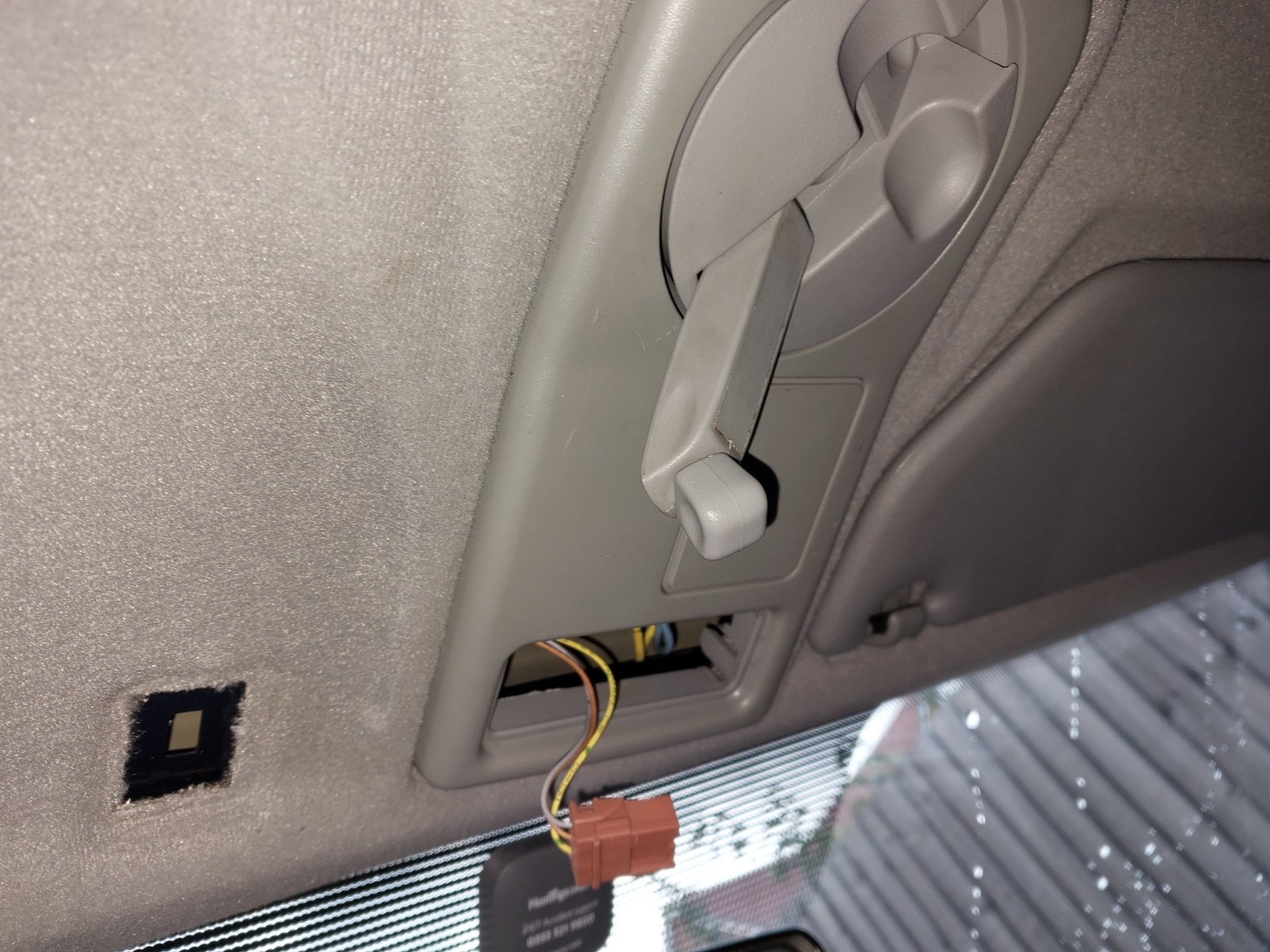

Issue didn't exist until 2 weeks ago when we had heavy rains in the UK. after that rain i started to drive and water was dripping from central interior roof light panel (where light and sunroof handle located, check picture).

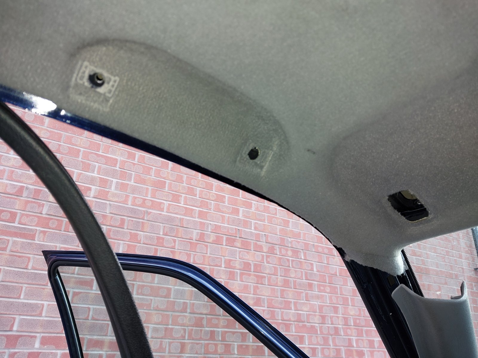

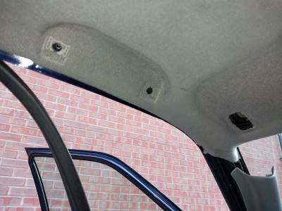

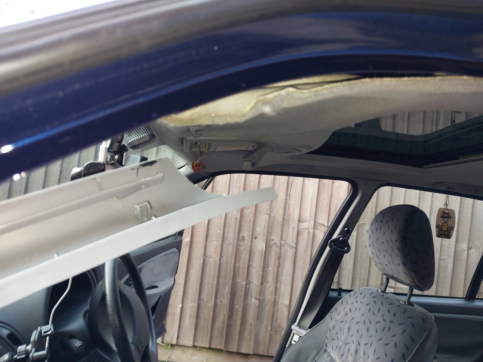

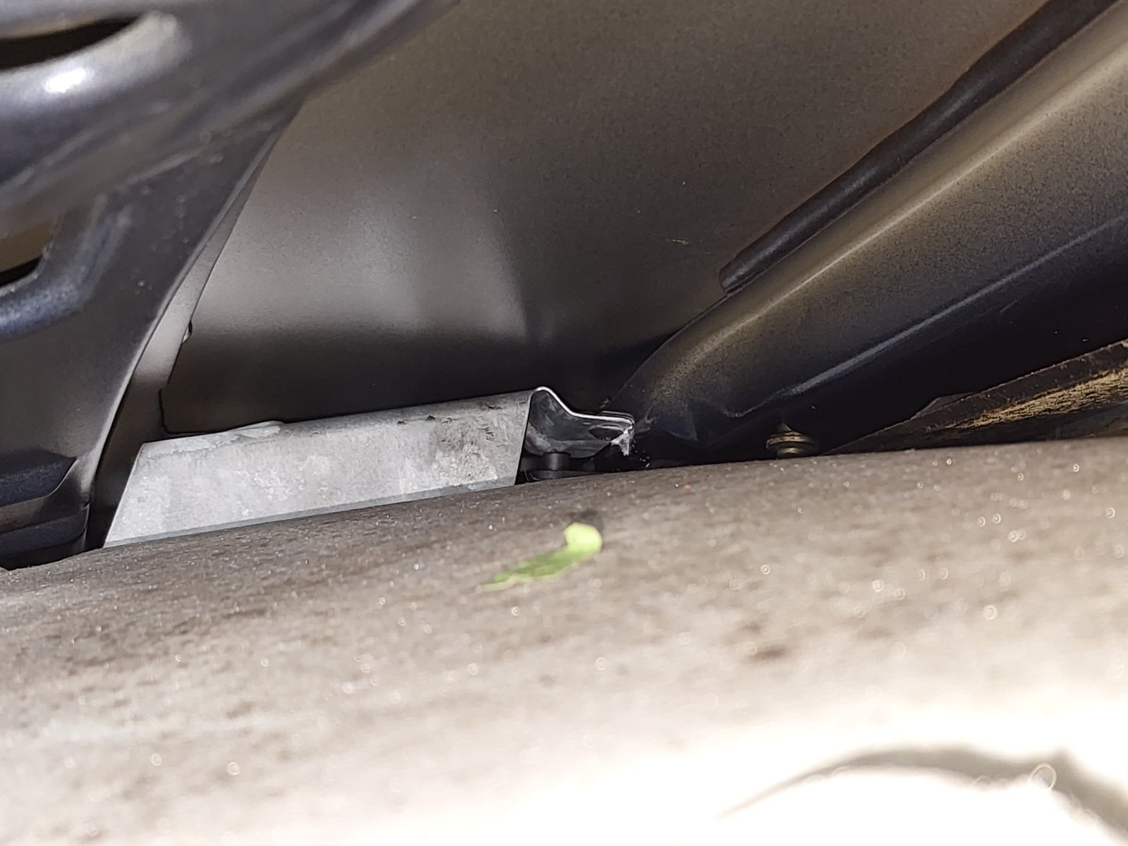

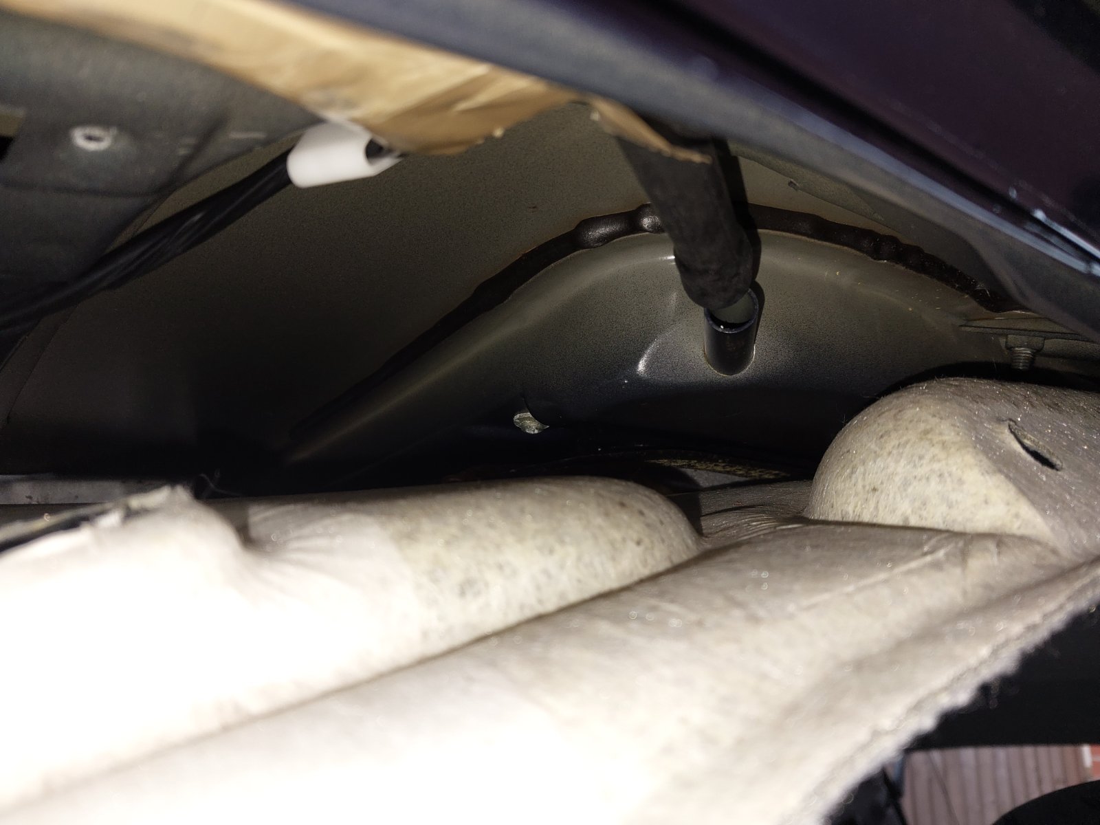

First of all you can't clean drain pipe from sunroof because 2 holes(both are in front only) are hidden behind sunroof alluminum rail. The only way to check them is to remove handle above the door, sun shield and plastic cover from pillar, this will allow you to remove roof headliner.
I still dont fully understand why it was leaking. My sunroof frame corners are not rotten, water drains when i check my pipes, car roof aerial is dry.
Maybe my 26 yo sunroof rubber seal let too much water inside and 2 hole couldn't handle it. Or because i was parked with front part of the car higher than rear, water collected below 2 drain hole, when i started to drive it all couldn't leak from 2 drains immidiately and the rest of the water poured from the unsealed gap near sunroof handle. It's my only guess.

When i first found topic where people found leak from aerial, it looked to me as an obvious cause which is also very easy to fix. But unfortunately it's not the reason i my case: solidly attached, not even little gap available. When it was leaking - aerial fixing was dry (i could see it when removed the light).

Luckily mine isn't rotten at all (check photo).
Did you clean drain pipe from underneath on Saxo yourself? I removed plastic cover in wheel arch, also checked disassembling videos. Pipe cannot be reached from underneath.
Also it's cleaner and easier job to reach pipe from headliner
