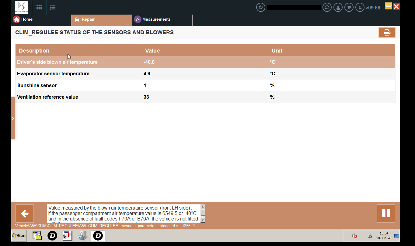

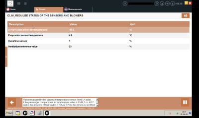

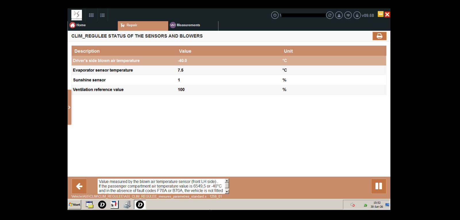

Have just as promised checked the Evap temp with the car in garage.
Run it up to temp first with the AC on and with fan motor at 100% the Evap is around 7.5C then with the fan motor speed reduced to 33% it drops to 4C with less air flowing over it to warm it up. There is variance on the figures slightly but not a great deal and at no time does it get down near 0C.
As I mentioned when its run like this or driven at around town speeds it is fine and the reduction in air flow and subsequent icing of the evaporator does not occur.
I checked too again with it running and cycled through all the flap positions and diagbox reflects each change from 0 to 100%
I think what I need to do is on a warmer day later in the week is take it for a trip on the motorway with diagbox connected so I can see the readings when the fault happens and try figure it out from there maybe ?

Forgot to add the screen shots from diagsoft (Vin removed)
