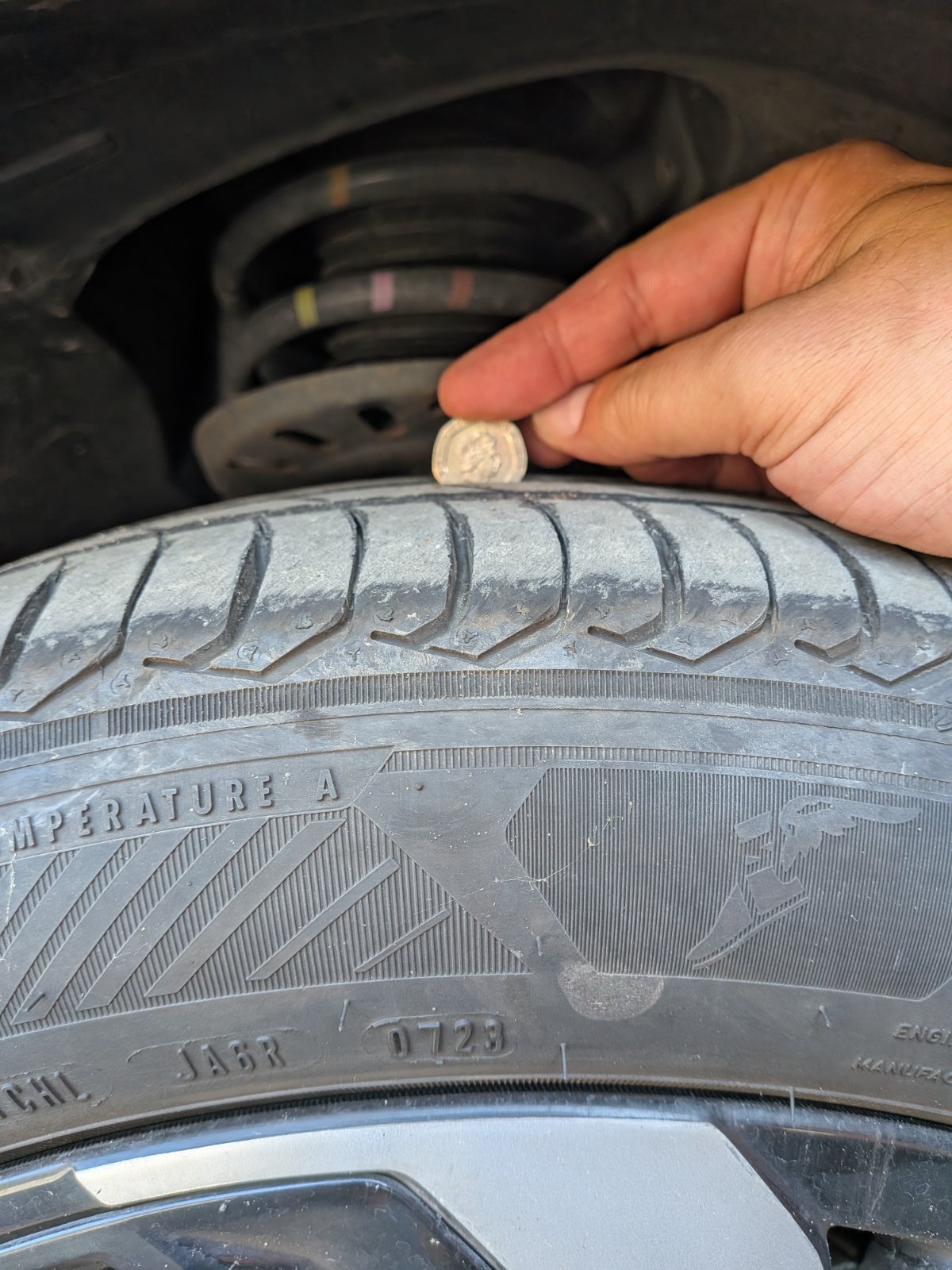

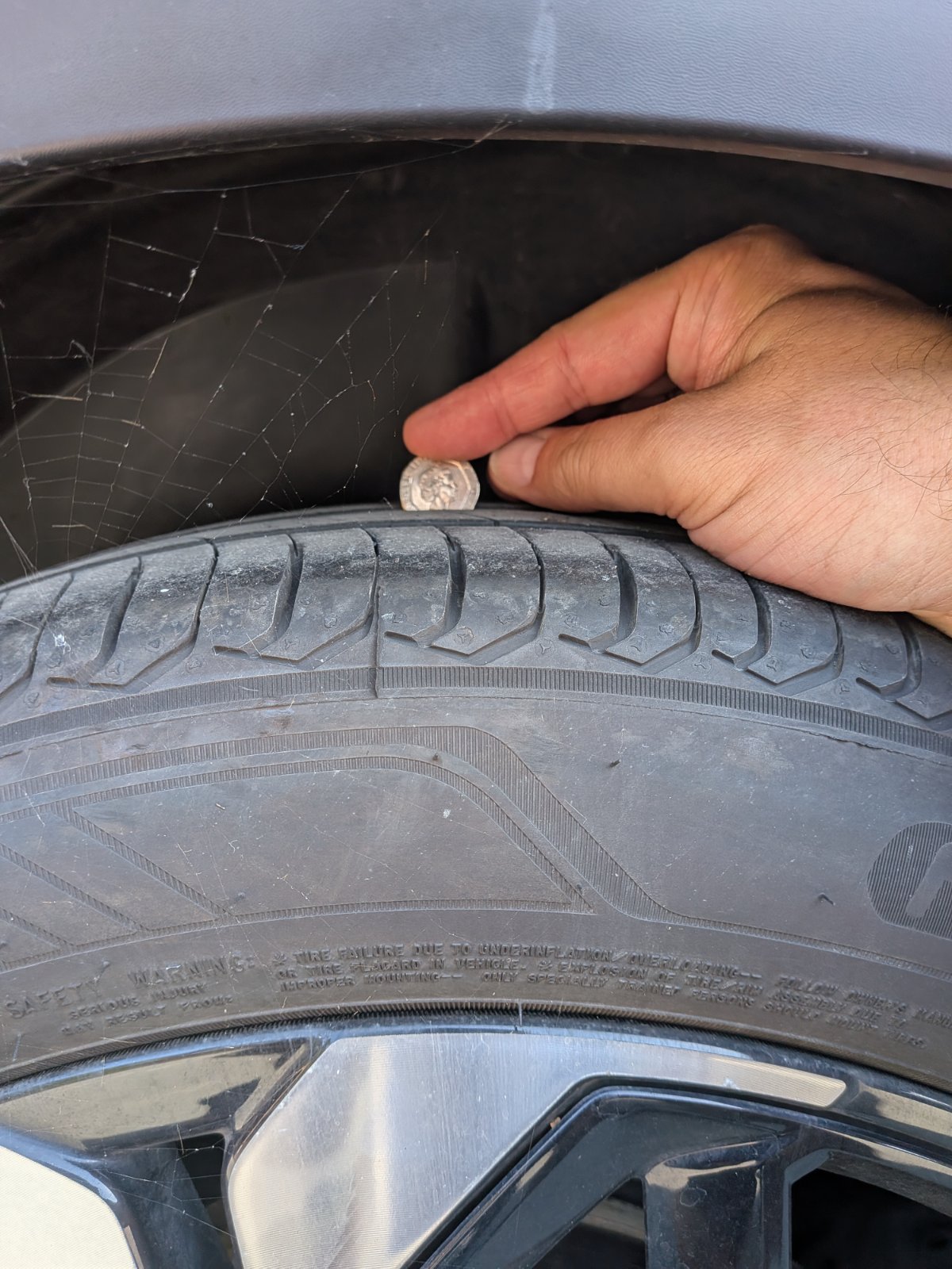

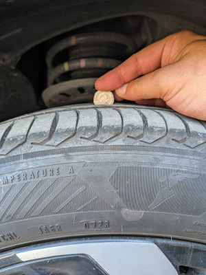

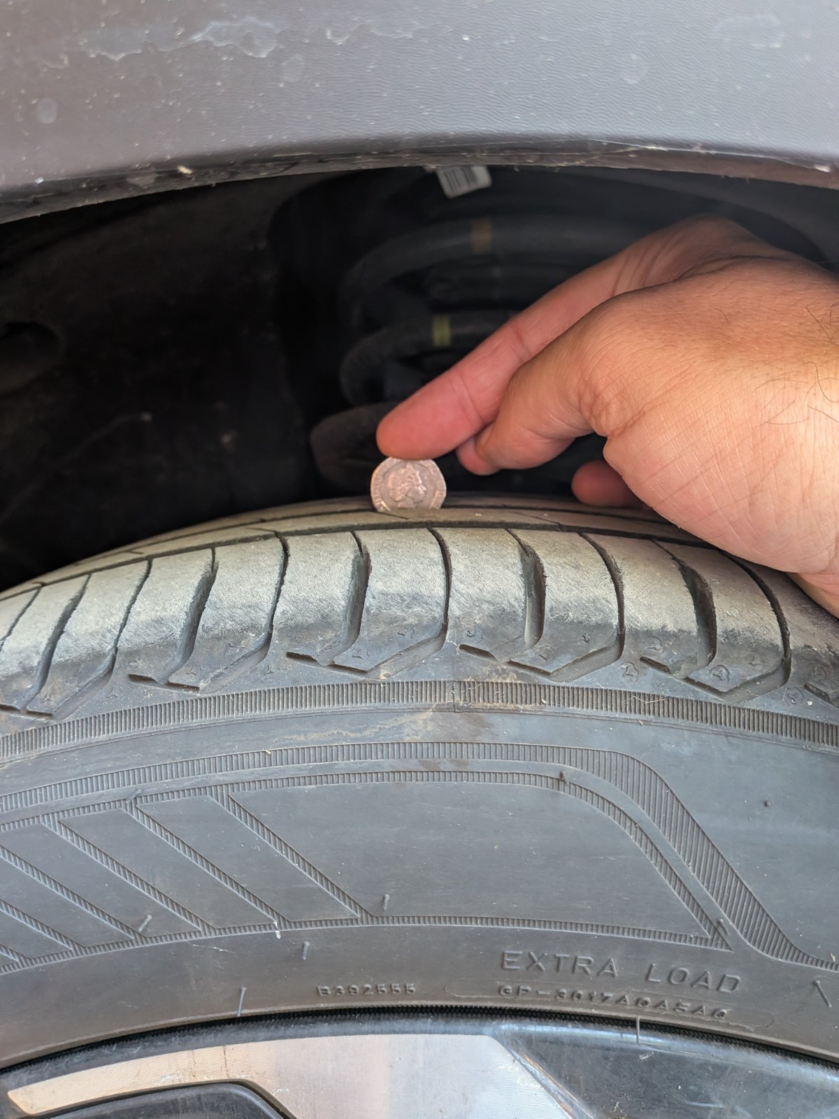

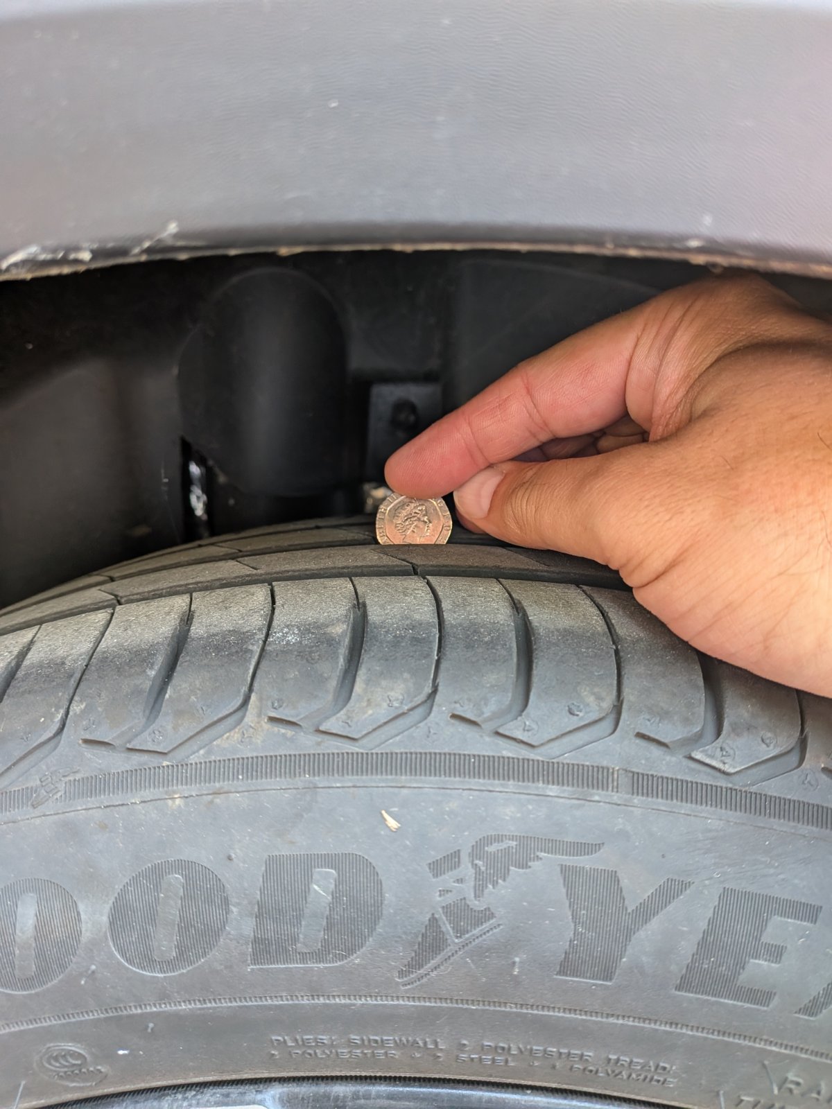

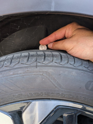

Thanks for that, tried the drag option and it's really easy. I took these pics yesterday.
There was something about a 20p showing the min tread depth so I took the pics with that in the groove.

They look to have 3 mm tread depth left with the minimum 1½ mm so not many miles left, only a few thousand. New tyres have about 7 mm. I think you will struggle to sell them unless you include the wheels and the tyres are free. I would keep them for the next few months to wear them out and then buy the new ones.

No way, it's a lot more than that, perhaps it's the way the 20p leans in the grooves. I'm generally light on tyres as I try and accelerate slowly and brake as little as possible.
When I sold my Fiat 500x back in 2023 the tyres on that had 5mm on them after driving 19k miles and these definitely have more on them.

Probably best to measure the depth better as I just looked at the photos and measured a 20p to get an idea.
