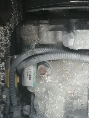

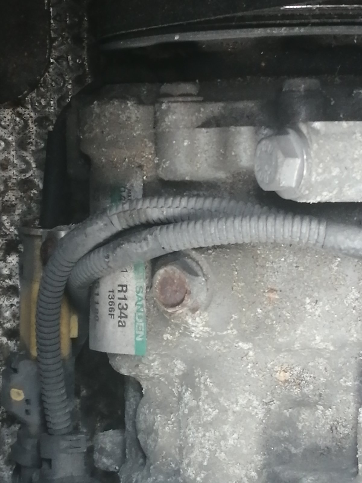

No labels on the slam panels of either my 2013 C5 X7 or my 2015 Peugeot 308. However on the a/c pump on the C5 X7 can be seen this label.
Can't see the pump on the 308 from the top so can't say either way whether there's a label there. But from previous experience I know it's R1234yf.
