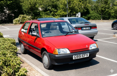

Yesterday I had a play with Gemini AI to see how well it could colourise this black and white image of Strawberry and one of her friends.
First attempt.. I simply asked Gemini to colourise and nothing more...
:shock: I guess she must be cold :lol: Spot all the other mistakes too...
Then I tried again with this directive:
Please colourise the image. The car (Citroen AX) in the foreground should be red with black bumpers and amber front indicator lenses. The other car (Citroen Xantia) should be silver. Do not alter any background details in any way. Thank you.
That's better!

Interesting that on the second attempt it got the plate colour correct on the Xantia.

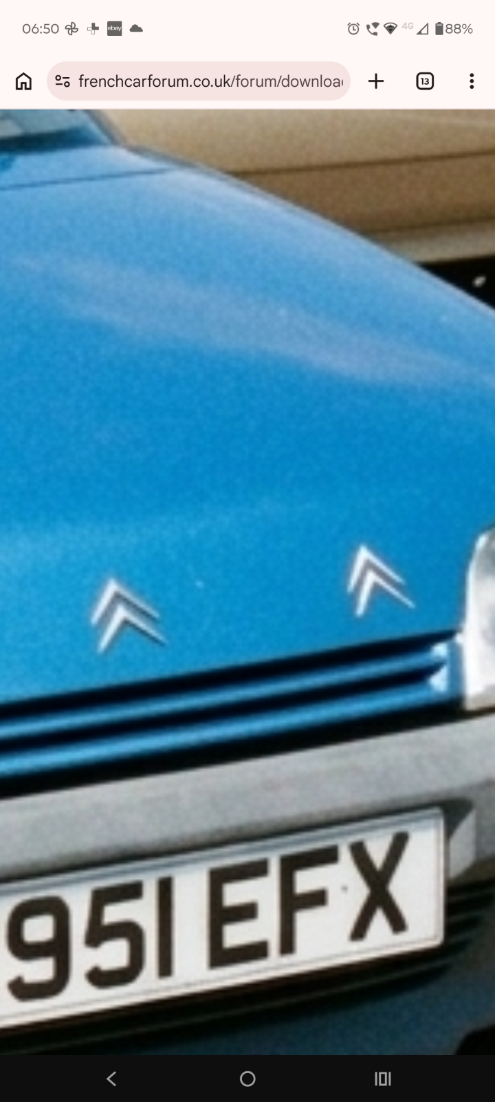

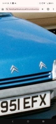

Err, did you clock the "quadruple chevrons" !?
Spoiler: show
picture zoomed in:
Double vision
Double vision

xantia_v6 wrote: 23 Jun 2026, 05:49 Interesting that on the second attempt it got the plate colour correct on the Xantia.
Yes, I noticed that Mike... Shocked it got it wrong first time :twisted:
MattBLancs wrote: 23 Jun 2026, 06:49 Err, did you clock the "quadruple chevrons" !?
That and also, Series 2 clear indicator lenses...
I do wonder if AI was 'aware' I also have a blue AX with the chevrons in the middle of the bonnet and used that knowledge... If it's that clever I've have though it would have read the number plate to get the colour right first time...
Worst of all perhaps is the appearance of a big building that does not actually exist in the car park :roll: :o :lol:

Ha ha, I completely missed the photo bombing building!
I guessed the double badges was "show AI ten million AX pictures" and it learns (MK1?) offset and (MK2?) central grille badge locations so gives you both at the same time!

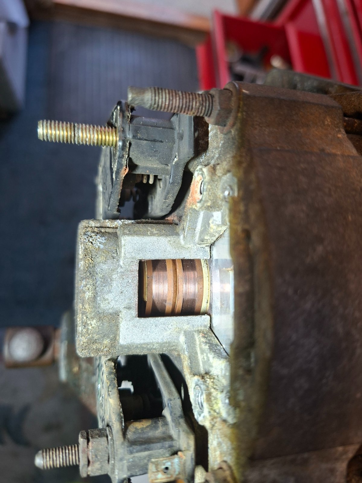

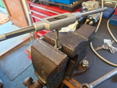

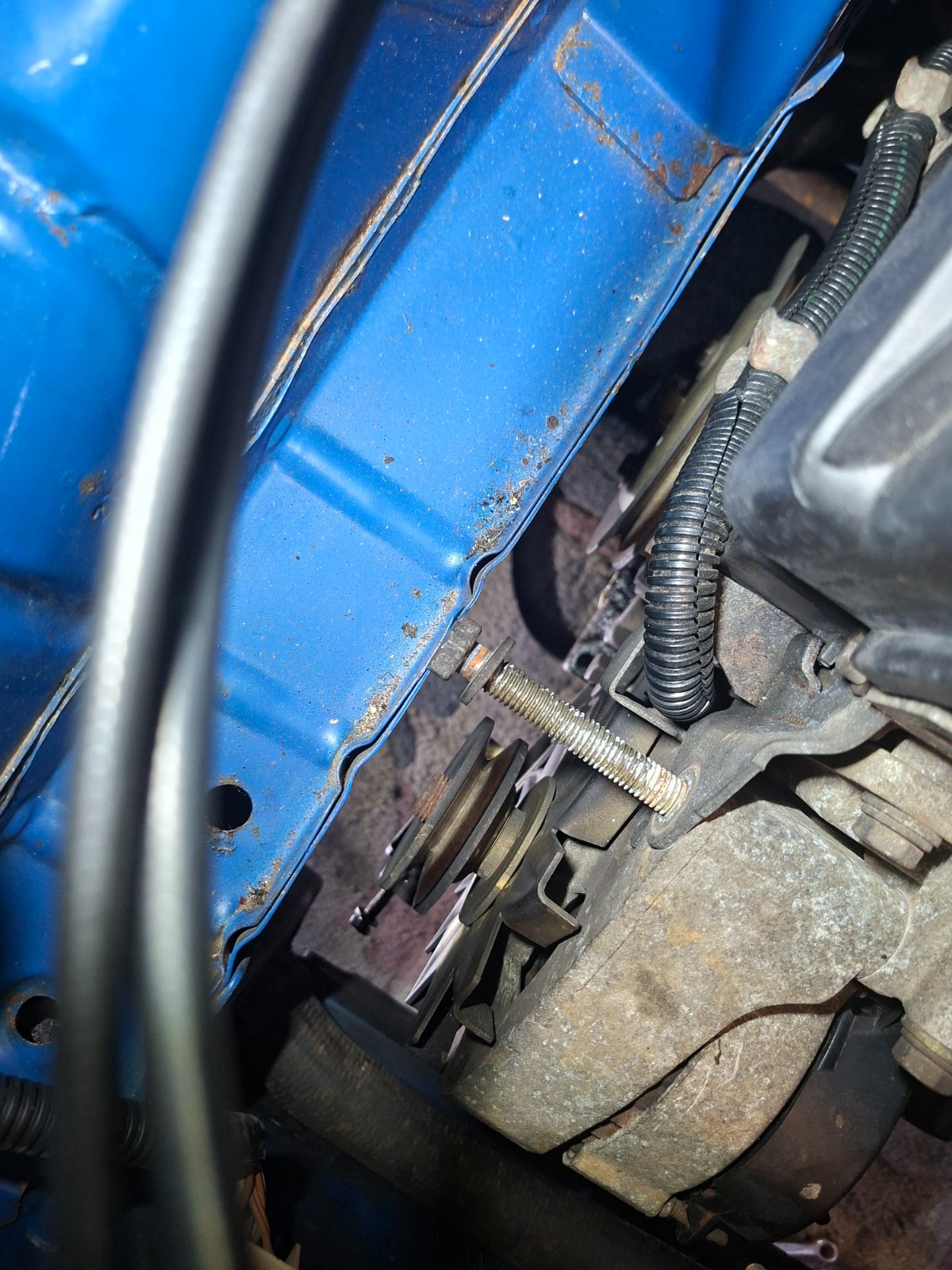

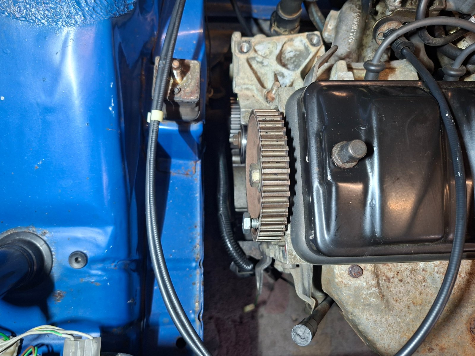

As my workshop/garage was about the coolest place yesterday, I got stuck into Bluebell's alternator..

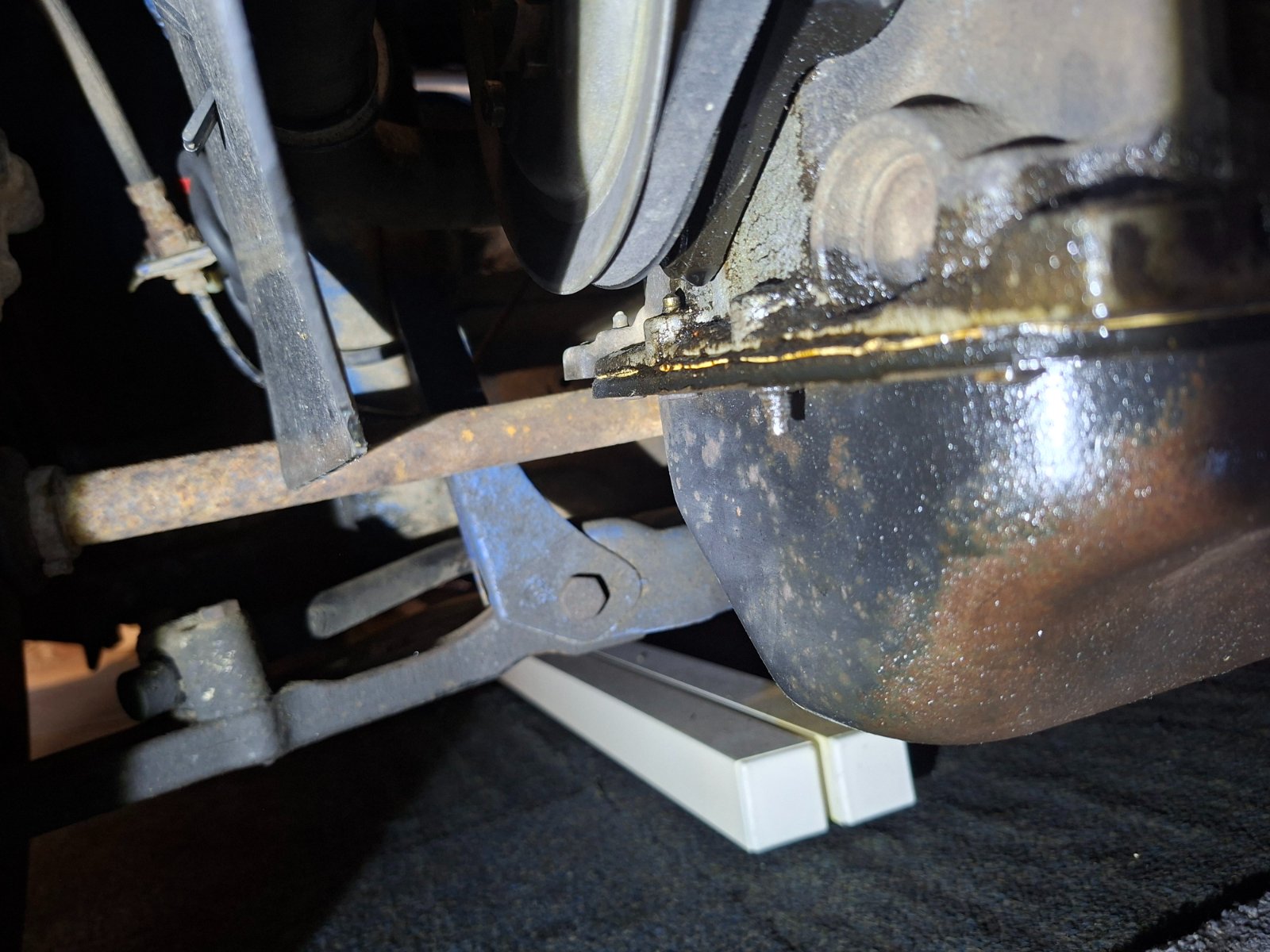

It's so annoying when what's normally a 10 minute job to remove the alternator is extended by several more minutes because the engine needs to be jacked up by slightly less than a gnat's cock to free the top bolt :twisted:
And you find a slightly burred nut and stud on the engine mount needing the attention of a tap and die...

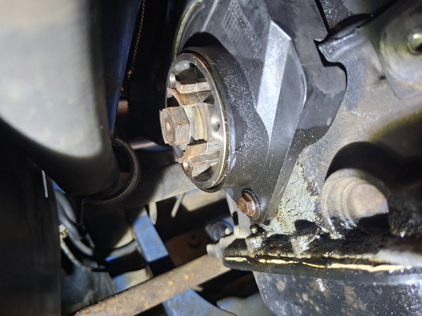

And it's observed that the timing side crank oil seal is leaking a little :twisted:

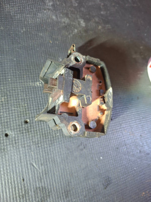

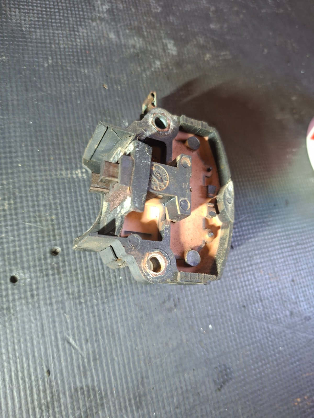

Once the alternator was off, I removed the regulator assembly after a short battle with two very tight slotted head screws...
The slip rings are in excellent condition :)
Not bad for what I'm certain is Bluebell's original alternator. I found it's covered in 1990 date codes.

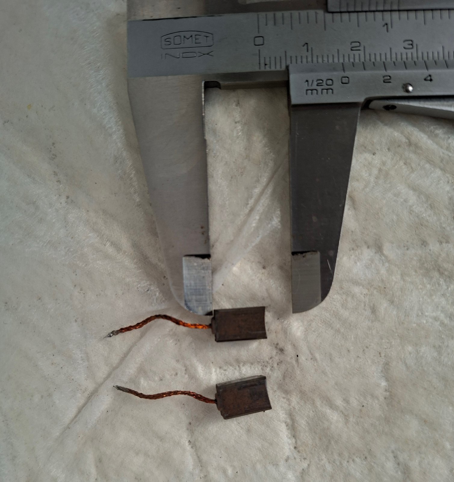

As expected, the brushes are worn out...
A new oil seal and a set of brushes are on order. The regulator has been prepared for their replacement and later today I'll start work on preparing the engine for the new oil seal. Happily, the cambelt is not contaminated so although it has to be removed to replace the seal, it can be reused...
I'll also do a coolant change whilst I'm at it...

That's proper toasty John! I've not measured the temperature my workshop although I happily spent more time in there yesterday working on Bluebell :)

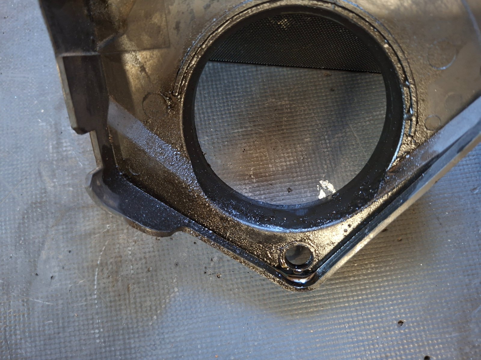

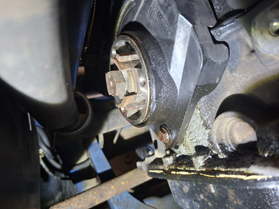

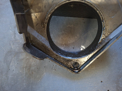

I pulled off the timing covers in preparation to remove the cambelt. Oil leak confirmed...
The cambelt is now off and all is nicely cleaned up ready ready for the new bits to be fitted...
