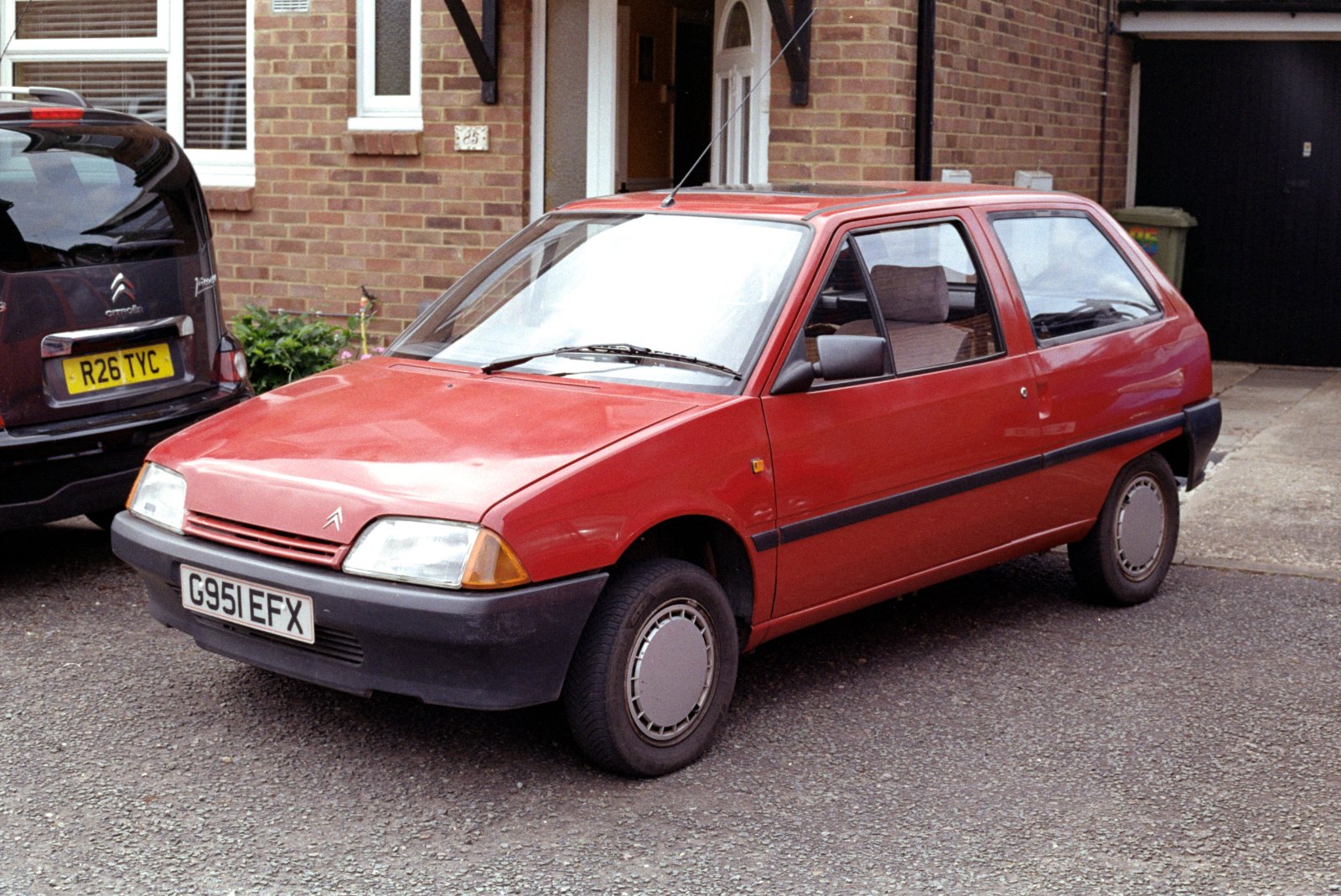

One problem I've been wresting with for ages is dusty negatives. Never such a problem with back and white as dust contamination shows up as bright white spots/curly lines and are quite unintrusive but with colour it is an order of magnitude a bigger problem. A tiny speck of dust or a tiny fibre looks huge when the negative is scanned and the result is enlarged. I could see the contaminates on my negs using a loupe and these could not be removed. they appeared to be embedded in the emulsion. Either my chemicals were contaminated, the film was bad - unlikely with Kodak's finest - or it was environmental.
It was the latter. I used to hang my negatives up to dry in my office doorway. The other day I noticed in a shaft of sunlight just how much airborne dust was flying around in the vicinity. The dust was landing on the film and sticking like the old proverbial to the wet emulsion. Nothing, not even iso-alcohol would shift it. The issue had grown worse as the weather warmed up.
The problem was bad enough that most of the photos of trains and show cars I've posted recently have needed a bit of retouching to remove the marks. A tedious job.
Yesterday, I ran the shower to lay any dust and hung the negatives up in the closed shower cubicle to dry.
Success! Here's a shot of Strawberry scanned from that film and with no retouching
I seemed to time the journey just right to avoid all the worst of peak-time traffic
I came home and rather than get stuck into Bluebell's alternator I processed a film I largely shot on Thursday when out with my girls. I got some absolutely awesome pictures

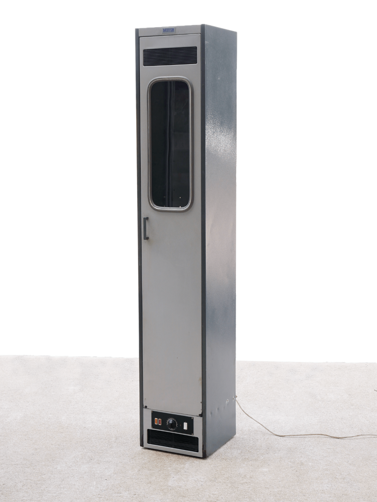

May be worth your while to install a drying cabinet Jim.
All the ones that I have used were fan assisted but the air was filtered and heated gently.
Except the latter years when the film went into the machine dry and came out dry too.

This is the kind of cabinet I mean. This is of course a professionally built one with heat, air circulation and filtration, a light and a viewing panel. All non-essential.*
Easy to construct one from 1x1" wood and plywood.
Or gut a grandfather clock
Do you have a pair of tongs to wipe the surface water off, makes a big difference in the drying time. Most just use two fingers of course, not always the best method.
*ours were always DIY, in one case a whole small room. The film was processed in tanks, 20 120 films, up to 30 135 films or 12 4x5" or 8 10x8" sheet films, mostly the latter, we rarely used 35mm other than for personal use. Similar when using a film processor like this one:-
was unable to find one but they used a 'paddle wheel' system, rotating back and forth in the various chemical baths, the 'bath' part would rotate through 90° and tip the chemical out, return to place and be filled with water or the next chemical in sequence, up to 60 10x8" sheet films at a time.
All appear to accept film at one end and spit it out finished at the other now.
