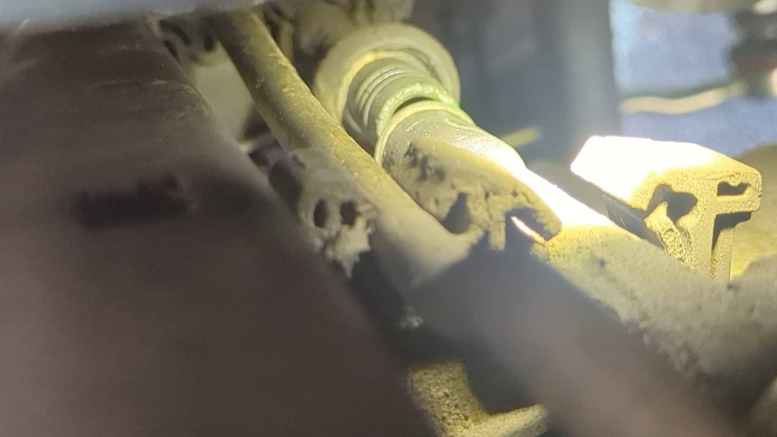

My 2009 C5 X7 has suffered a failed AC pipe. It's a two-part pipe from the compressor low pressure side, part numbers 6477E9 from the compressor and 647774 from the bulkhead (with the charge port). These both appear to push together and stay attached. Except mine blew apart one day, despite the AC not having been run for some weeks. The system had been working fine up until that.
Annoyingly both pipes run along the side of the engine, with barely room for fingers. I can't find any AC specialists in my area (only re-gassers) who might be able to repair this without replacing all the piping, if that's even an option.
I might attempt replacing the pipes myself, if only to get one or two more summers of working AC out of this car before disposing. I have manifold gauges and a vacuum pump, and have replaced the condenser some years before without issue. Both halves are available new aftermarket on ebay. I have three questions:
Do these pipes literally just push into each other by hand and something grips them together, or does one need crimping onto the other?
The system has been open for about a year (gulp!) - can I expect this to ever work again, or may the oil have absorbed too much moisture by now? I'm hoping that just leaving the vacuum pump on for a few hours might dry it out enough, but I have no idea.
Finally, some amount of oil would have been lost, at least the quantity resting in both replaced pipes. Is there any wisdom on how much I should replace, if any, or can the entire system be flushed out (by myself or someone actually competent) and refilled correctly?
I suppose a fourth question, has anyone else experienced these pipes blowing apart? I can find almost no reference to this happening anywhere.
Split two-part AC pipe, C5 X7

The connector is latched by a coil spring that is caught between the inner and outer tubes. They normally lock without difficulty, but unlatching them takes quite a knack.

Thanks for the replies. I'll give this a go myself, seems I can get both pipes for about £45 which makes it worth a gamble, if I really am supposed to just push one end into the other, the restricted space is still a concern. I'll give this a go shortly and report back how it went!

Just as quick update on this. I did replace the pipes, and managed it - just - without having to remove anything. The rear pipe can be carefully manipulated out and new one back in with only some swearing and lower arm bruising. The front was no problem, and once lined up, they do simply push and clip together. Removing the axillary belt would probably help but I think my tensioner has seized, so worked around it. I can see the circular spring (garter spring?) had snapped in mine, hence nothing to retain the one flange into the other. Vacuumed for hours and hours and held vacuum well. I can't recommend the cheap 'MAXGEAR' brand pipes I bought though. Not close enough to the original dimensions, so still needs some bending. The service valve is nowhere close to where it should be.
