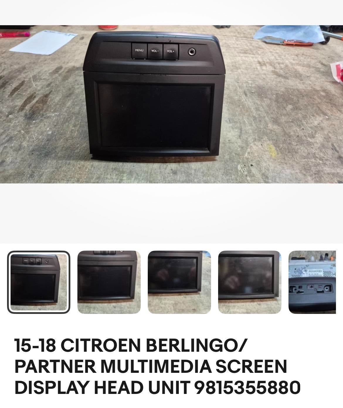

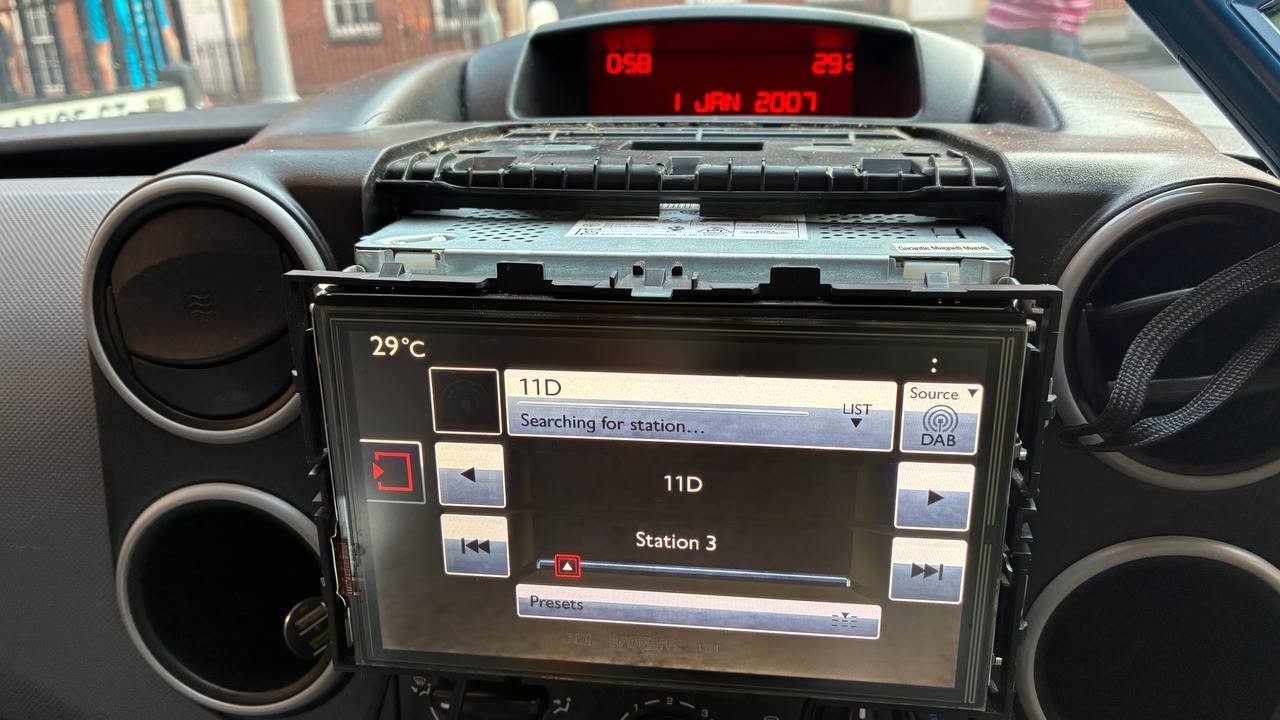

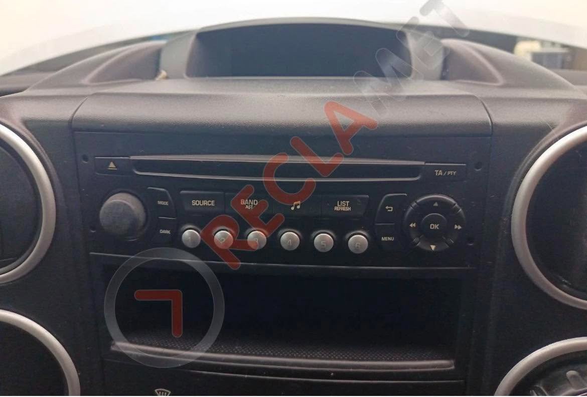

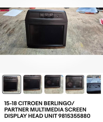

Hi everyone, I finally managed to change the VIN using Diagbox 7.40 once I swapped the Radio on my VanPeugeot Partner, Stereo Rd45 to Smeg +Iv2
The previous Radio did not have Bluetooth
I have a couple of questions, can you help me please?
1) Microphone
I found the microphone connector next to the courtesy light, so I bought a Peugeot microphone and plugged it in, but it doesn’t work.
Does anyone know the wiring path for the microphone cable?
Is it supposed to run all the way back to the stereo?
Does anyone have a wiring diagram?
Is the microphone supposed to communicate over CAN, or should the MIC+ / MIC? wires connect directly to the SMEG+ IV2?
