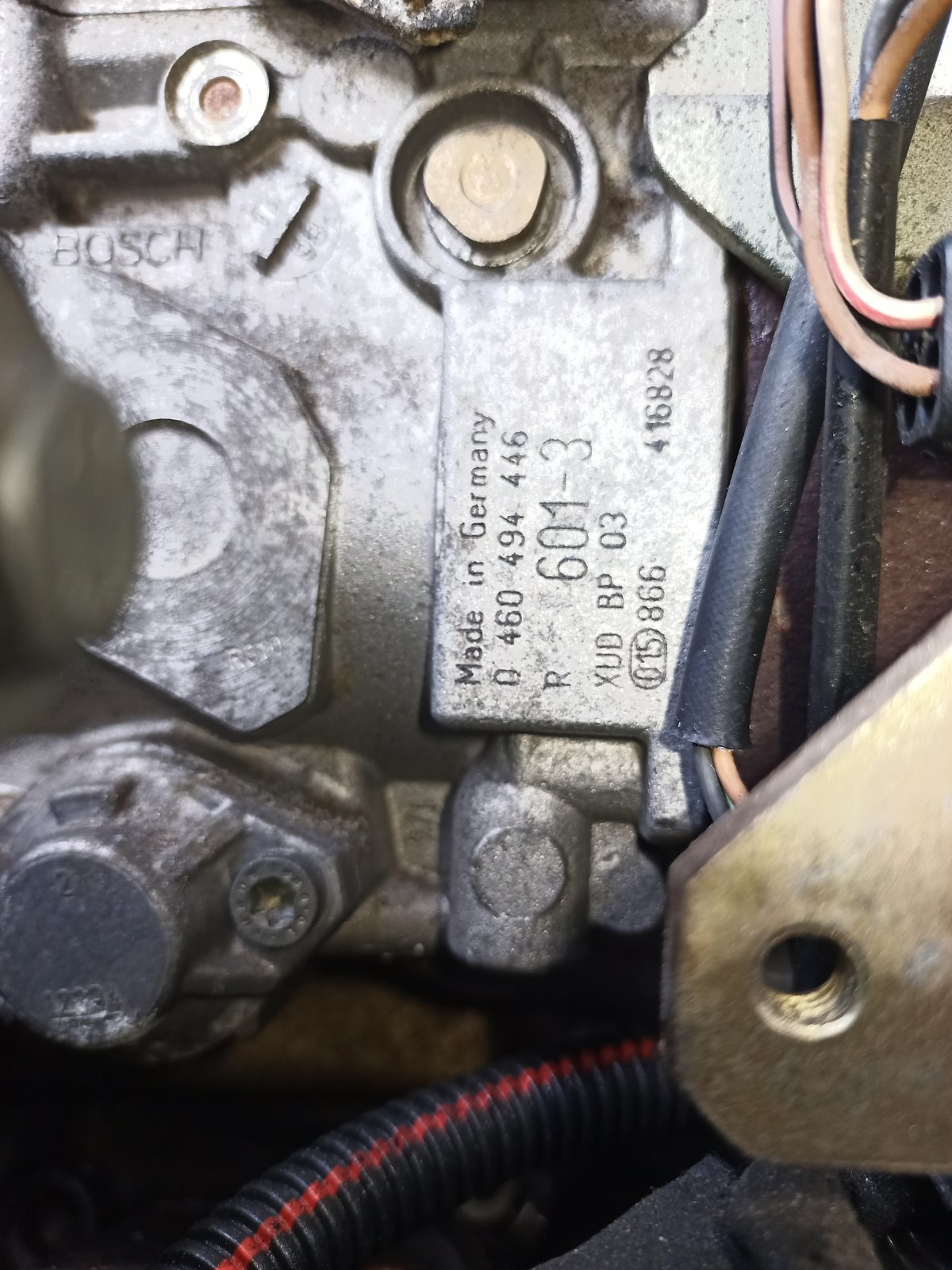

I have been having an issue since I acquired my car a couple of week ago. reluctant and sluggish starting. 1.9 TD 1998
I took it to Chevronics a Citroen specialist, they replaced the glow plugs and repaired the battery terminal . checked the heater circuit, found a couple of air leaks in the pipe system, finally they feel that there is an air leak associated with the High Pressure Fuel pump.
they are suggesting a rebuild which will be expensive ,
the number on my pump is Bosch 0460 494 446 , it seems that the last 3 digits are the important number , but I don’t know in what way,
Can i install a different unit if it is for a xantia such as a 406?

The last three digits, 446, define the fuel delivery specifications and timing for your 1.9 TD engine. You cannot directly install other models of Bosch Xantia/Peugeot 406 fuel pumps because their suffixes are different. An incompatible fuel pump will cause starting difficulties and performance degradation.
Solution: Use a used fuel pump with the same suffix, 446 (cheaper than refurbishment), or refurbish your existing fuel pump.
