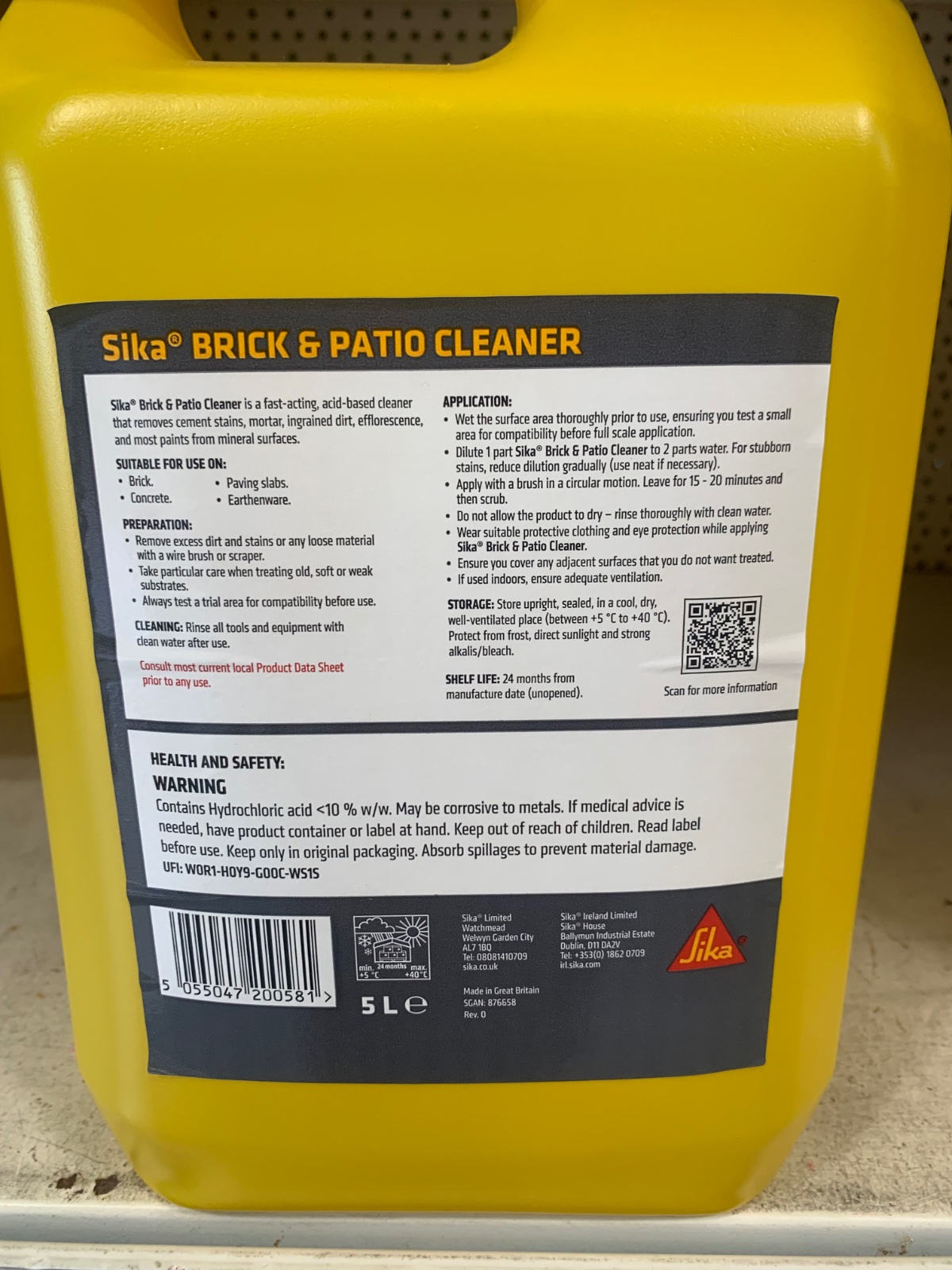

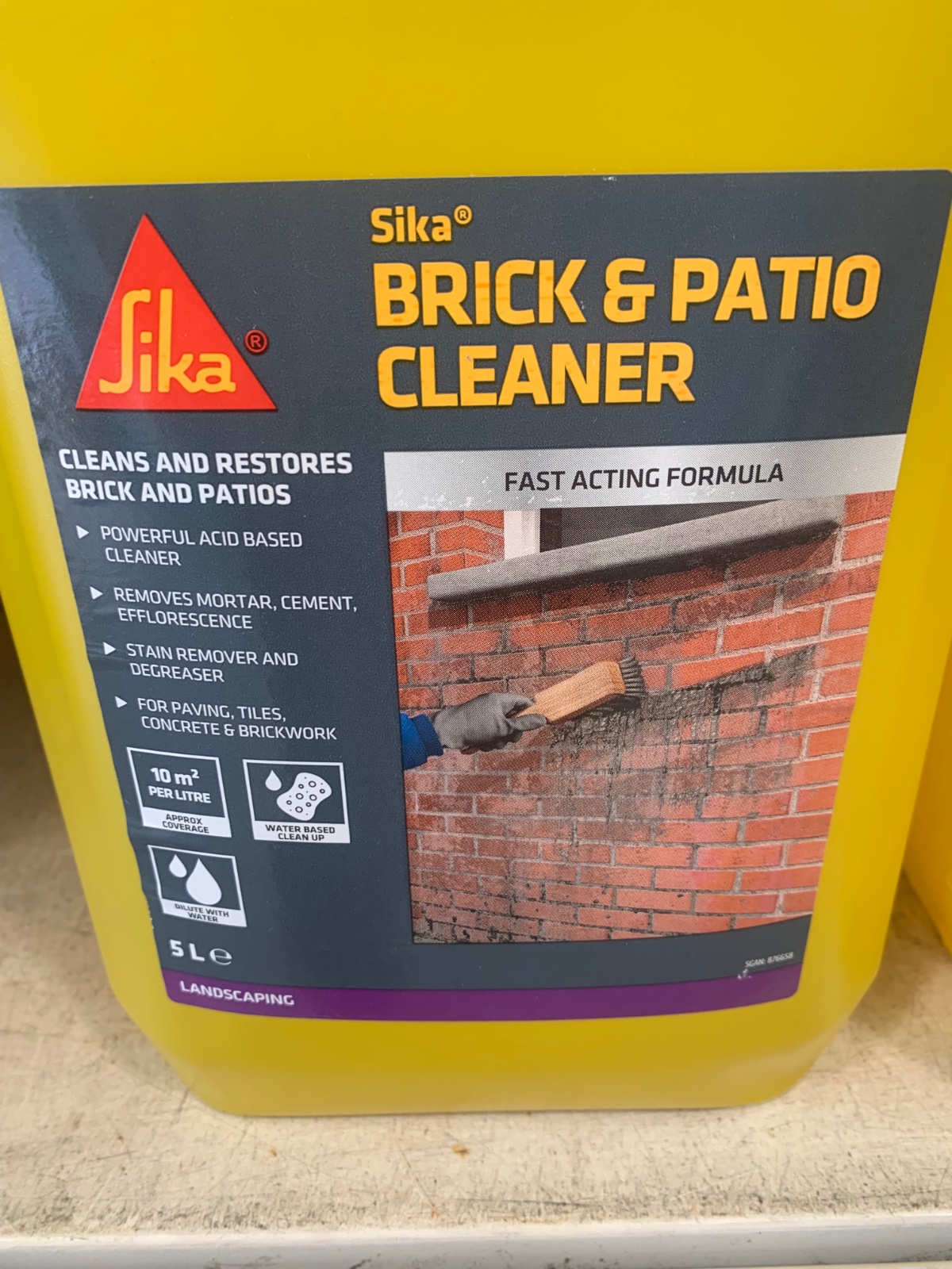

Can I post some cautions here. Firstly you need to be aware of how concentrated (not strong) the acid is. The Sika product claims that it's up to 10% but I have some hydrochloric acid here (bought as such, no alternative names) in France and it claims to be 23%. Further about the concentration, watch this video and then see if you would put acid that hasn't been further diluted in your DPF. In the first video there's a bit at the beginning where a label shows that the pool acid (another name) he uses is 32% concentrated.
Posts: 21057
x 8085
Re: Dpf clean
For further clarity this is the actual product which I have used very successfully straight from the bottle. I cannot stress the importance of the post soak rinsing though!! :) https://everydiy.uk/p/wickes.co.uk/1537 ... cleaner-5l

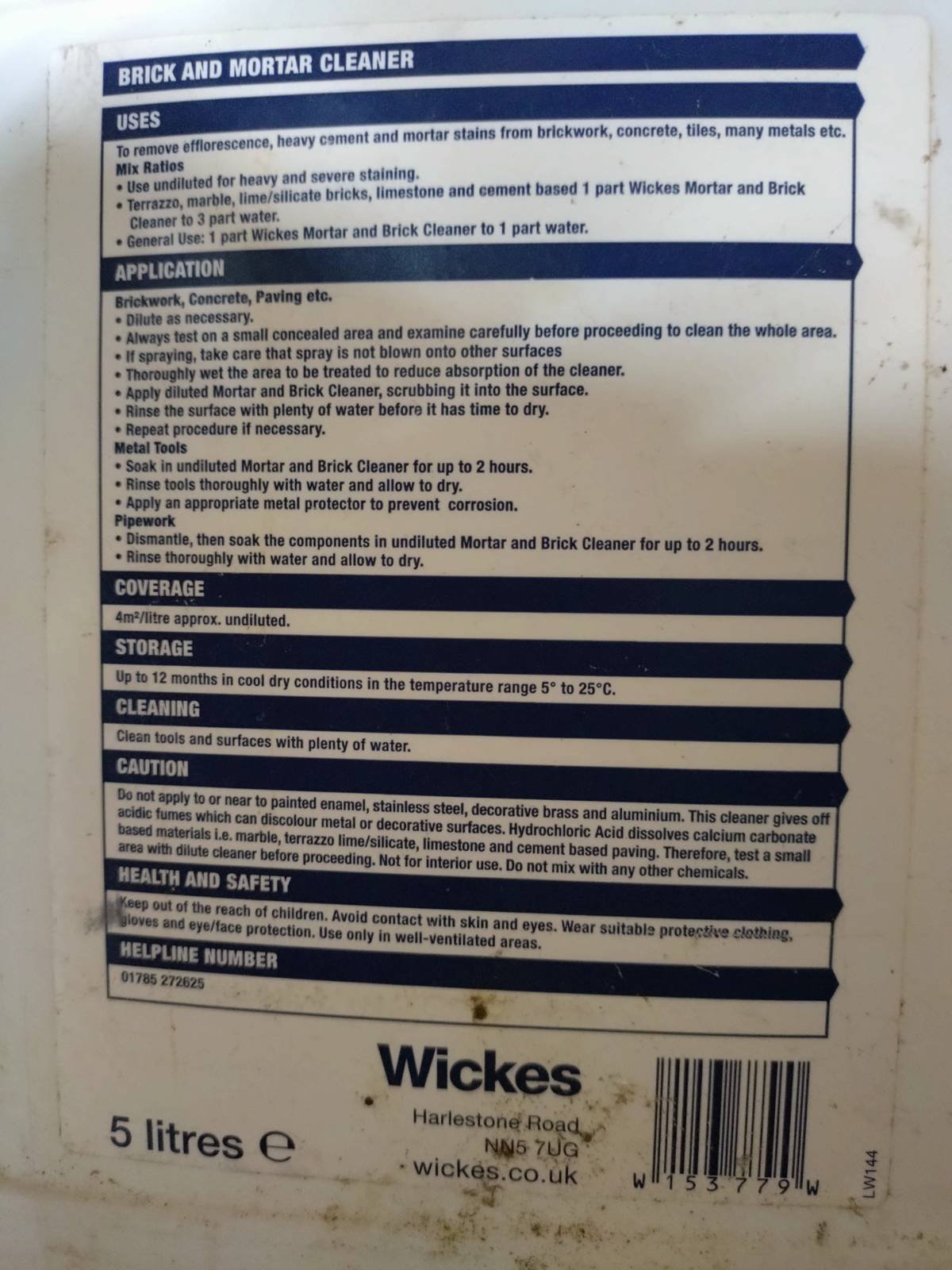

Mick, the photo doesn't say how concentrated the acid is and there's no link to a specification sheet. Does the back of the container have a label which gives the concentration?

This is the label on the back of my current bottle which does not specify strength:
Wickes brick acid
Wickes brick acid
However this link does show the concentration to be less than 10% diluted HCl and as I say has worked faultlessly on my 4 uses. :)
https://media.wickes.co.uk/is/content/w ... 821_TECH_0

I phoned the helpline number on the Wickes product label and was surprised when the welcome message announced that I had actually phoned Bostik. Anyway, I explained what I was looking for and they came back with the information that the Wickes acid cleaner was a product that they no longer made but, when they did, was 9.8% concentration.
Using the figure of 32% that the video says was undiluted, making a mix of 3 parts water to 1 of concentrate would give an equivalent of 8% concentration. This would line up with his assertion of using a concentration of 5% to 7%. Not a huge difference and undoubtedly the reason there was no untoward result with the 9.8% acid.
But it does reinforce how important it is to compare like with like and be aware of exactly what something is.
