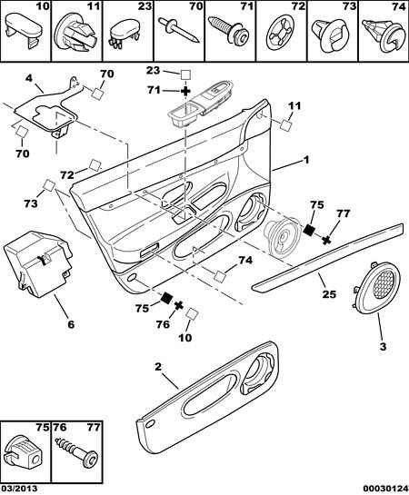

A screw in the little hand hole, covered with a plastic button it holds the switches in also

I thank you for the quick response but it is like all the rest. It only applies to the front doors, not the rear.

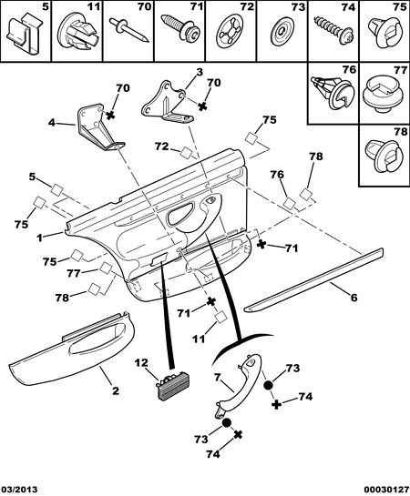

Rear door
I should have read your post properly ! Hope this helps. When all screws and clips off it should just lift off.
