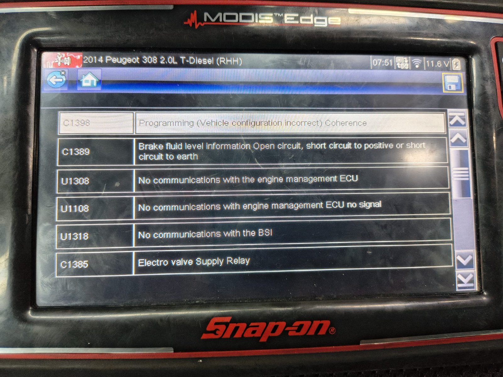

Scanned the system and following codes appeared:
Code: Select all
C1385
C1381
U1309
U1308
U1108
U1318
So I checked all wiring to see if anything is broken but couldn't see a problem.
Brakes worked but the sign came back after few minutes after I deleted it.
So went to my mechanic and asked him to replace the ABS pump ( I thought could be legit issue with pump )
Now the pump has been replaced, I have no brakes and ABS /ESP lights on and following codes:
FaultCode_308_ABS_ESP
I am not sure if this won't work until its programmed?
Any help will be greatly appreciated

We had a 2008 C4 that needed a new abs pump and that had to be programmed to the car.
When it has been replaced the brakes need bleeding using a diagnostic to get the air out of the pump since just pumping the pedal or pressure/vacuum bleeding is not good enough.
Check voltage of the battery since if low it could give false ESP warnings. Before the first start of the day if fully charged it should be about 12.7 volts but if below around 12.5 volts it needs charging up.

Mechanic number 2 - I know him, he replaced timing chain on my other car and he gets stuff done. He got the Auto Elec to check the codes and said yeah definitely pump.
I actually found a video that had similar issue. I am not sue if the model that I have has a separate ElectroValve relay i.e C1385 code. I might go check if the relay is faulty.

PaulC5 wrote: 21 May 2026, 13:42 We had a 2008 C4 that needed a new abs pump and that had to be programmed to the car.
Hi mate,
thank you for your reply.
Do you know what errors did you get when you had to replace the pump?
I understand it needs programming and yes I can run the ABS pump bleed with my diagnostic tool (Xtools D7s)
thank you!
