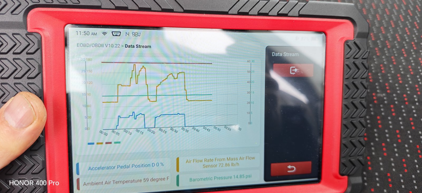

But what I've noticed is that even with maf unplugged, I still get a reading on the diagnostic tool for it.
The following picture is with both of them off.
It has a blanking plate over egr that was on the old engine so I obviously moved it to the new engine.
Before my missus kicks me out cause of throwing so much money at this and still can't enjoy it and begin the actual conversion, does anyone has any ideas what I could do or try?
I just can't figure it out how it can still give a reading of maf with plug out? Is there any chance I could've mixed it with some other plug, or they fool proof?

But this is what I've got at the minute and I'm trying to figure it out what's happening.
I did thought about removing plate, but because I guess the ecu is coded without it, I don't want to mess it worse.
As long as was running fine before with this map and plate, It seemed a good ideea not to interfere for now.
Probably that's what I'll try next if no ideas or help found.

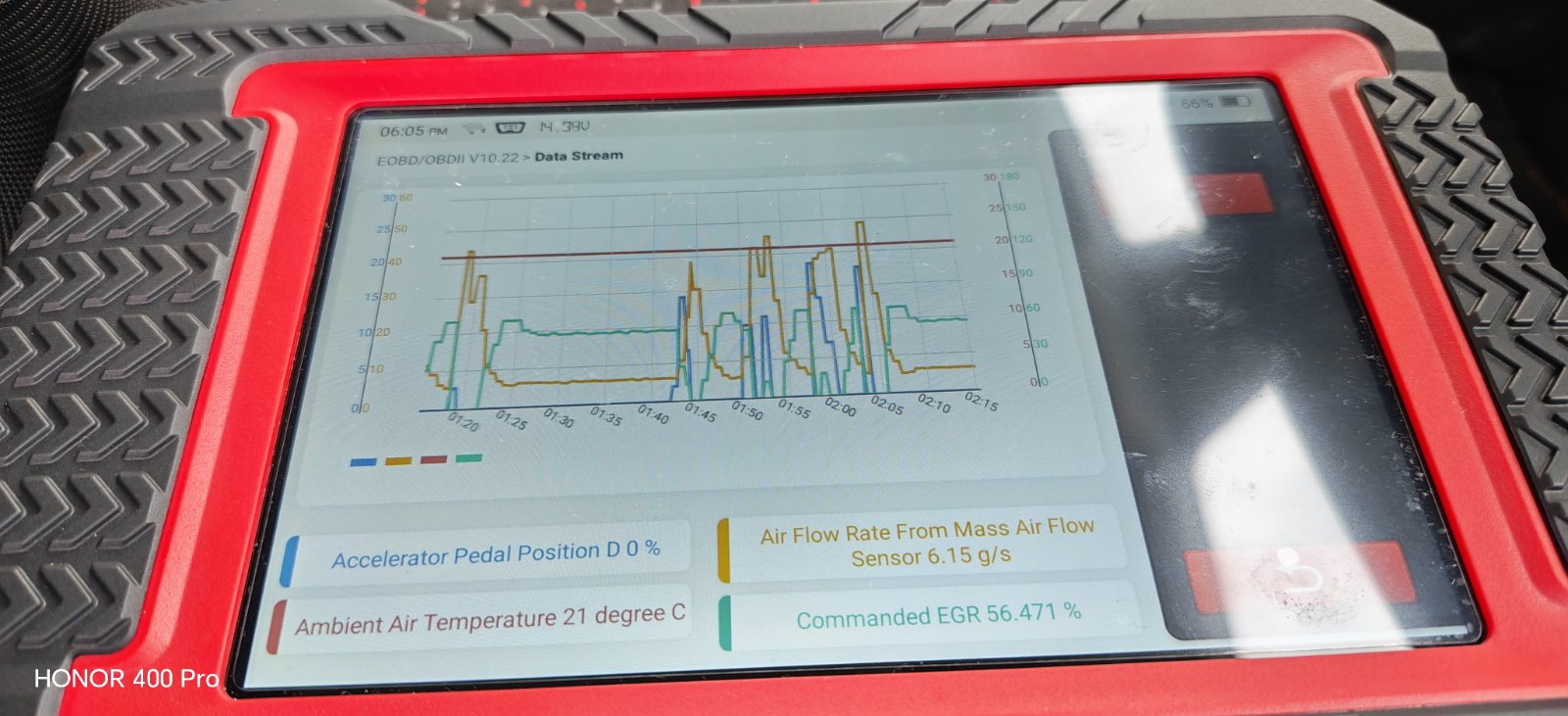

Re: Peugeot boxer 2.0 2018
Took the plate of egr yesterday and even less diesel knock and even less black smoke, and that's only when letting throttle go.
Does it needs a remap I'm thinking?
