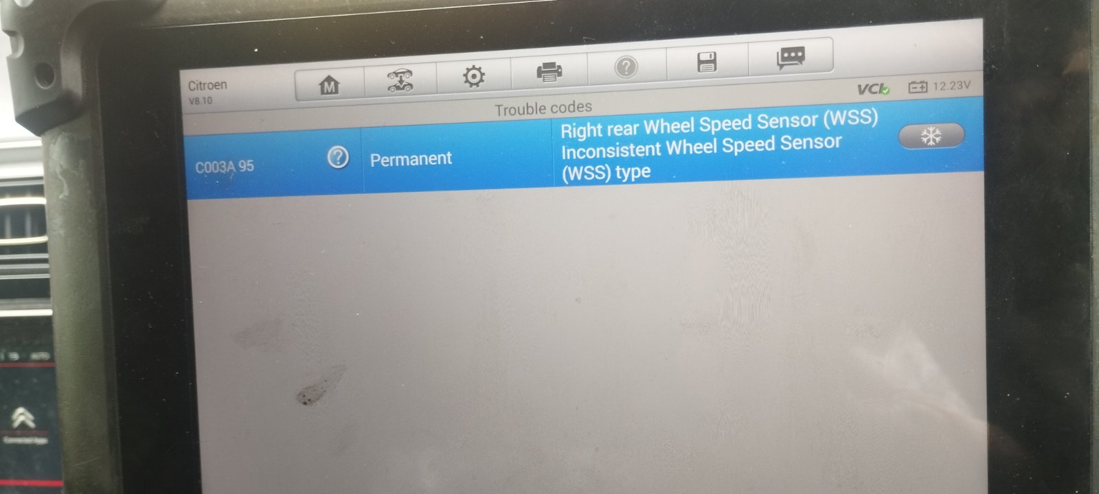

Hi All, I have a problem with my Citroen C3 Puretech 2018 1.2 petrol.
The ABS light is on my dashboard and the diagnostic shows error C003 95 - right rear wheel ABS sensor (see photo attached). Initially, I have tried to fix the car myself and did the following, but I didn't manage to solve the issue:
- replaced the right rear speed sensor;
- replaced the right rear wheel hub (including wheel bearing and disc)
- checked the cables going from the abs module to speed sensors
I then brought the car to 2 different mechanics and they haven't been able to fix the issue and told me that the issue was caused by the ABS module.
The first one told me that he couldn't fix the issue and that I needed to bring the car to a citroen specialist garage.
The second one said he could send the car to be fixed, but it would take 2 weeks and that it would cost me £900!!
Can somebody please confirm if a faulty ABS module can trigger speed sensors error code?
I found some companies online that offer ABS module repair. I was thinking I could disassemble the ABS module and send it to one of these companies for repair.
However, before I do that I wanted to make sure the problem is definitely with the ABS module.
So, I was hoping to get some guidance and help to resolve the issue myself from this forum to avoid paying a hefty bill.
Many thanks in advance.
Jack

Was the new wheel sensor a copy part or from Citroen ?

Re: ABS CONTROL MODULE
Hi, it was Ate as the original that was installed on the car.
Thanks.
Jack
Before starting disassembly, the sensor and cables must be checked.
Since both rear sensors are the same I would try to swap them between . If both sensors are good then I would check the cables.
I don't have a diagram for that car, but the cables from the sensor go to the ABS/ESP control unit. The connector on the control unit must be inspected for rust and bad contacts, and then the cable for the corresponding sensor must be measured. Connect a multimeter to both ends and check if the ohmic resistance in the cable is 0 ohm.There is an ABS ring on the rear disk, which is made of rubber-plastic and inside there is a magnet. That ring must be intact.
Hi All,
just a quick update about my issue. Ultimately, it was the right rear speed sensor that was causing the problem.
I took the car to a third mechanic who has been able to diagnose the issue quickly.
He mentioned that the connector to the right rear speed sensor had the pins a bit loose and it wasn't making a secure connection with the speed sensor.
To cure the issue, he tightened the connector pins and installed a new speed sensor.
Thanks All for your support.
