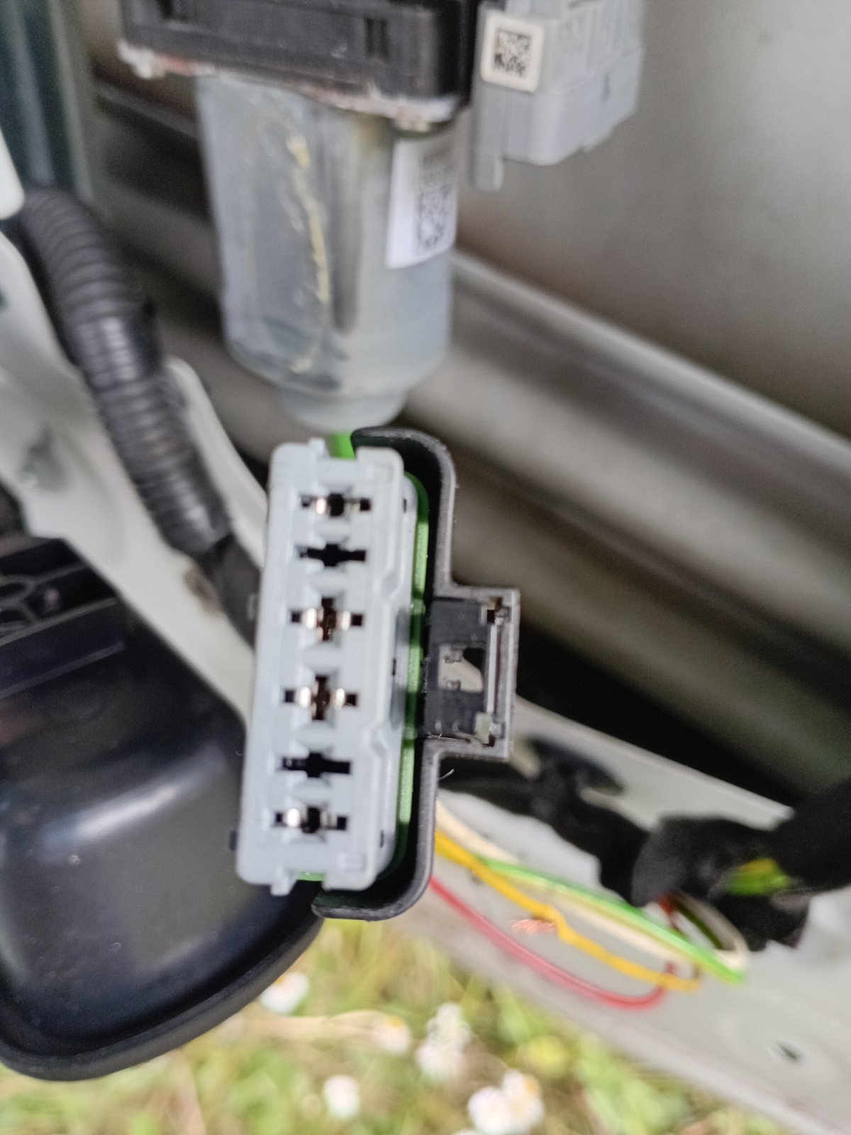

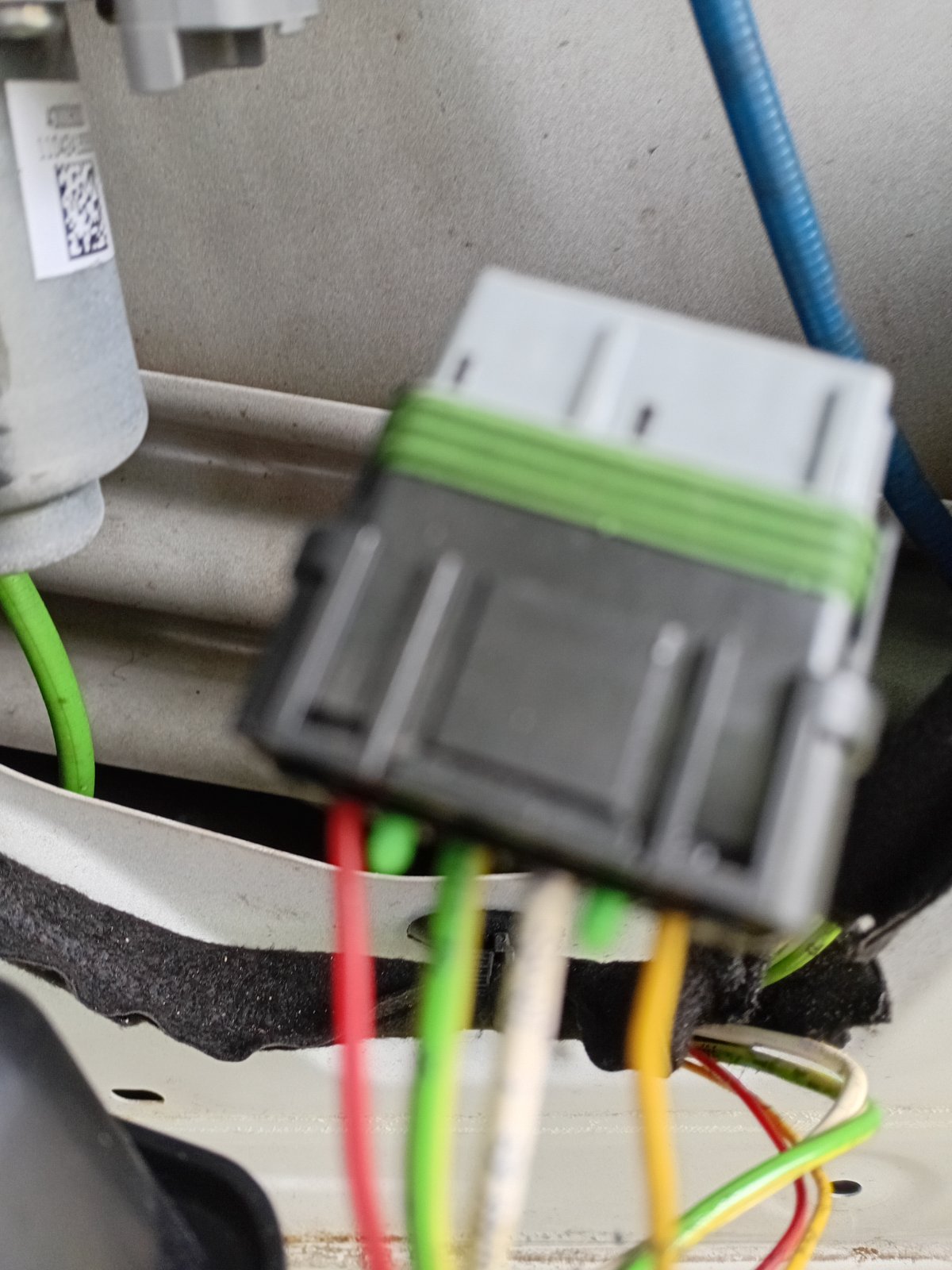

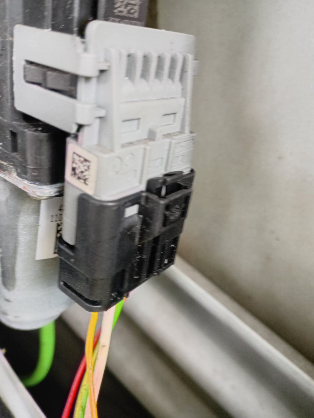

Just a update. decided to remove motor from the regulator. & the window was able to be pushed down, done BSI reset no Change.
But decided to loosen door nuts and Put door on a firm base under it. this was a large square water container
The top nut was replaced with a 100mm bolt this kept the door steady but a good 3" away from the car so now i can get to the plugs in the door jam.
You would never believe it, there were Broken wires. I am now testing all wires for continuity will let you know the results later

I wouldn't call broken wires in the door hinge a common thing but it certainly isn't rare either. Well done so far and good luck repairing them
