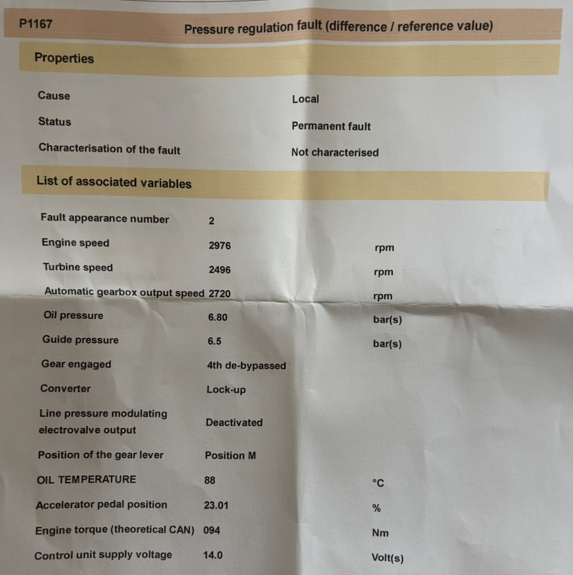

haf_12
- Posts: 6
- Joined: 06 May 2026, 16:24
Re: AL4 Gearbox advice
Thanks for the feedback and I paid £50 to have the Lexia diags done and I have attached the report - clearly pointing to the solenoids. The other error code was a fault in the brake switch but that was an easy & cheap swap so got from ebay and did it myself. I have to do a 20 mile motorway trip 3 times a week and thats the majority of times when it happens i.e a thud and a switch into 3rd gear - though the thud has got milder since the partial oil change and the frequency has reduced a fraction. At the moment I will just carry on as usual and monitor to see if it gets more frequent and if I start to see it when not on the motorway. Clearly it's not sustainable long term. The main reason I took it to him was that a few other folks said the gearbox oil counter will have to be reset after changing the oil in order to see any benefit hence the Lexia diags but it turns out that the counter can only be reset after it reaches 3000 and mine was at 900 due to the cars low milage even though its a 2007 model.
The garage guy was very familiar with the fault and said they used to do lots of them a decade ago and it was £7-800 inc. the gearbox 're-adaptation' and various resets via the drag s/w. At that time the garage took out the solonoid 'block' and sent it to someone who did the swap - unfortunately he has long since retired so they stopped doing the work. He even said if I could find someone to do the swap, he would do the drag resets. Have posted on Facebook etc in the hope of someone willing to do it as my local mechanic said he may look to take of the block but fiddling about with solenoid and pressures wasn't something he wanted to do either.

"Valve block" is typically known as the valve body.
Requested pressure 6.5 BAR actual pressure, 6.8 BAR. That's what it probably didn't like. Although, that's not a massive deviation. So not so sure about that!
4th gear, manual mode and 3000RPM...interesting. No speed on the readout. Mine typically failed at a "cruise" speed. Looks like that here too.
These problems can some times be caused by the pressure sensor not reading the pressure correctly. But I don't think that's the case here.
Changing the modulator valves on the valve body only requires one bolt (per solenoid).
There is no adjustment required to the pressure regulators in the valve body. At least I haven't come across that problem. Adjusting the pressure regulators requires specialized equipment and is not something to be taken lightly.
The hardest part is re-aligning the selector quadrant, the gear selector in the cabin and the position switch. A bit of mucking around but not impossible.
Auto adaptives and the oil counter do virtually nothing IMHO! I have "fiddled" with both and can feel no discernable difference to the performance of the gearbox!
Thanks for the extra info and explaining things a bit more. That is definitely a job for someone who knows what they are doing to some degree and has the right tools - the video of the guy stripping down the complete front of the car before he even got to the gearbox was enough to tell me there is scope for all sorts of things to go wrong on the way and there are various posts of folks having trouble with the pressures you mention.ozvtr wrote: 11 May 2026, 02:24 "Valve block" is typically known as the valve body.
