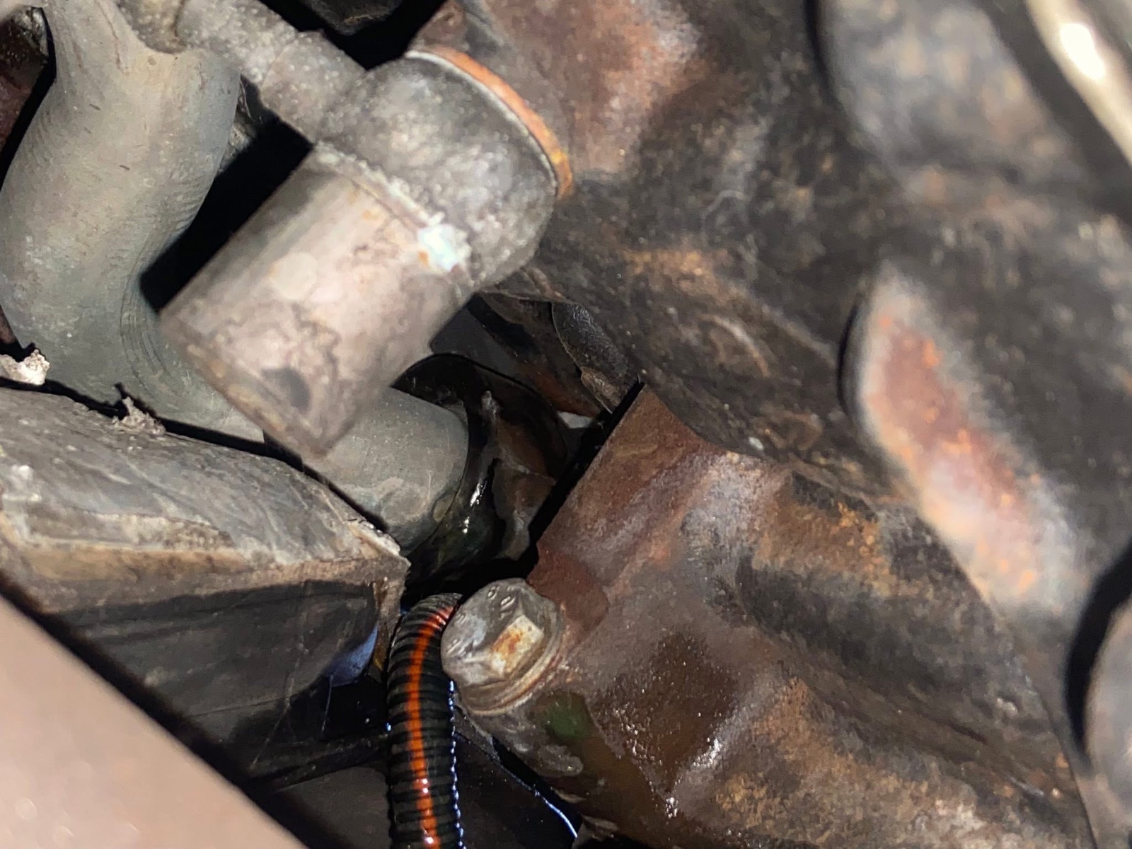

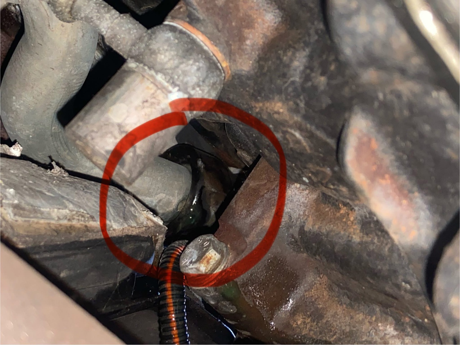

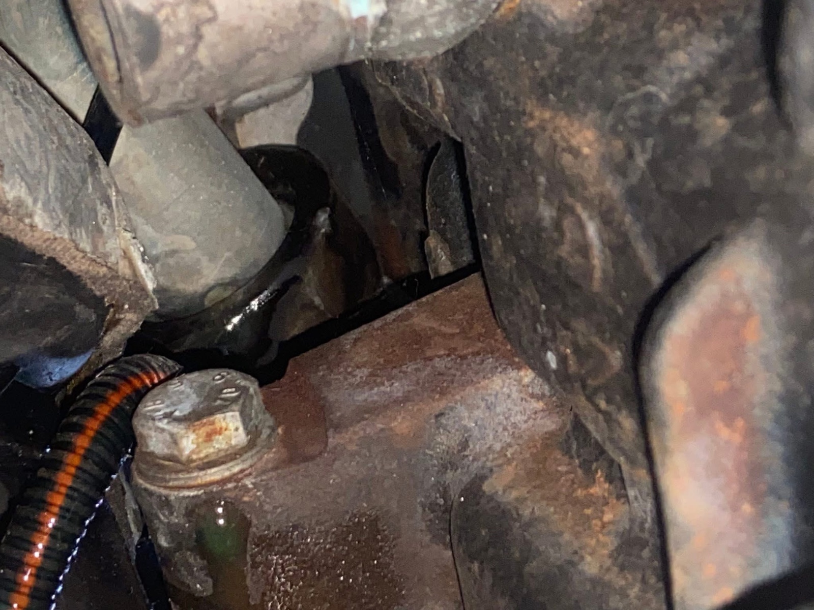

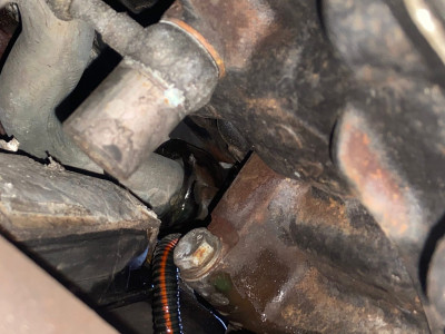

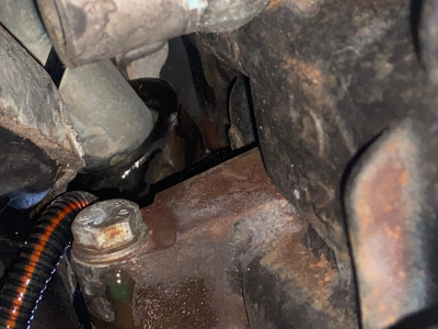

Hi all, my trusty 406 (HDi 90) has had a coolant leak for several years now. I love the car and it's taken me and my family everywhere, so I want to get this addressed.
I've identified the source of the leak at the thermostat housing. The housing itself looks fine (from the angle I've looked at) and the leak seems to be coming from where a pipe goes into the housing (possibly just push fit?)
You can buy the housing, but I thought I'd ask here to see if others have had the same issue and if so, what they did to fix it.

Difficult to tell from the pics but if that is a metal pipe going into a housing then it probably has an O ring around it which has perished. If the housing and pipe are in good condition you may just need to replace the O ring. :)

mickthemaverick wrote: 05 May 2026, 16:16 Difficult to tell from the pics but if that is a metal pipe going into a housing then it probably has an O ring around it which has perished. If the housing and pipe are in good condition you may just need to replace the O ring. :)
So sorry I didn't see this reply..!
It is a metal pipe and I agree it's not a great photograph. I've had other looks around there and the leak definitely animates from the junction of the housing and pipe. I now need to source an O-ring, I'll ring Peugeot as I don't have PP2000 anymore.
It happens in cold weather much more often, in the Summer I might get away with topping up every month, so possibly swelling rubber?
