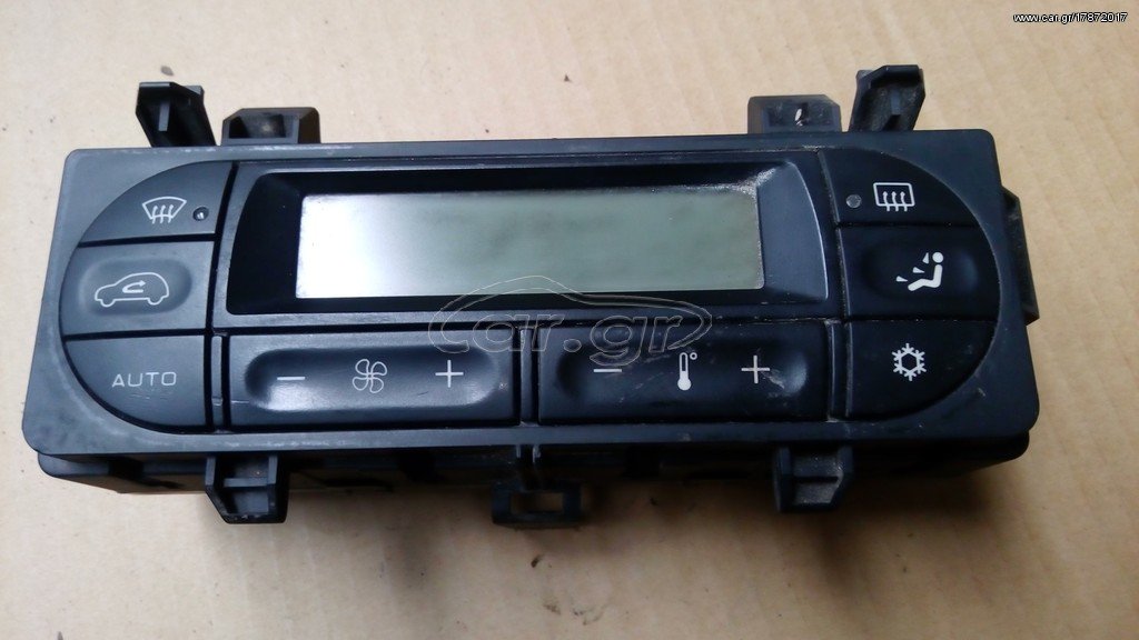

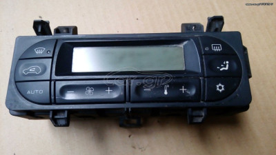

Also yes I have auto air conditioning but for 1 year now the cold doesn't work as good as it used to. In the first years of the car when you opened the cold the car was going ice, now it doesn't do it that good but maybe that is another problem and not the temperature problem.

The air con not getting cold could be it needs to be regassed with refrigerant.

The a/c opens normally (pushes air) it just doesn't work as good as it used to in the cold setting.

Problem 2 the air con is not blowing as cold as it used to. In good order with enough refrigerant it should be able to drop the temperature by 10 to 15°C through the central air vents. It probably just needs regassing.

My main problem isn't that the a/c doesn't work as good as it used to, I just said that incase it has something to do with the broken car fan.
Now I understand that the a/c is a separate problem and I don't really care about that.

I might be wrong about the number of temp lights but it jumps from the 3 light (yellow) to the top (red) without passing through the orange first.
Let's say it is in the third light and all of the sudden in a red light it goes to the top and the car fan opens at full speed for 2 minutes, then the temperature goes back to 3, fan turns off and everything is normal again.
Again yes I have auto a/c, I sent how my a/c controller looks in the picture for reference.
A/C controller reference
ozvtr
Posts: 892
Joined: 13 Oct 2020, 01:11
x 248
Re: Citroen C3 2002 1.4 petrol overheating (or not?)
Unread post by ozvtr »
kyrpousin wrote: 04 May 2026, 05:12 Yes, I have auto a/c
Ok, in that case I'm now very suspicious of the radiator fan.
As I said, the fan has a built-in electronic controller that will vary the fan speed from off to full speed. The built-in controller also provides feed back to the engine ECU about the status of the fan. A fault in the fan will cause all the temp lights to come on and issue three warning beeps. Just like a sensor failure.
Only the cars with auto A/C have this type of radiator fan! Which is why I needed to know.
Again, the electronics in these things tend to be intermittent, and so tend to work sometime and then not others. Which is why it passed the test earlier.
But more importantly, it also answers the question as to why the engine boiled over.
To confirm this, the next time all the lights come on, and you hear the three beeps, pull over BUT DO NOT STOP THE ENGINE, open the bonnet and see if the fan is running.
WITH ALL THE TEMP LIGHTS ON THE FAN MUST BE RUNNING (under any circumstance)!!! If not, that's a failure of the fan!
Even with a failure of the green or blue sensors, the fan should still come on!
If the fan is not working with the car at low speeds (or stopped), the engine will boil over! If you manage to keep the car moving, that will cool the radiator, and you have less of a chance of the engine boiling over.
