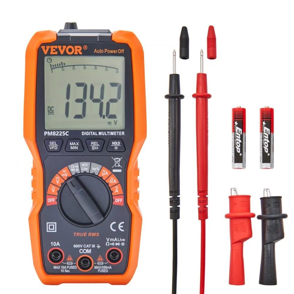

As it says on the sketch, HIGHEST setting which is likely to be 10A unless you have a more expensive meter but the most Amps you have.. :)
Posts: 28757
x 5678
Re: Battery being drained
Note that most multimeters have a separate socked for the 10A input.
