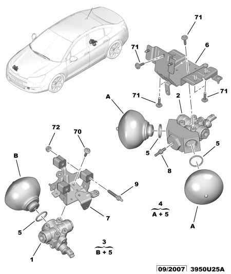

More problems. I have new suspension spheres, have fitted the two outer front ones but can't find the centre one. I have read information that says its behind the wing liner, some say the left side, others the right. I thought I had seen it projecting through the liner one side but can't find it now. Its a 2.0. hdi. Am I loosing my marbles?

Low, front right

Thanks Alistair. Mine doesn't look like that if the two labelled 'A' are the outer spheres. Its a tourer, does that make any difference?

Ah I think they are the rear centres. I will check tomorrow.

Yes, the twin block is rear....look at the car image, you can see the placement on that....

If it's not a 3.0L then you find him behind the front left wheel and the 3.0l you find him behind the right front wheel behind the mud protector in the front fender.

I see now, that it is a 2.0, then he's at the left side. To replace him, remove the left drives haft and the m6 bolt under the subframe withs hold the ac tube and hammer with a long chisel the sphere loose.

Thanks everybody. I found it today, its slightly left of the centre of the engine, between that and the subframe, how you get to it I don't know, I will take the wheel off and have a closer look. Looks like a terrible job, probably why the car was so cheap!
