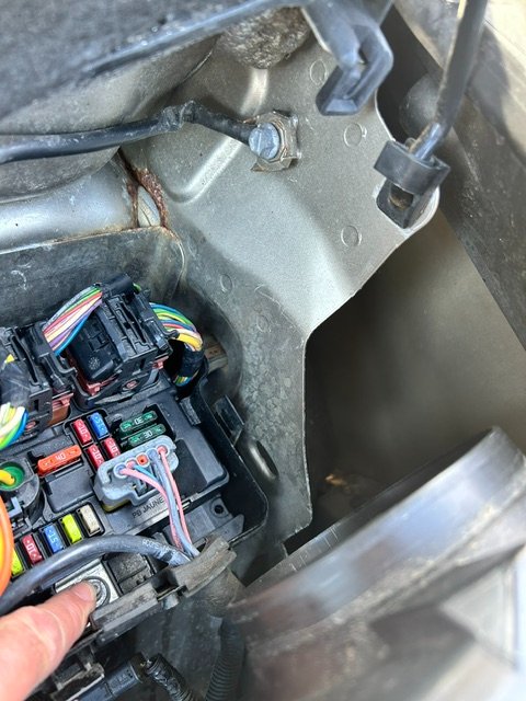

Hi, yes all deleted, but the APC+ remains as does the ABS. Just been working on it, earths all look in good condition. Measured the battery voltage between earth and the BSM bolt, I assumed this bolt was an earth connection for the BSM. I see the battery voltage here, is it an earth on the BSM?
