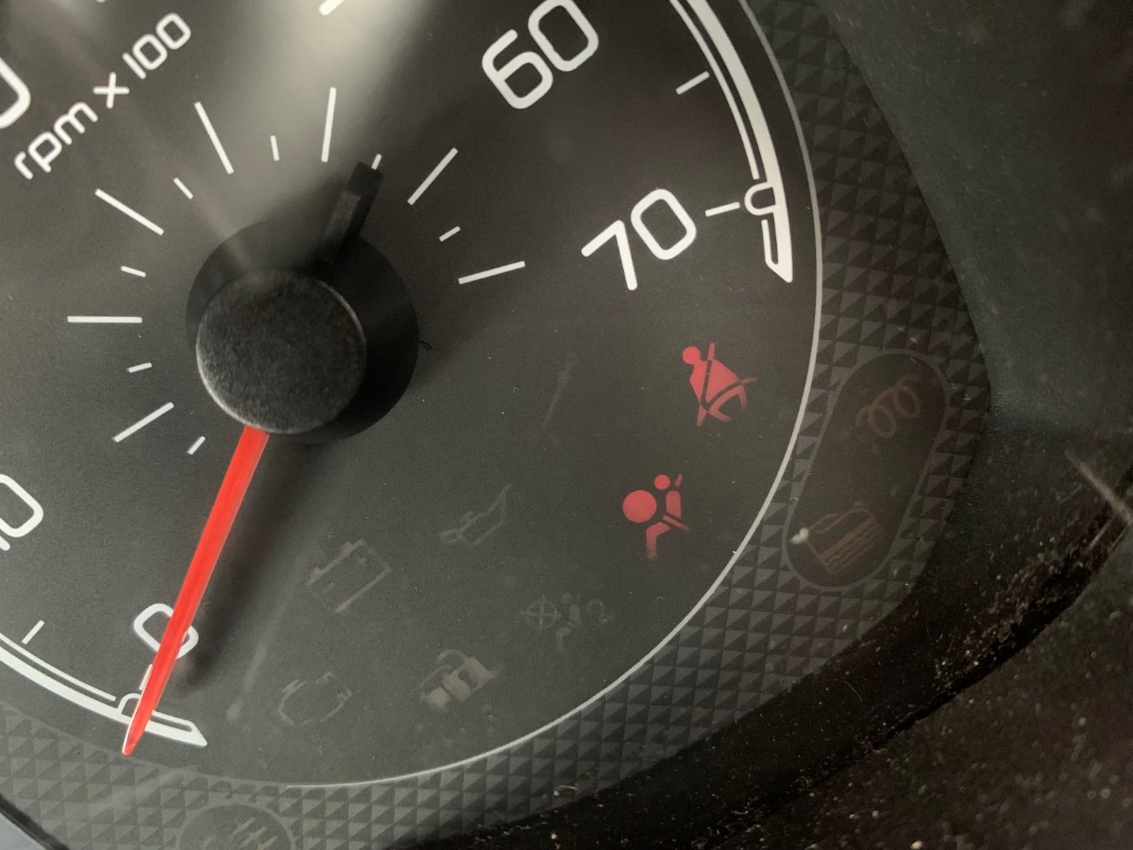

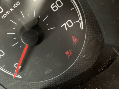

Still not solved, here are the lights that stay dim, does it look like an ecu problem?

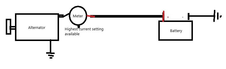

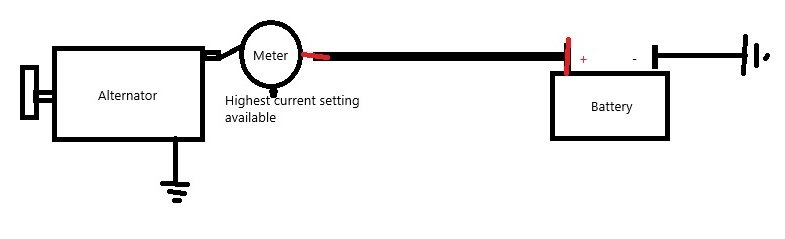

That would be a similar test. If you are going to disconnect the charging lead from the alternator then connect that lead to the red meter lead and the black meter lead onto the alternator terminal as in the sketch here:
If there is a fault in the regulator inside the alternator then you will see the leakage current on the meter. DO NOT start the engine with the meter connected there as you may wreck your meter!!
