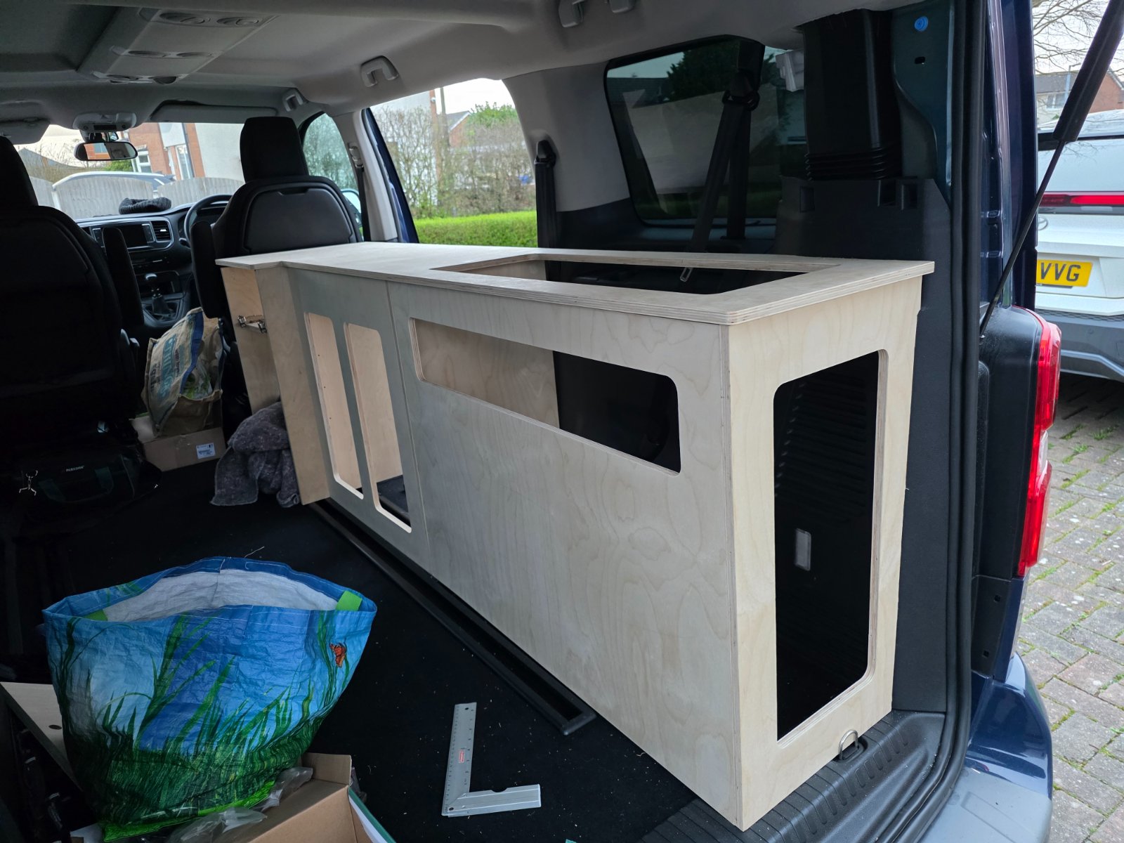

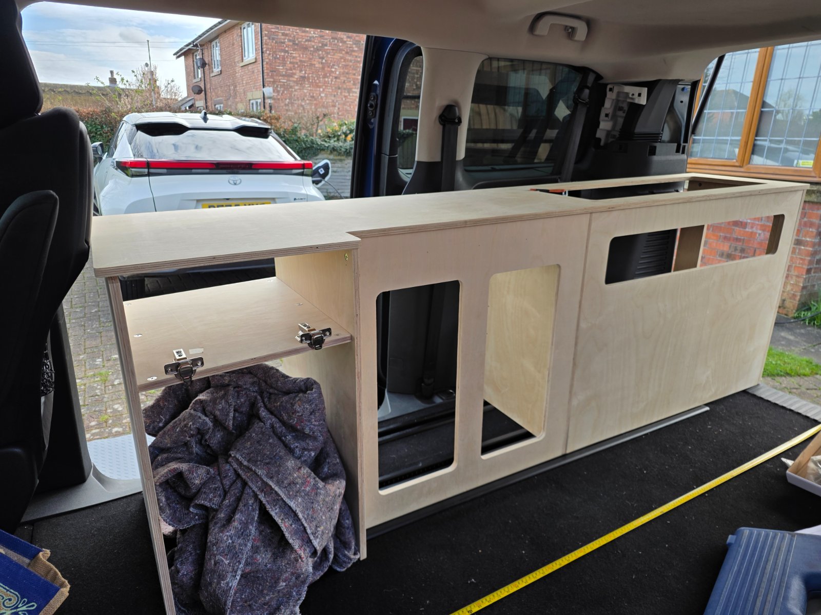

So, I.plan to convert the front passenger seat to a swivel base using the Kiravans kit; https://www.kiravans.co.uk/products/rib ... hand-drive
I've bought and dry-fitted the Monster kitchen pod; https://monstershop.co.uk/products/camp ... new-plugin
This is a flat pack unit so each panel is easy to manage, the worktop is the longest but not too heavy, and needs modifying if keeping the Spacetourer's internal mouldings, but it's just some shaving off the rear right corner to fit the radius. The rear vertical panel also needs some curved reduction, but a jigsaw and belt sander easily reduces it.
I need to mqake a decision on finish for the panels, the options are:
Melamine/Formica laminate and contact adhesive - expensive and risky cutting.
Epoxy worktop finish and vinyl sher on the verticals - I've never tried pouring epoxy on a plywood panel but from the YouTube videos, the finish looks great.
Varnish all panels - should be straightforward, just brushing on and sanding down.
