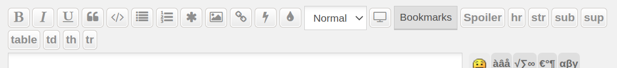

Go to the "Full Editor & Preview" box and it is between "Normal" and "Bookmarks"
