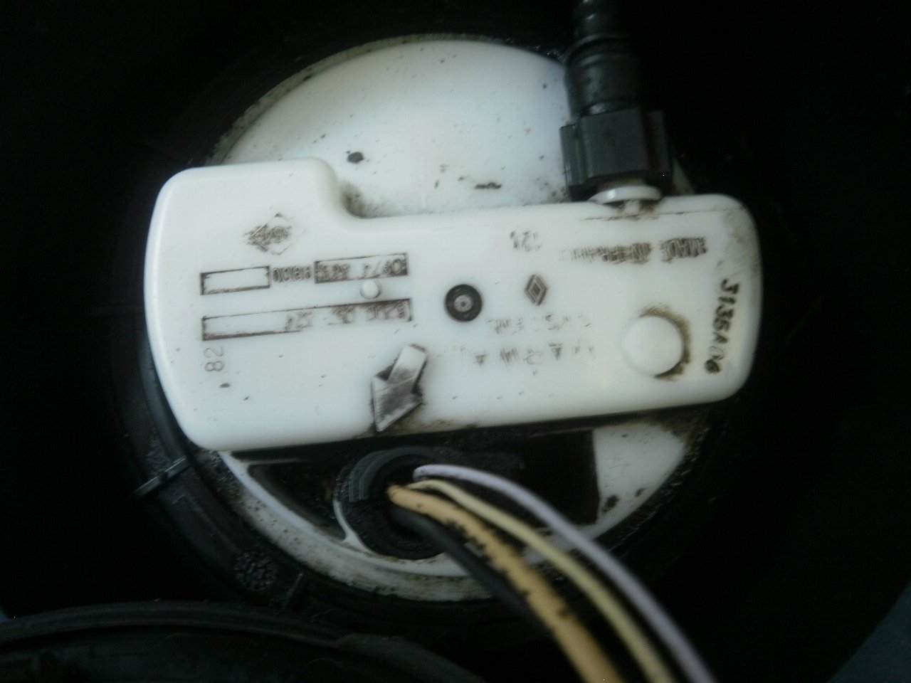

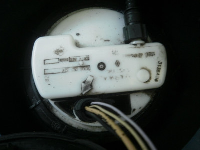

The fuel filter is a reasonably easy job, just have to be careful with those quick release connectors.
On the BB Clio much more difficult....it doesn't have an external fuel filter in reality. In parts catalogues it might, but in fact it doesn't, apart from an unserviceable one in the tank. A few tales on Cliosport testify thus https://cliosport.net/threads/fuel-filt ... 16v.49358/
The supply pipe is a long one back to front ending up at the fuel rail with no filter interspersed anywhere along its length. Don't think there will be any rust in the tank as with most things on the Clio only the finest plastic is employed.

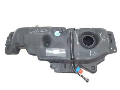

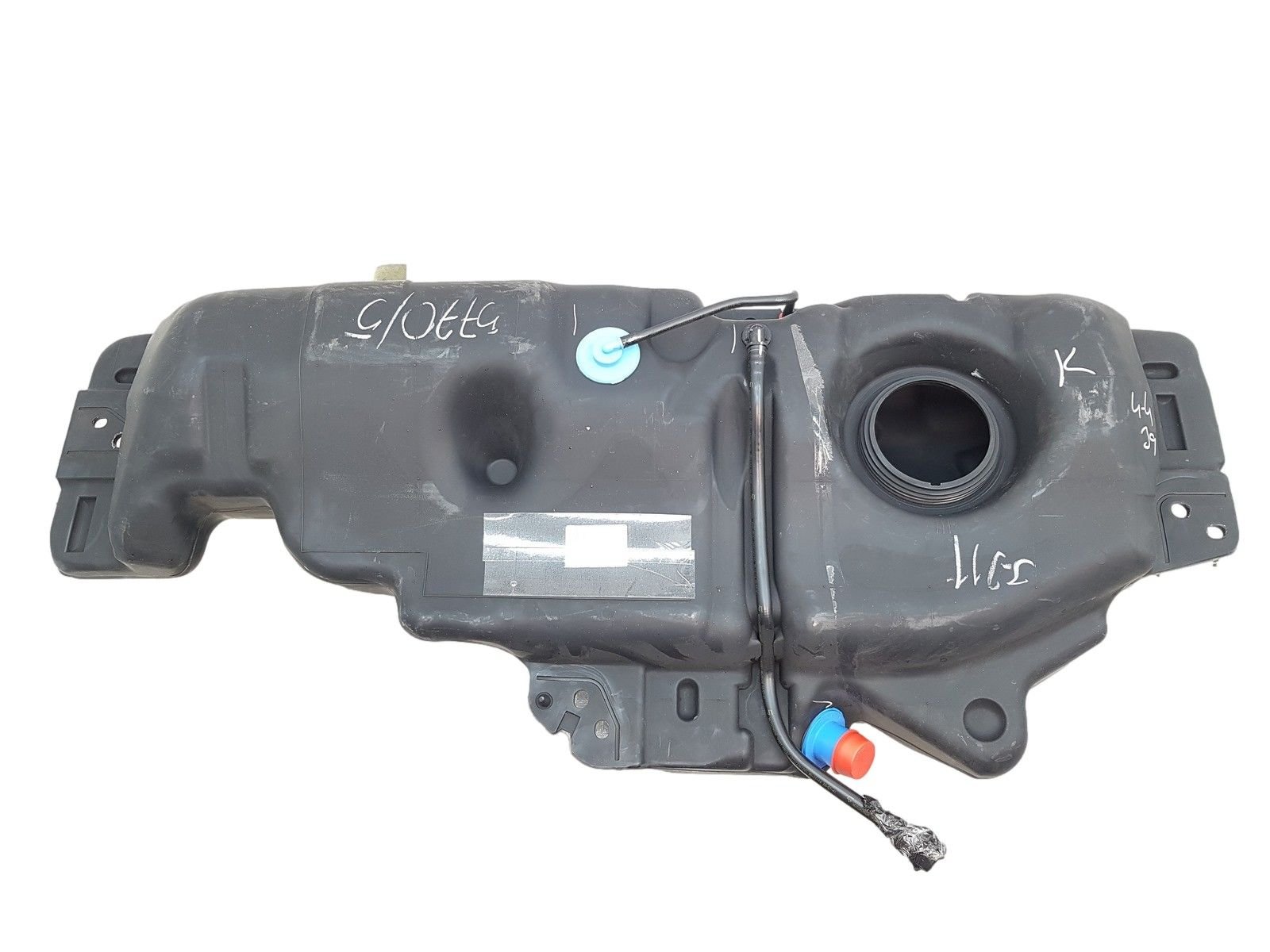

The tank unclothed is a convoluted beast with its outer reaches spanning the car.
As well as the "Supply pipe" running the length of the car, I presume its chum which it runs alongside up to the engine bay is the EVAP link providing a route for the tank vapours to make their way to the activated charcoal cannister behind the headlight.

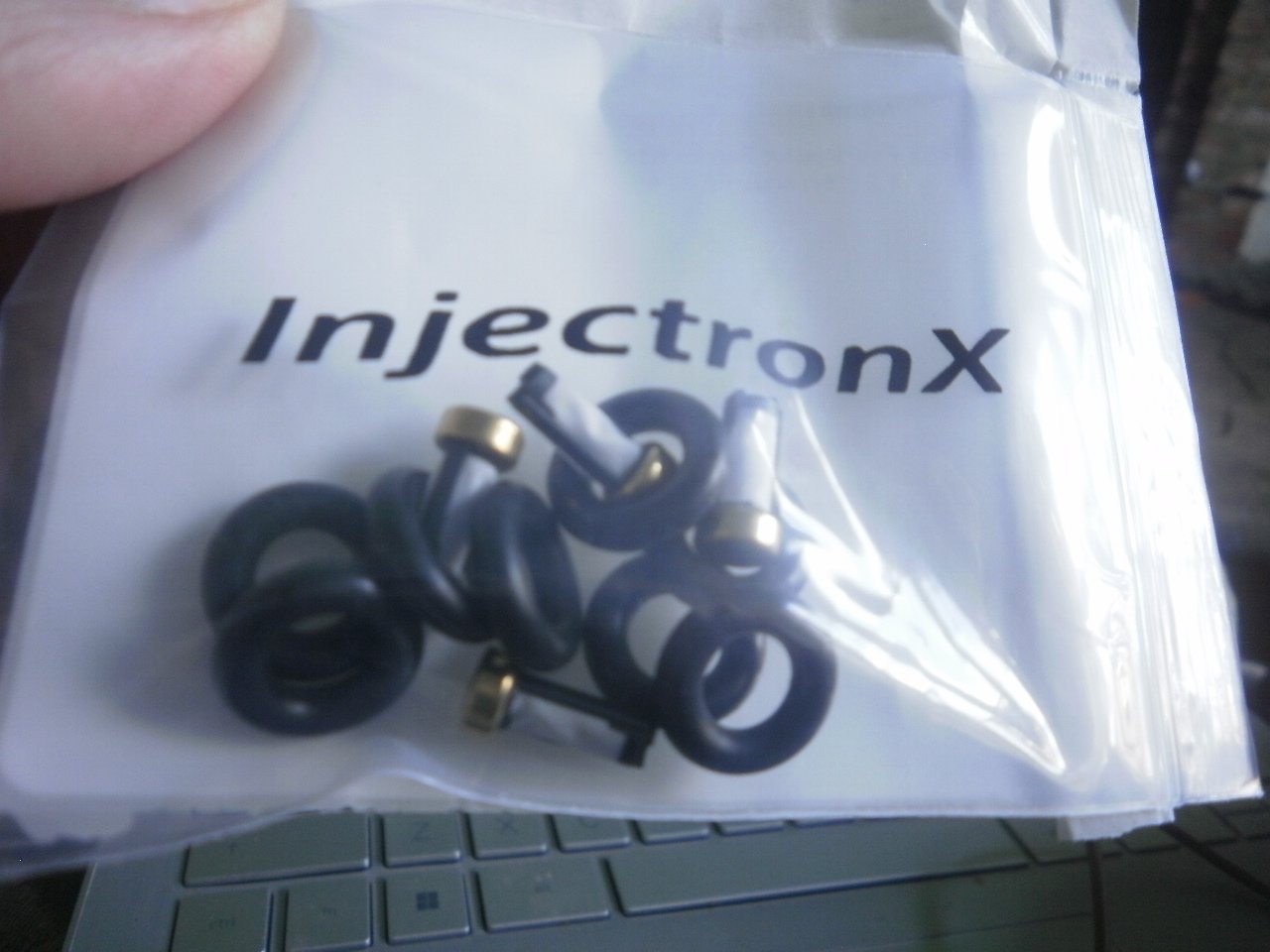

Little packet through the post from Eastbourne
8 x o-ring
4x filter

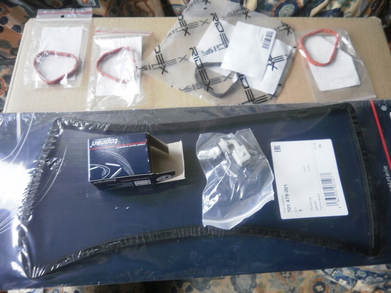

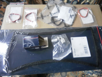

Its a first, an AutoDoc box delivered to the door. Not sure if they have a UK operation or whether it comes from "The Continent"
It was a ridiculously large box for the parts contained... 4 inlet manifold to cylinder head port gaskets (3 red one black), one manifold to top of engine rectangular gasket, one air intake temperature sensor (mounts on throttle body)

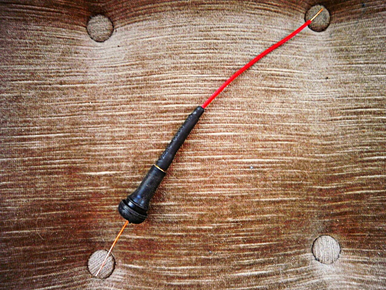

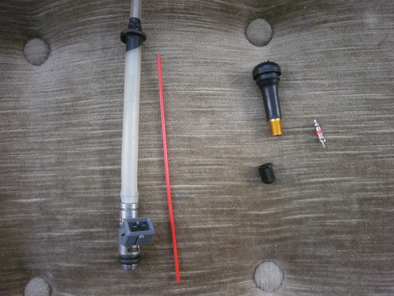

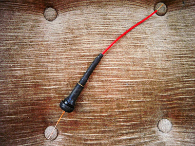

Here's the gear for the Falcon injector cleaning tool
PS It worked, but the mod using heatshrink is better than the insulation tape wrap at keeping things in place and for leak-free reliable operation.

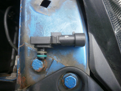

Just to show my point, not the greatest but you'll get the idea

Mark II of the off-vehicle injector tester/cleaner
Shrink wrap enhancement to interface with injector (red aerosol straw, progressively shrink wrapped to a girth fitting snugly into top of tyre valve.. Temporary wire insert to avoid melting aerosol red straw when applying heat for shrink wrapping.

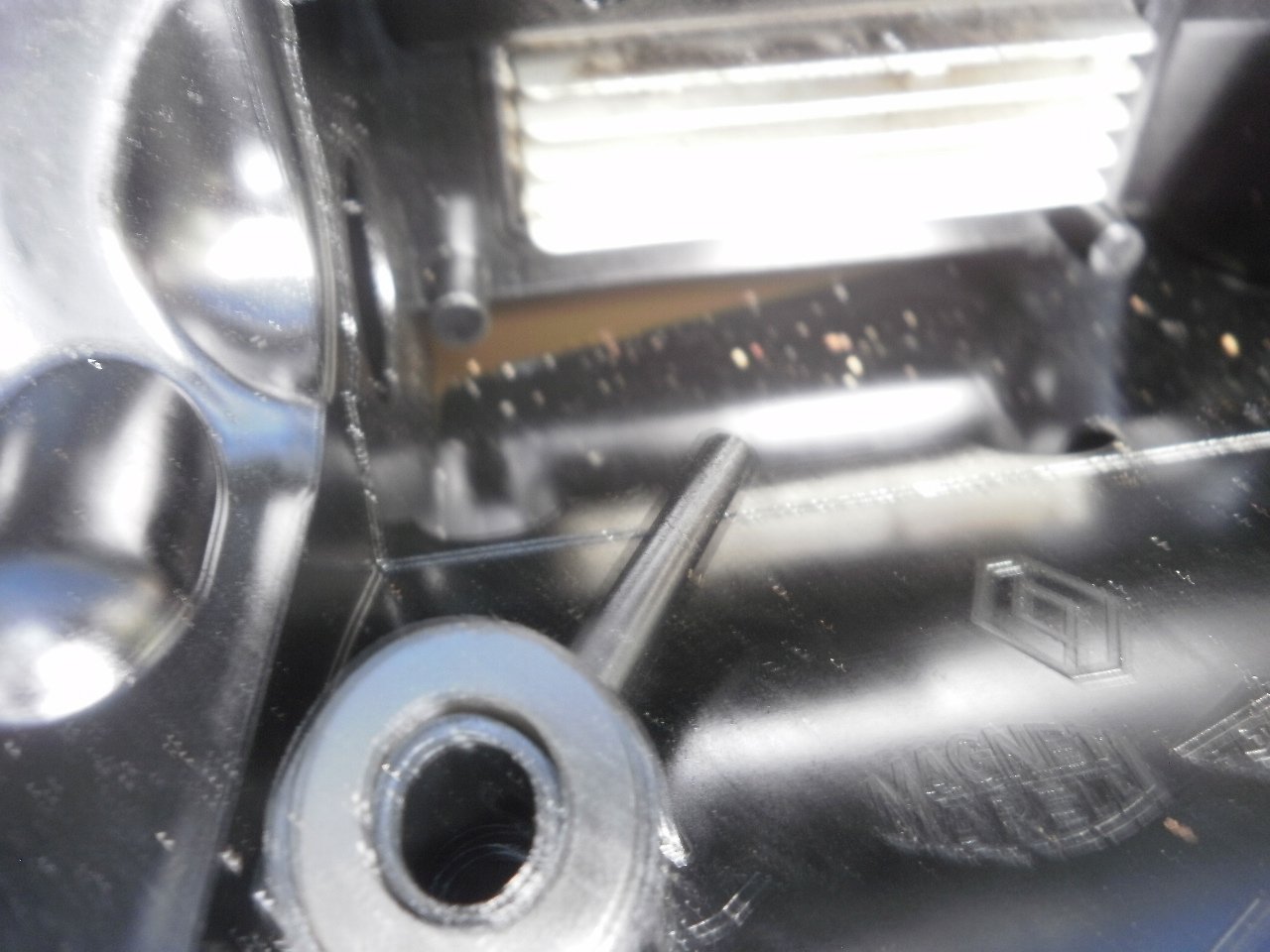

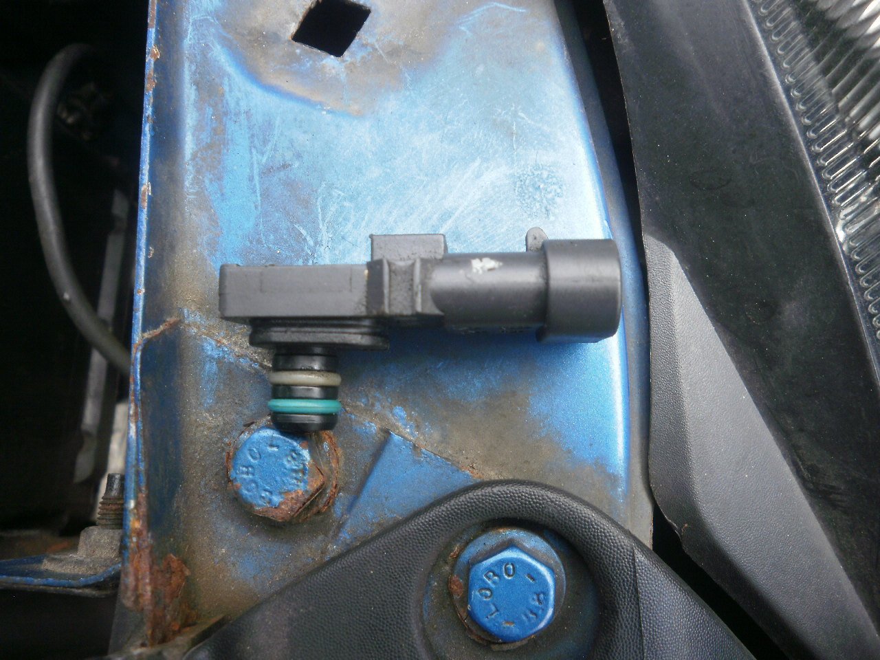

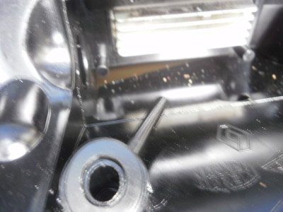

Old gaskets off the intake manifold, Old MAP sensor removed intact with its O-rings from its plastic hole where it is just a push fit.
I have dismantled, investigated and observed. So far the thing I like least is the pool of oil at the back of the airbox undoubtedly dumped there from the rocker cover through the little plastic pipe masquerading as some sort of crankcase ventilation.
The old MAP was a touch oily, probably just do a clean and shove it back in in the first reassembly. Neil

Not much scope for adding an oil catch can to the Clio crankcase ventilation system, there is no external pipework. Rocker cover ports out its oil-laden vapours through its internal plastic chambers and that fixed pipe directly into the airbox, and all is covered by the air intake manifold.
Any time you want to inspect the oil collection in the airbox the entire inlet manifold has to be removed.
