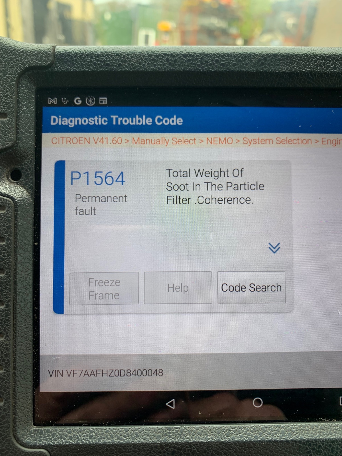

Nemo 2013 code p1564
Unread post by gsc1ugs »
There are many meanings on google for this error could someone please enlighten me how to fix? Thxs

Looks as if the exhaust dpf is blocked. Before you delete the code have a look at the freeze frame data to see what values were stored when the code was stored as it may help diagnose the problem. If it is blocked these can be cleaned off the car and then a diagnostic done to tell the car it has been replaced.
