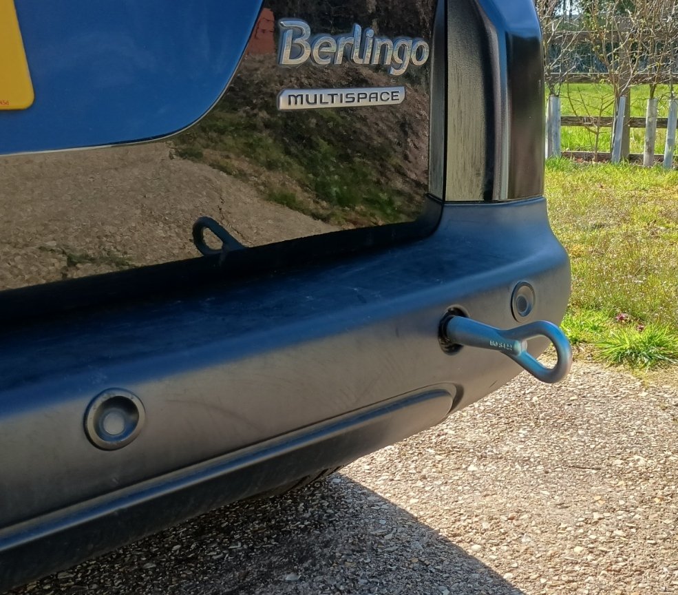

I'm going to be regularly carrying a long kayak on my roof, which needs its overhanging back end tying down.
I've screwed in a towing eye. I'd like to leave this permanently in. But understandably I now get a beeeep all the time I'm reversing. The display shows the obstruction is on the corner, so I think it's only being seen on that one sensor, not the one to its left...
Is there a way of disabling this one sensor? I have the dealer software on a laptop and an interface. I also don't mind doing a bit of electronic trickery if necessary, e.g. fudging a resistor or similar so the computer thinks the sensor is connected when it's not.
All ideas welcome!
All ideas welcome!

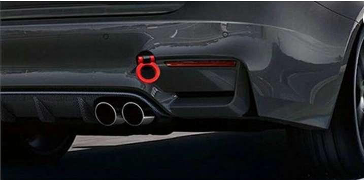

I would suggest you have a look around for folding towing eyes as we used in motorsport, something like this:
https://www.ebay.co.uk/itm/188202124957

Mick is right - If your really want to leave the towing eye in place you could use something like this............mickthemaverick wrote: 27 Mar 2026, 07:05 I would suggest you have a look around for folding towing eyes as we used in motorsport, something like this:![]()
Folds out of the the way so it shouldn't interfere with the sensors and you don't hit you shin every time you walk past the back of the car - ad it look prettier than the stock eye.

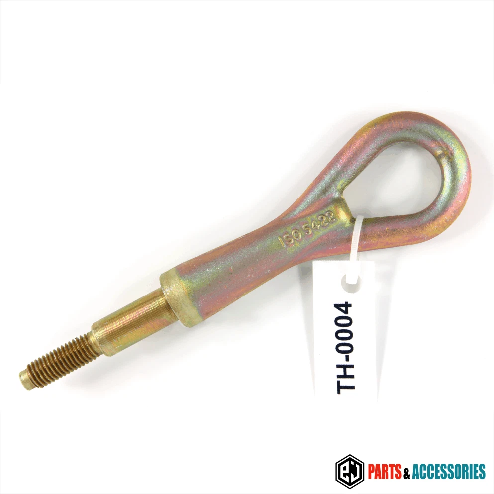

That was my previous idea. I wanted a little screwed eye. Unfortunately, although I think it is a standard M12 thread, it has a fatter part further out that's not threaded, basically just a rod about 20mm diameter. Basically the thread stops it falling out and holds it in when the fatter part meets the back of its hole when tightening. I think the thread just goes straight through, so a bolt would just sort of hang there and couldn't be tightened up against anything.Richard_C wrote: 26 Mar 2026, 22:25 Why not find the thread size and insert a bolt with a D ring of some sort? Much closer to the intended bumper dimensions.

The tie-downs for the kayak are metal hooks. With the folding eye this would press into the bumper at the back or the bumper and headlight at the front. It needs the stand-off that the towing eyes provide, together with their resistance to bending.
I don't have a great aversion to removing it, my concern is that after 50 or 100 removals/refits the screw thread would probably give up.
I don't see a fundamental difference between the rear one and a towbar - it's the same concept, just off-centre. I've bought some yellow paint though.
The front one is more of a potential issue. I'll paint it yellow anyway but it may need removing between uses, I'll get some official guidance.
Anyway... good news, the rear sensor appears to have automatically re-calibrated and no longer goes beeeeep. I guess after 2 or 3 reverses it's decided that whatever that obstacle is, it's not moving relative to the sensor so must be part of the car. Makes sense, otherwise you couldn't have a towbar fitted.
Thanks for all the ideas, really appreciated.

Re: Disable an individual reverse sensor?
Citroen's weird towing eye design...
The screw thread holds it in, after that fatter part behind it bumps into the front of the tapped hole. This is recessed inside a tube that's just wide enough for the fatter part. The sides of the fatter part provide its resistance to bending.
It's quite a neat design, but unfortunately this means you can't use standard bolts as there'd be nothing to tighten against.
