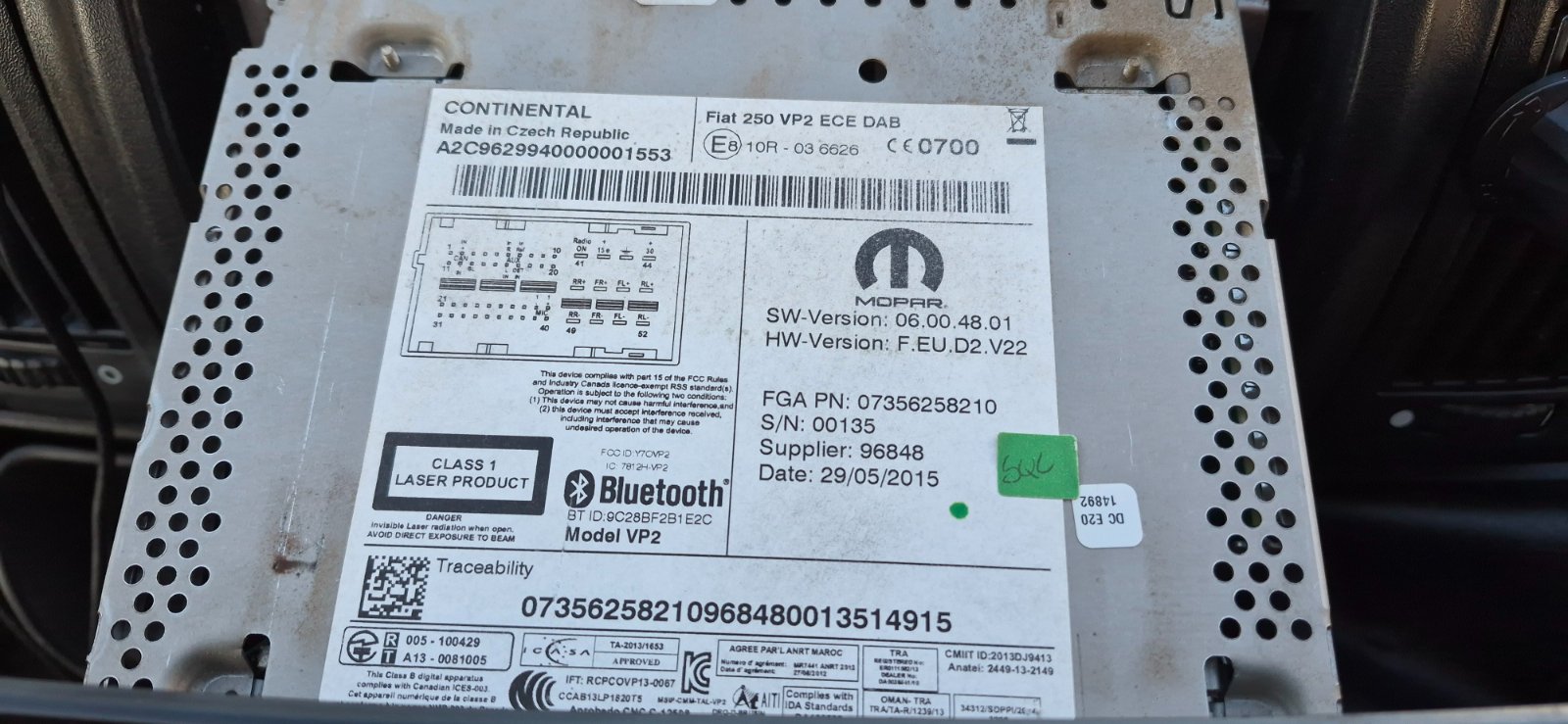

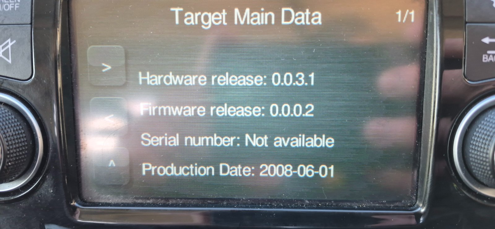

It's a Citroen Relay 2016, head unit is VP2 model without sat navPaul-R wrote: 24 Mar 2026, 10:32 What car?
What year?
What head unit is fitted?
And, probably the most important thing, what firmware is currently fitted?
Are you having any problems that you think a firmware update might fix?
When I'm trying to press DAB can hear just a "beep" and is not activating, FM and AM works fine
Hardware release : 0.0.3.1
Firmware release 0.0.0.2
Production date 2008-06-01

The Relay is really a Fiat Ducato (you can see the name Fiat on the label stuck on the HU) and I have no information on that. Sorry.
