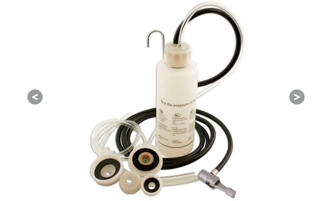

I found pressure bleeding worked on mine when I just changed the fluid, didn't have diabox at the time too.
I have an old (very old) easy bleed tool, it pressurises the master cylinder using the spare wheel as a pressure source.
WOW, still make it!
https://www.gunson.co.uk/Product/G4062/Eezibleed-Kit

Sorted it in the end, a positive pressure bleeder kit + me pushing the pedal like the old days and my mate bleeding each in turn:-)
