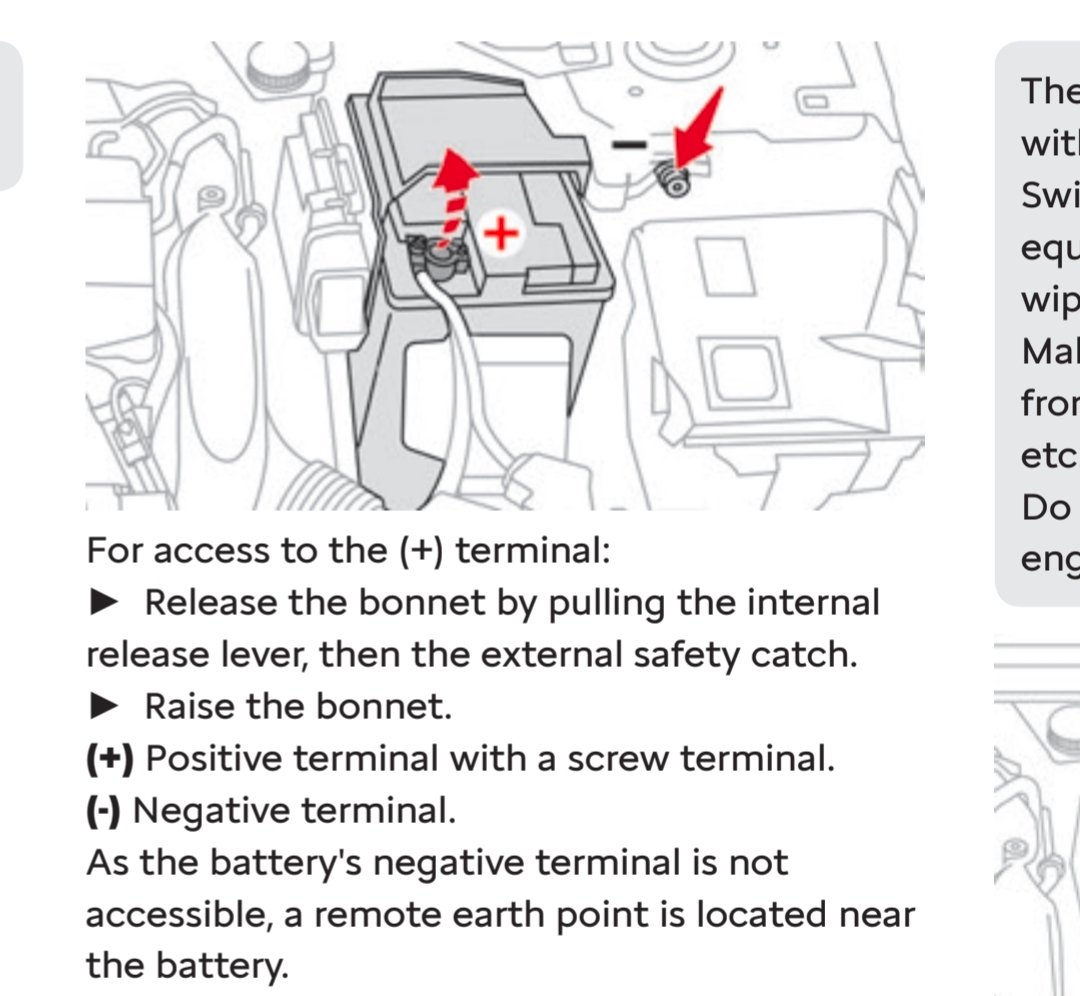

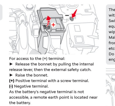

The owners manual actually suggests disconnecting the battery if left unused for a long time. If you did you would have to use the manual key to open the Passenger Door!.
Remember,as well as the proximity unlocking using battery while parked, the over the air update system and the app data may also use battery capacity.

Theres all kinds of drain on modern cars, a few things you could try if its to be left unused for a period.
On most cars I've had, locking using the key (or blade in Citroen's case) leaves it locked but with the alarm off. You can usuallay disable the volumetric alarm with a button on the dashboard. If you go into lighting settings you can turn off welcome lights and follow me home lights (or whatever they are called now). It can't be helpful if the headlights come on as soon as you get near the car and before the engine is started - maybe less of problem with LED.
I was pretty sure you could stop proximity unlocking - mine's a C4 - I will be in the car waiting for someone tomorrow so will play with all the menus and try to find it in case its the same as yours.
