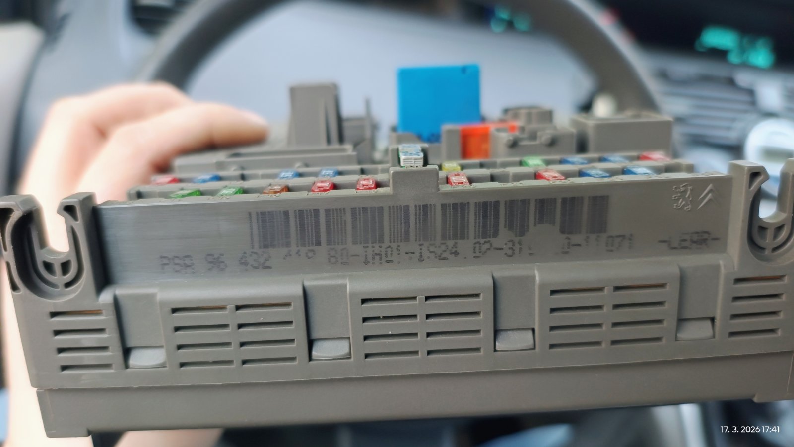

I took out the BSI, I'll check if there was water in it. I can't even read the OE number, no paper label, nothing on the box.
