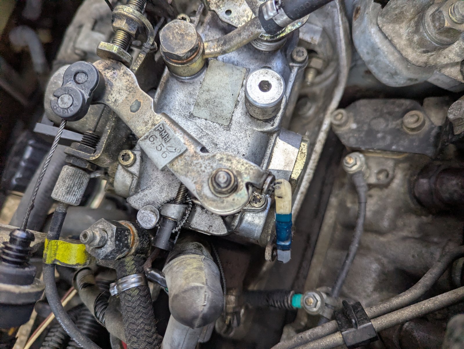

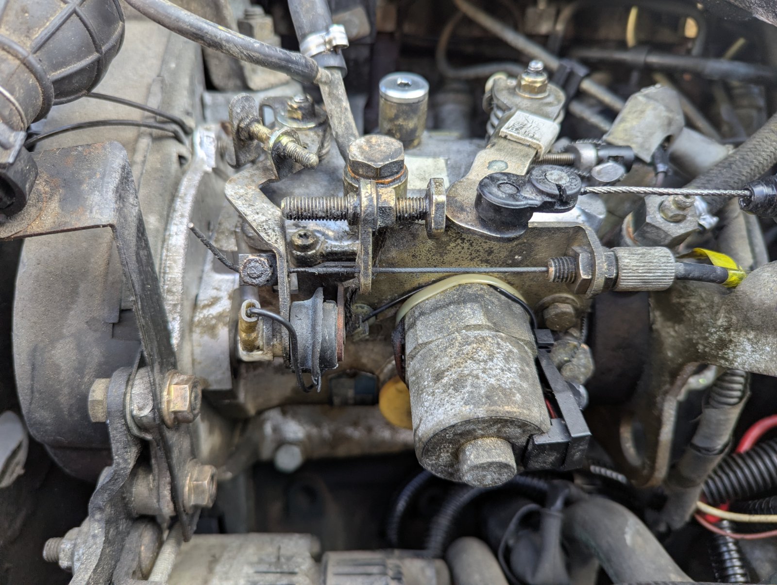

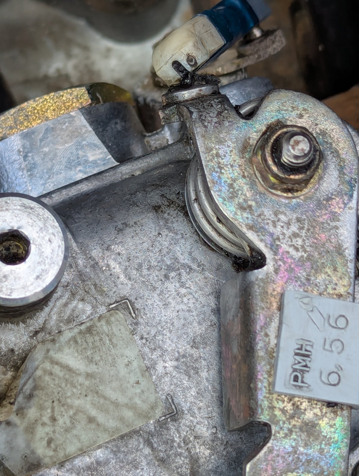

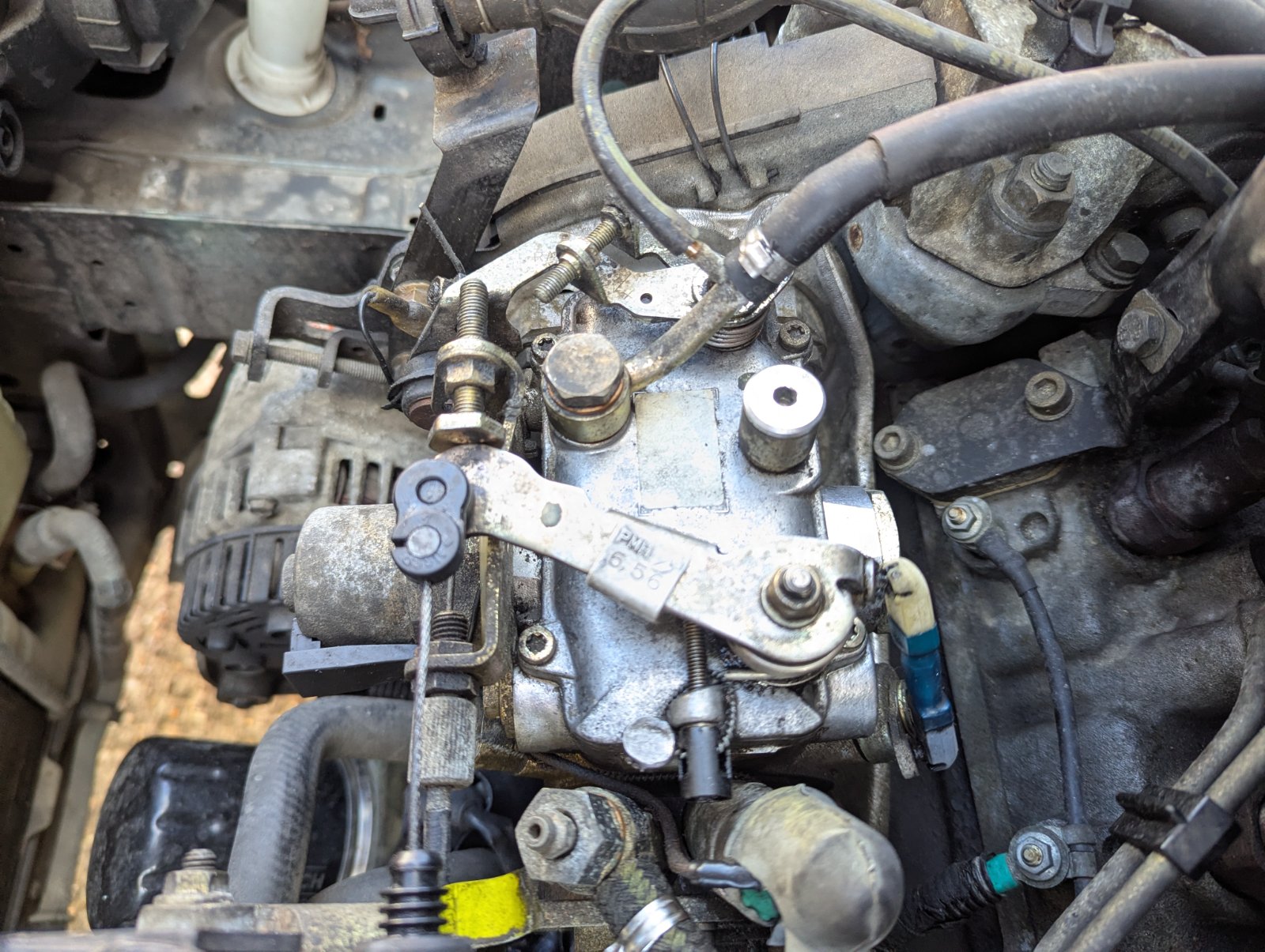

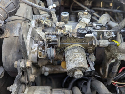

Hi, I'm back with Pump pictures. Armed with a brake cleaner like fluid and a paint brush there's a bit of damp under the pin which cranks off off the main throttle control. The lid seems clean.
Having chased leaks round commercial engines for years I understand about travelling and pooling. I also know the value of experience and I'm grateful for all the assistance and suggestions that people have taken the time to write.
This 'back' control (blue arm in pics) is some sort of compensator? I'll give it a more thorough clean and test. Is it a likely leak point?

Re: Lucas Non turbo pump for XUD9
Hi Alex,
The lid does look clean - almost as if it's been changed recently...
The big solenoid on the front face is also a timing device. This, the blanking plug under the round yellow cap and indeed the shaft at the other end of the 'blue arm' can potentially leak...
Only thing to do is to give the pump a very thorough clean and watch carefully...
Somewhere - deep in my archive - I may still have some exploded diagrams of the earlier version of this pump that may help should you need to
dismantle it. Let me know.
It's been many years since I've been inside a Lucas pump but I believe the blue arm, is part of the timing mechanism.Dog306 wrote: 14 Mar 2026, 13:20 This 'back' control (blue arm in pics) is some sort of compensator? I'll give it a more thorough clean and test. Is it a likely leak point?

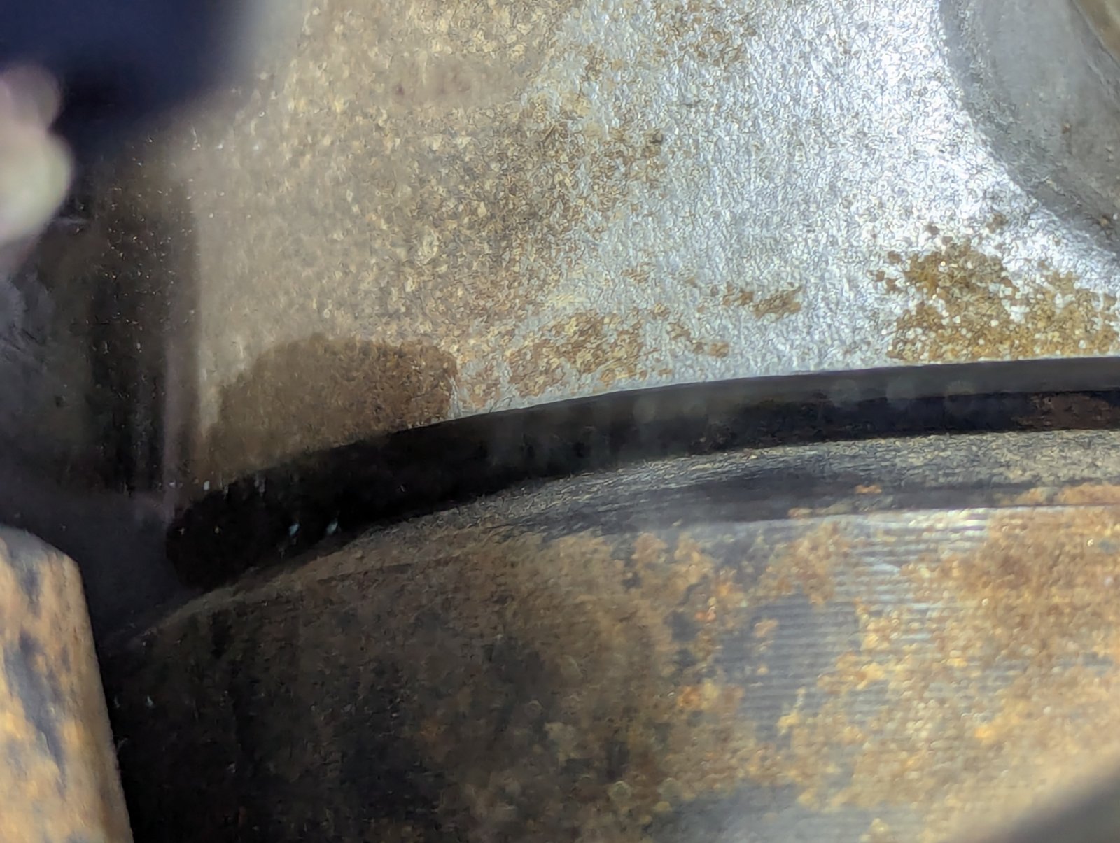

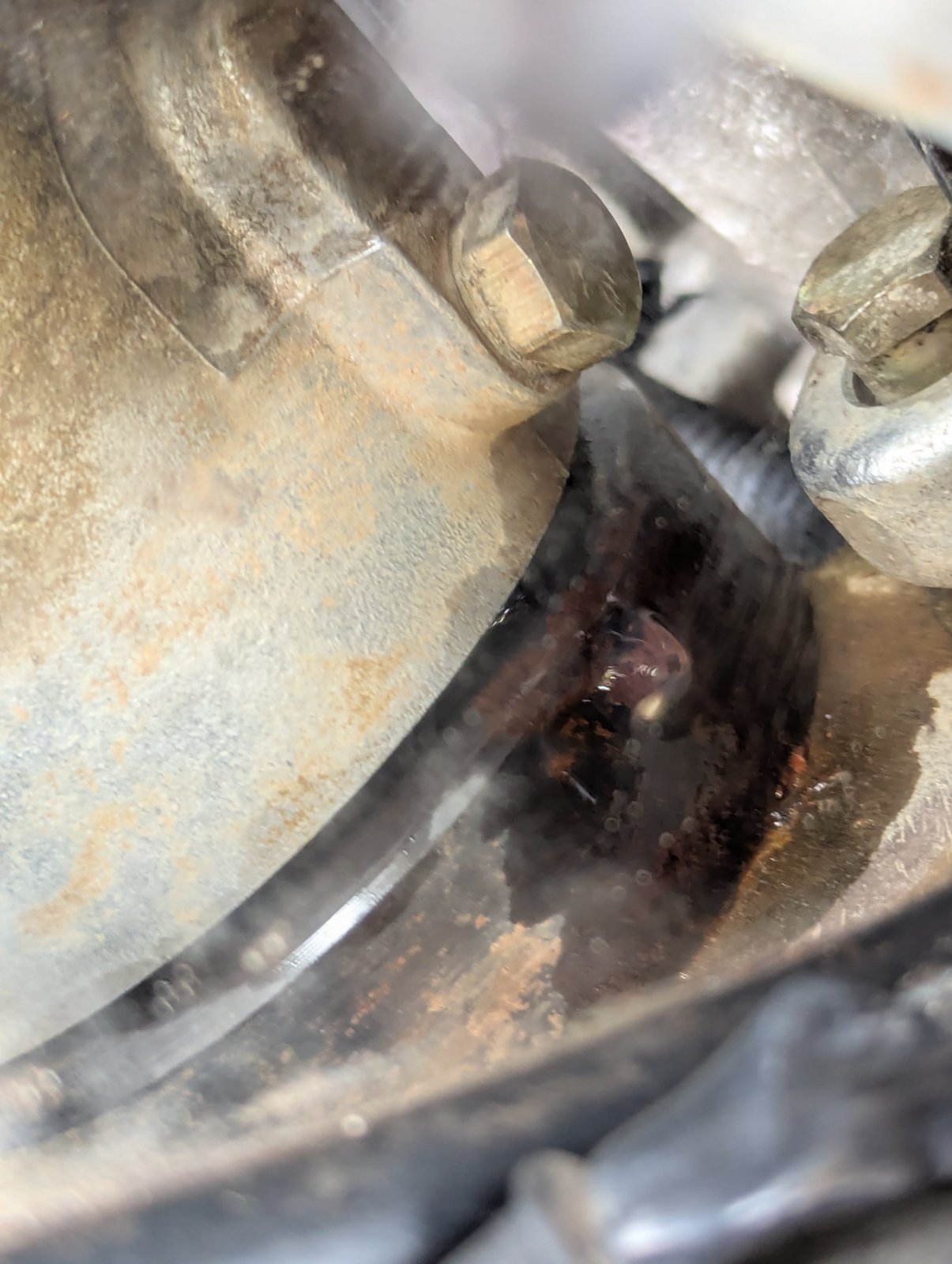

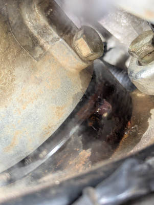

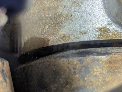

Hi,
I've got another picture, having busy on other stuff for a bit.

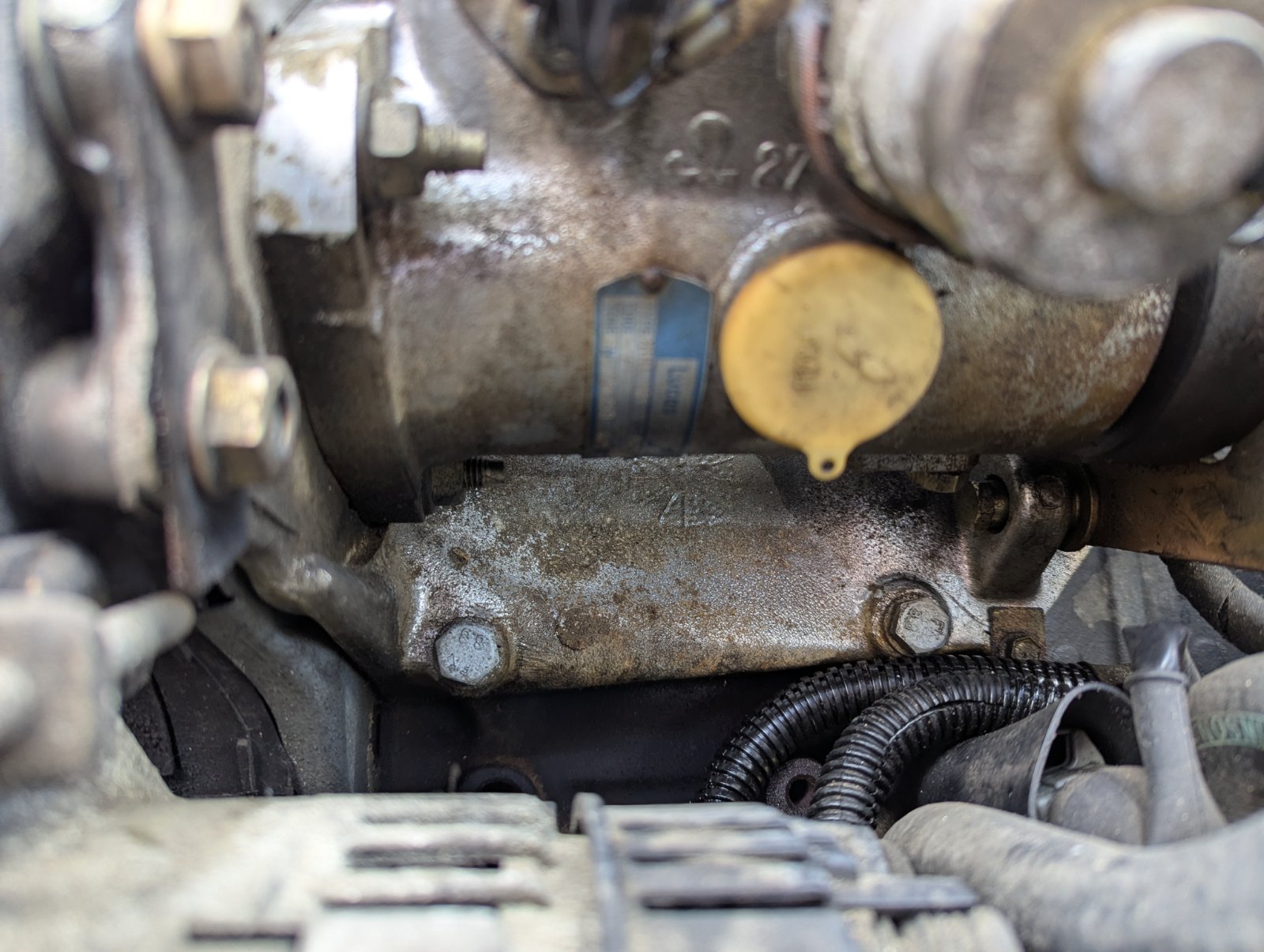

It appears to be the joint between the steel, distribution side and the main pump. The fuel is in the recessed joint but not on either side and it doesn't seem to be the cap on the injector pipe side. Can this seal be done in situ? Is it worth trying?
