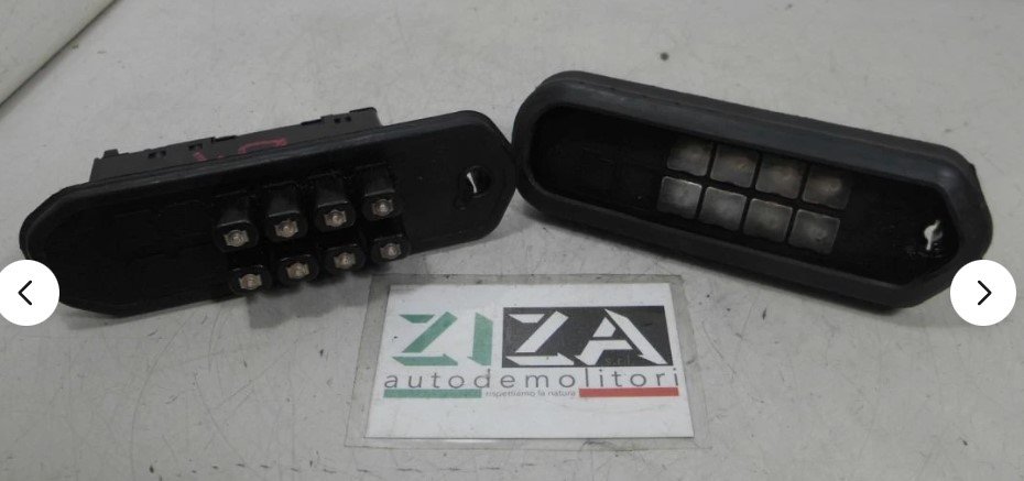

First and easy thing to try is cleaning the 'piano' contacts on the doors, These are the electrical contacts between the door & body. They are known to be problematic & can cause various different door issues.
