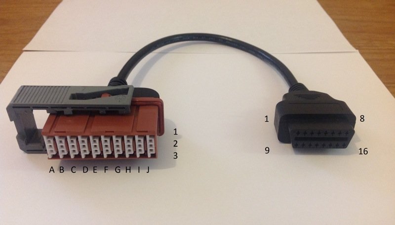

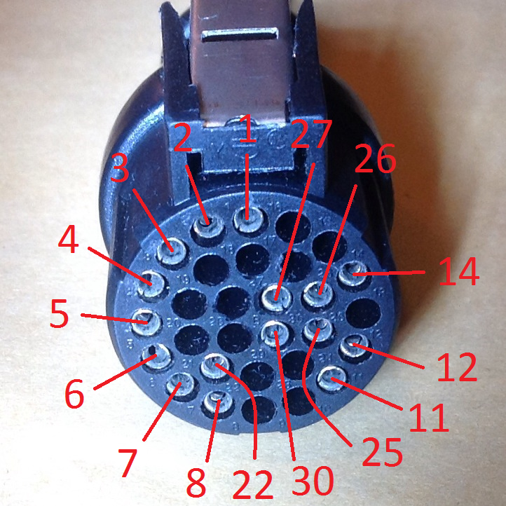

Mandrake wrote: 28 Jul 2014, 21:48 Steve, here is the wiring from the round connector all the way through to the 30 pin rectangular connector.
The pins on the round connector are actually numbered on the plug but the method of counting them is a little ambiguous so I thought it best to take a photo and show the pin numbers as I interpreted them:
Here are the pinouts referring to the above picture and the 30 pin rectangular connector on my previous post:

A few people have asked about the wiring of these cables recently, dropbox killing external links ruined my picture attachment above a few years ago so here it is again:
And here is my adaptor:
Simon, I'm gonna find you and I'm gonna kiss you!
After days of struggle I finally got it working thanks to your pinout diagrams!
The first time I saw this I didn't realise there was a page 2 on it, and it beeing from 2014 I didn't wanna write anything in here but now that you've updated it i'm gonna do it so maybe this can help somebody.
I had the 30pin to OBD 2 adapter ordered from E-bay years ago and it never worked. Looking at your schemes I realised that there were no pins where they were supposed to be for eg. A2 (ignition +12V) C1 and C2 (CAN ECU lines) were missing on the adapter. So I disassemled mine and started reassembling it back up as it should be. Finished, tested and it didn't work. Then i realised, after i saw your last post that I mirrored the OBD2 connector, actually I looked up some pinout diagrams online and thought they were meant to be for the on car side of the connector but they were not... Long story short, I didn't fry anything (luckily) and I have the adapter working now after looking at your updated pictures!
