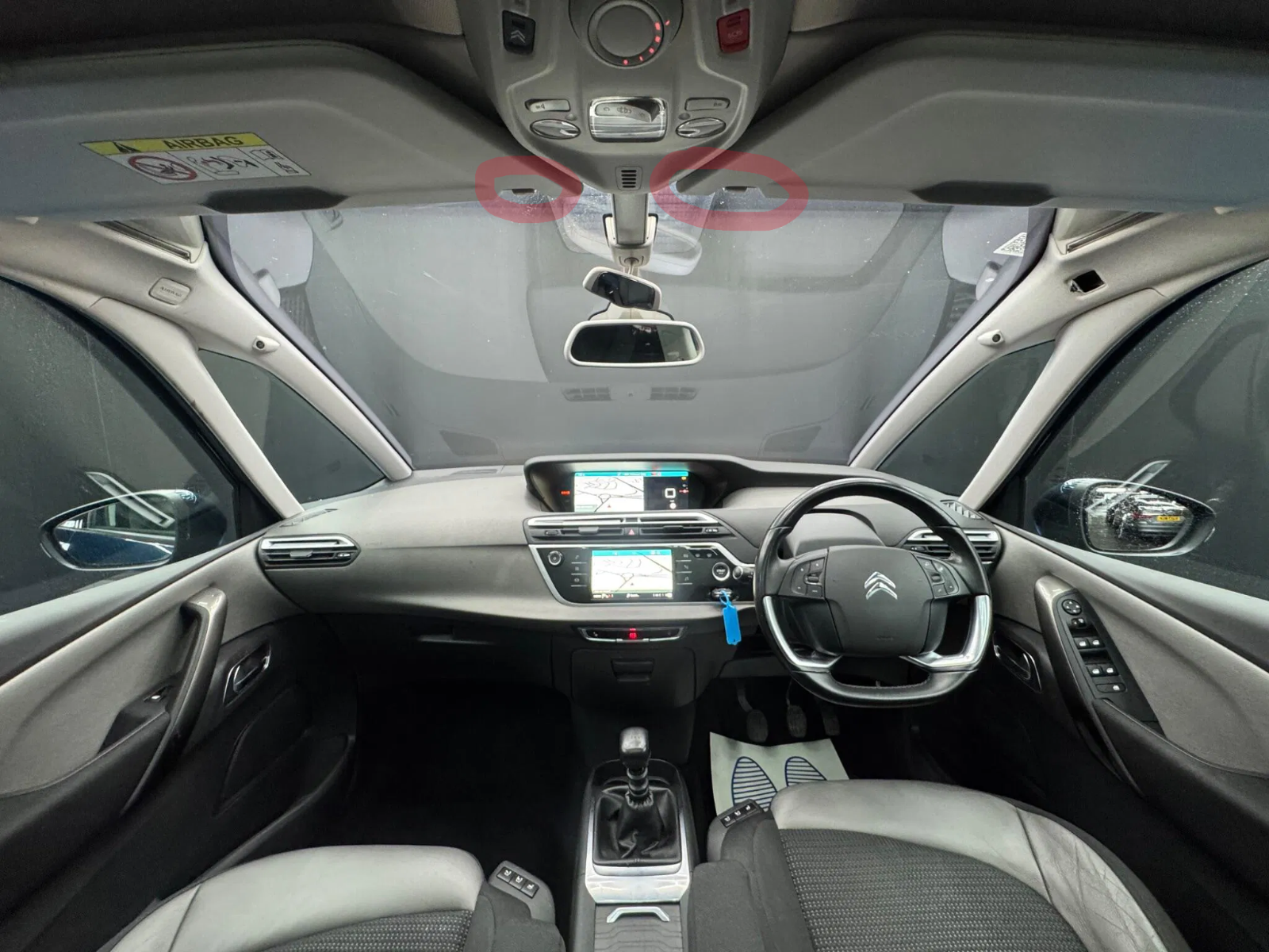

Hello,
I have an issue with my car that is really bothering me.
The sunvisor flaps. The rotating thing that covers from sunlight just above the driver's head, they are heavily vibrating and making noises. Yet I don't see or notice any loose or damaged part.
I am wondering if there's a way to fix or dampen the vibration.

I don't mean they are flapping, I call those sun visors "flaps". They are making a vibration noise, but they are clipped in their "hooks". Pardon me, as my main language is french. The part highlighted in red is making vibration noises, but it's not "shaking" or what.

That is the end which uncliips to allow you to spin them round to the side windows so my guess is that the pins are worn. I'd wrap the pins with cloth tape, like bicycle handlebar tape, and that should take up the slack and stop them vibrating.
