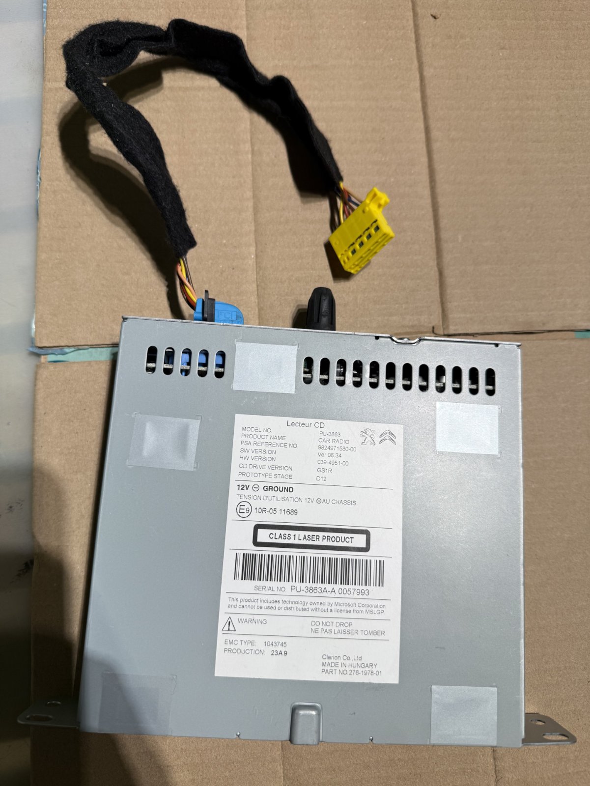

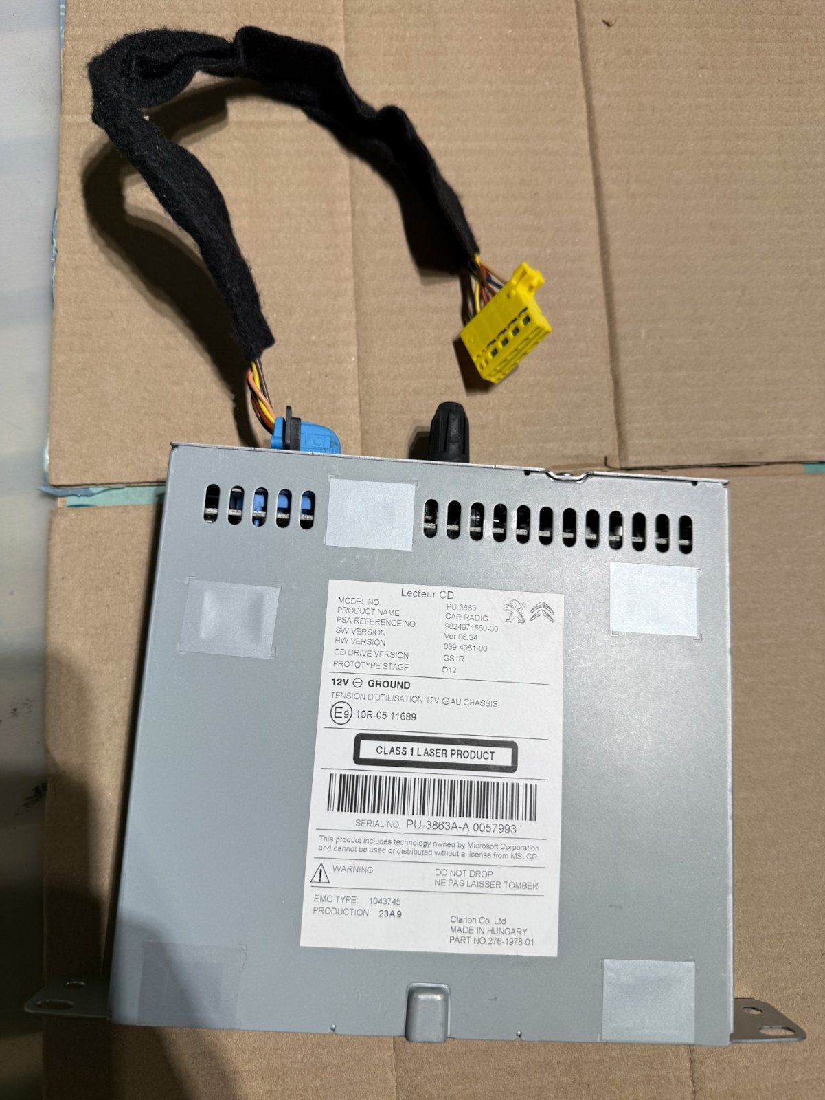

After the successful installation of the Nac Wave2 today I have installed the Cd-Player…
Nothing to modify for connection. Just Plug n Play.

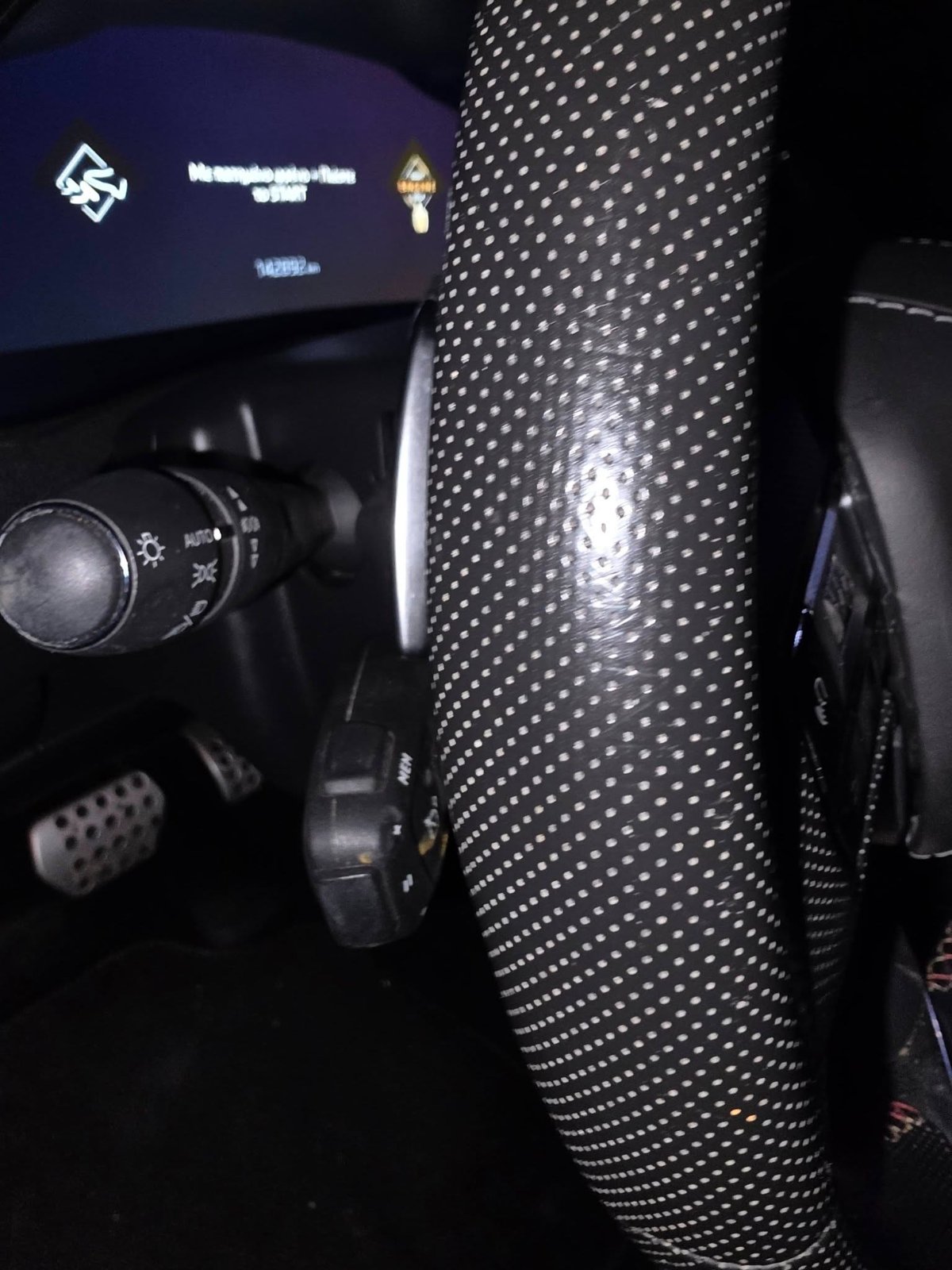

Re: RT6 to NAC (Connected NAV) Upgrade
Cirocco cluster installation succeded. Everything works perfect. It seems like the car had exited the factory door with this thing... Perfect incorporation.
Also the DS4 steering wheel has been added to take advantage the extra buttons to control the cluster. Still wait the 3Dprint Cover to arrive from the Leather Shop. It will be covered with Leather to Much the Car interior leather.

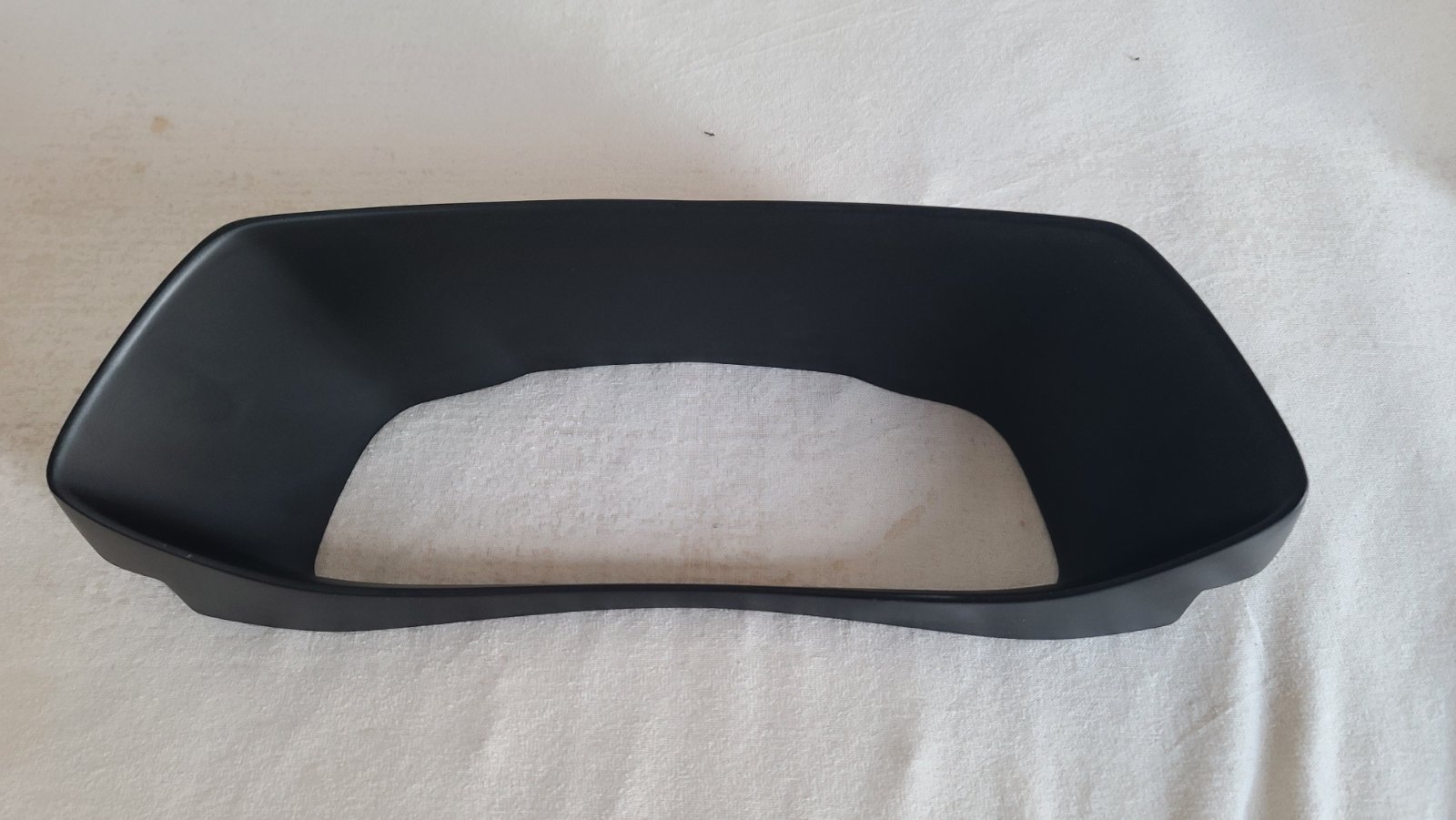

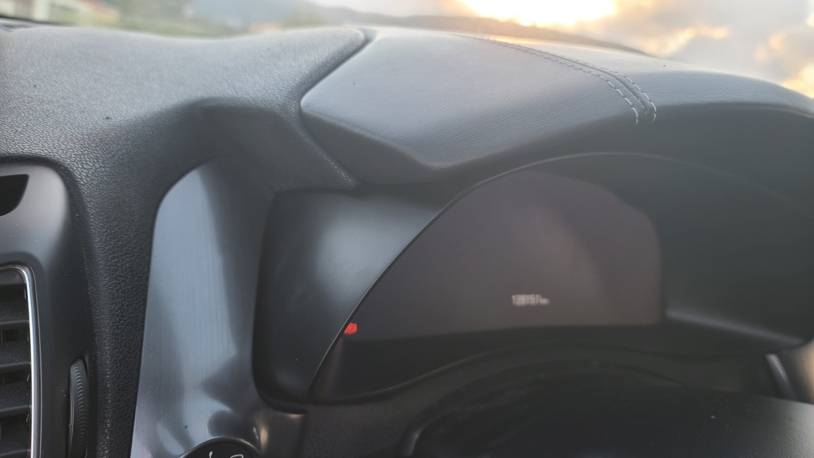

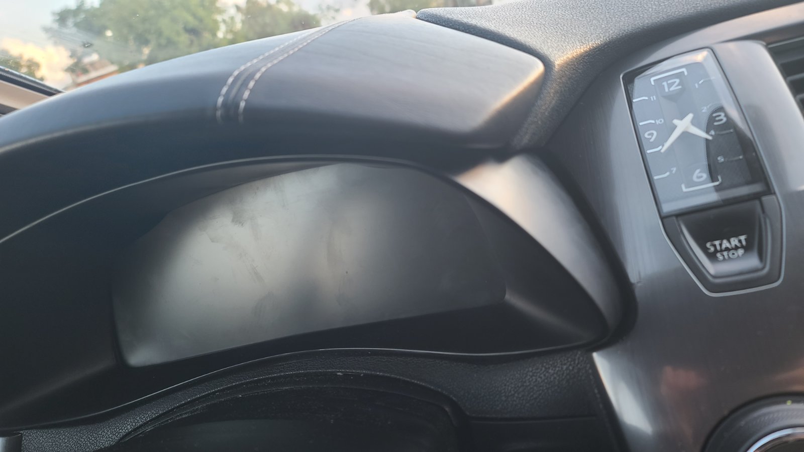

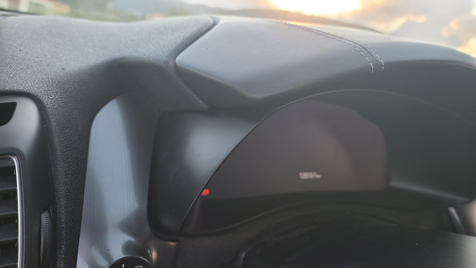

3D print Cirocco frame painted and installed. (Leather cover on order for later.) The new Cluster has everything the old one had with a few more options that i am still searching...
Results are beyond my expectations.

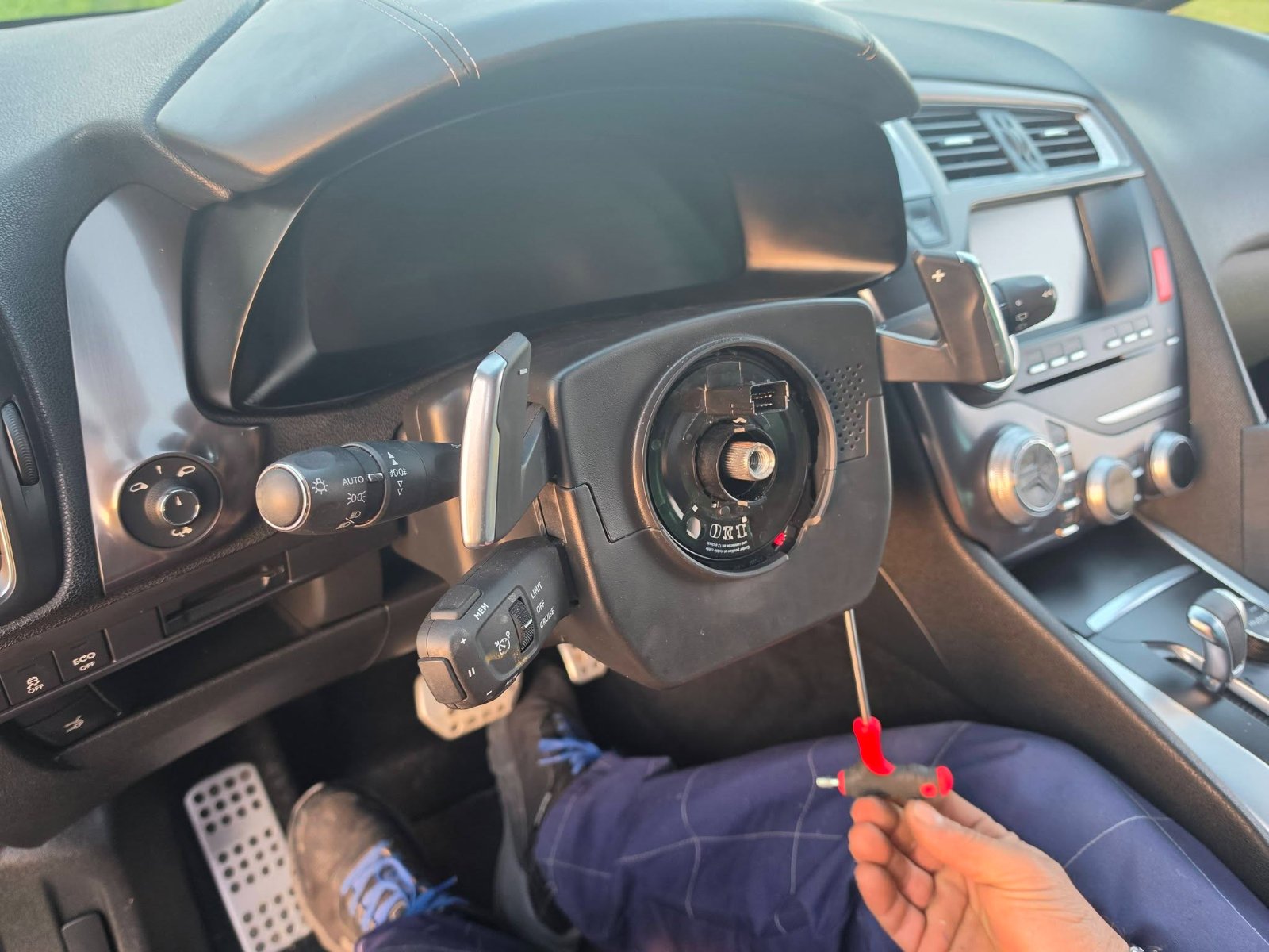

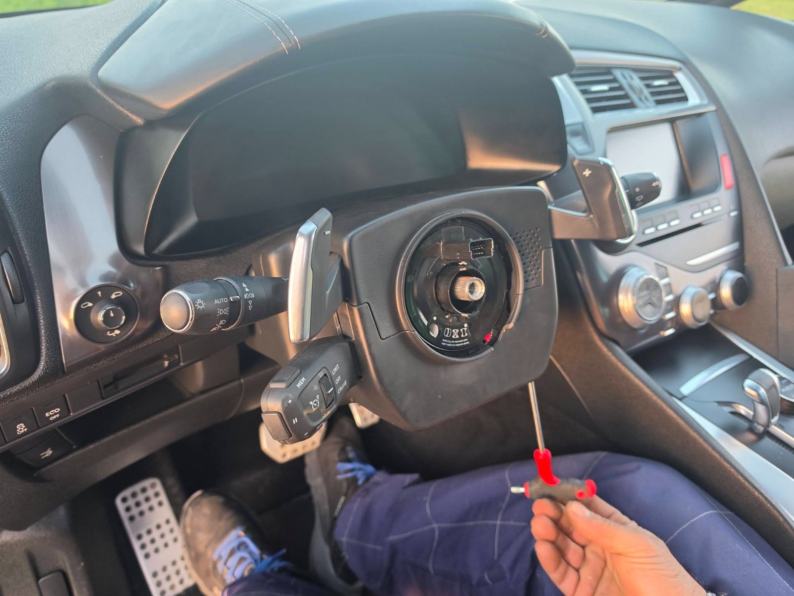

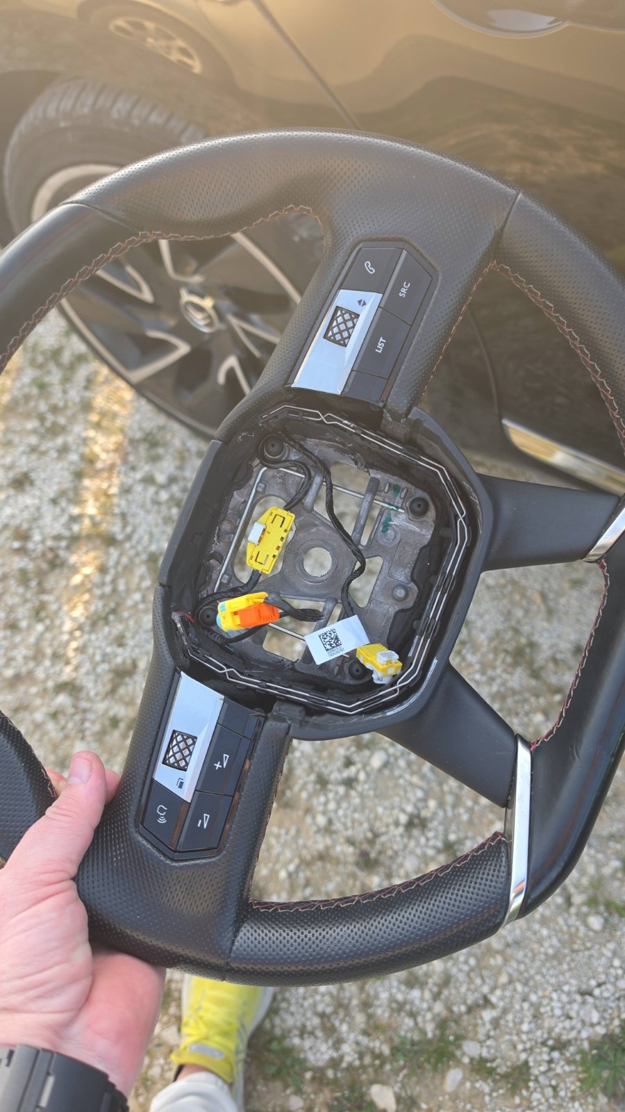

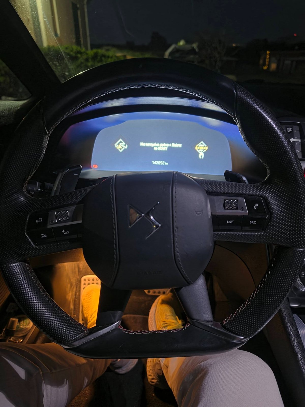

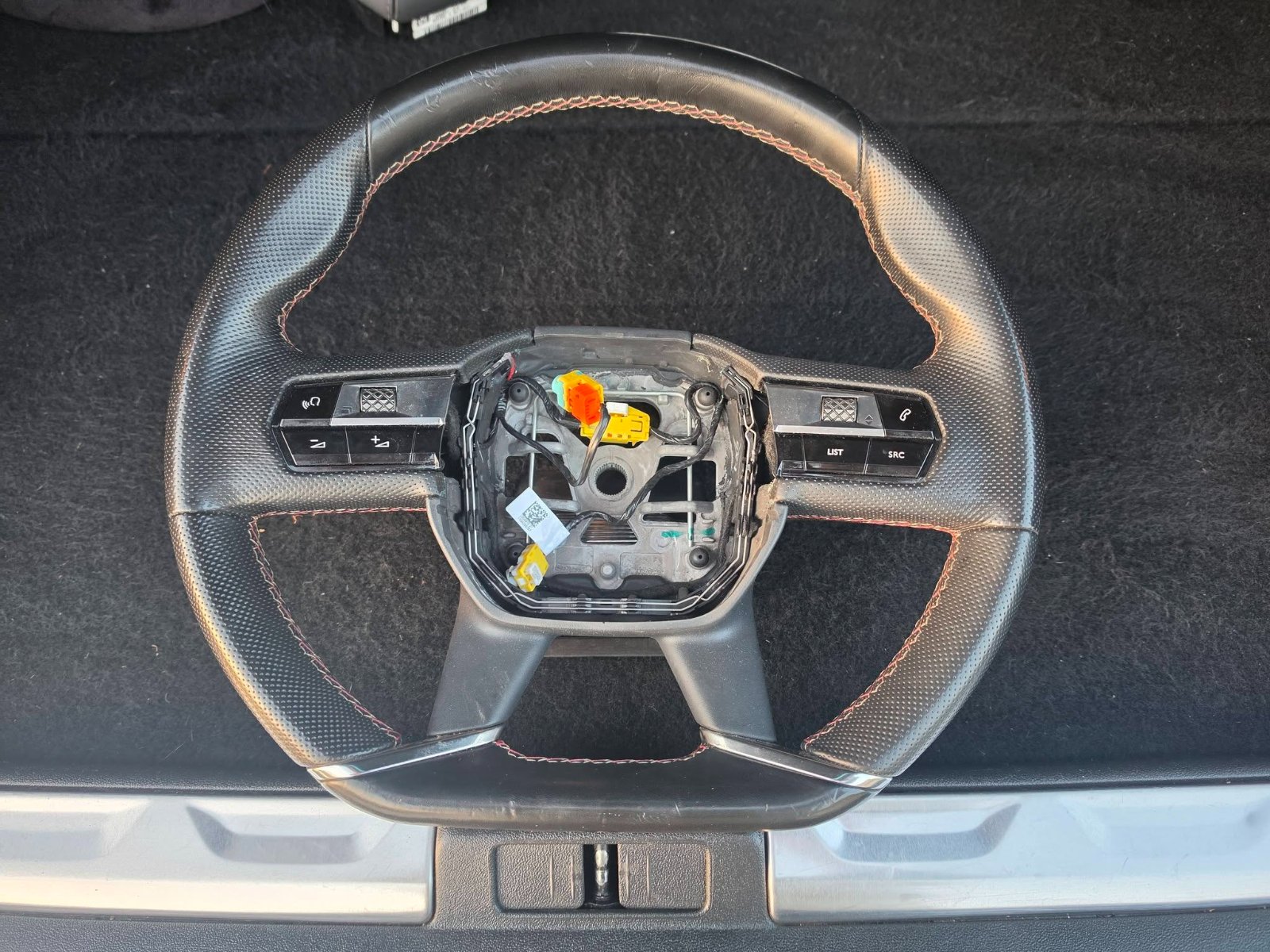

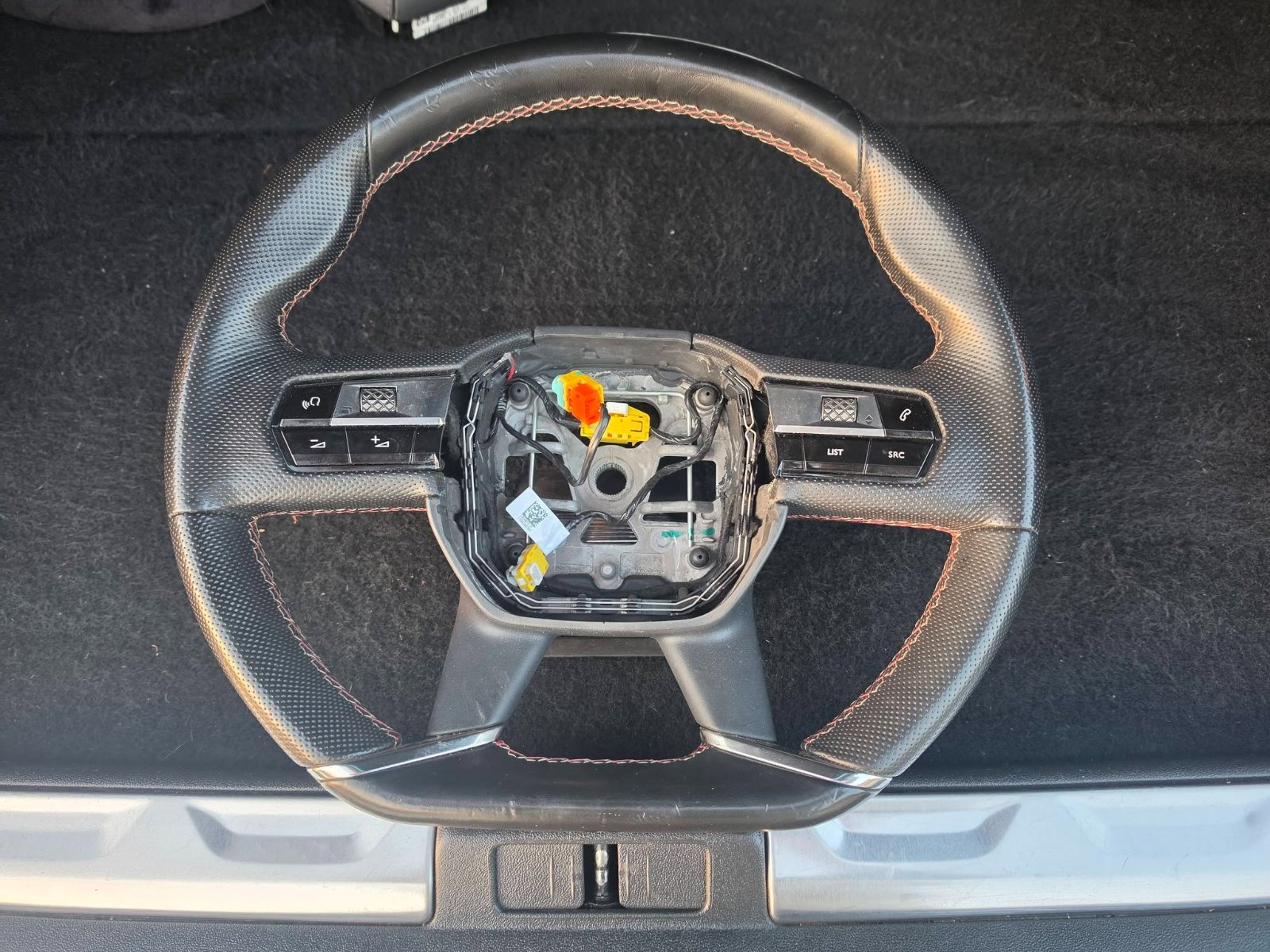

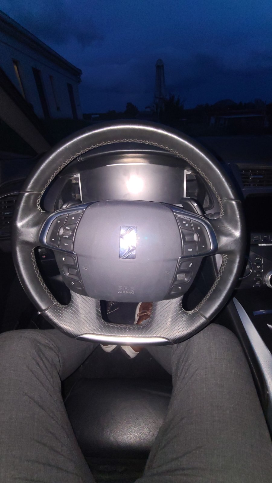

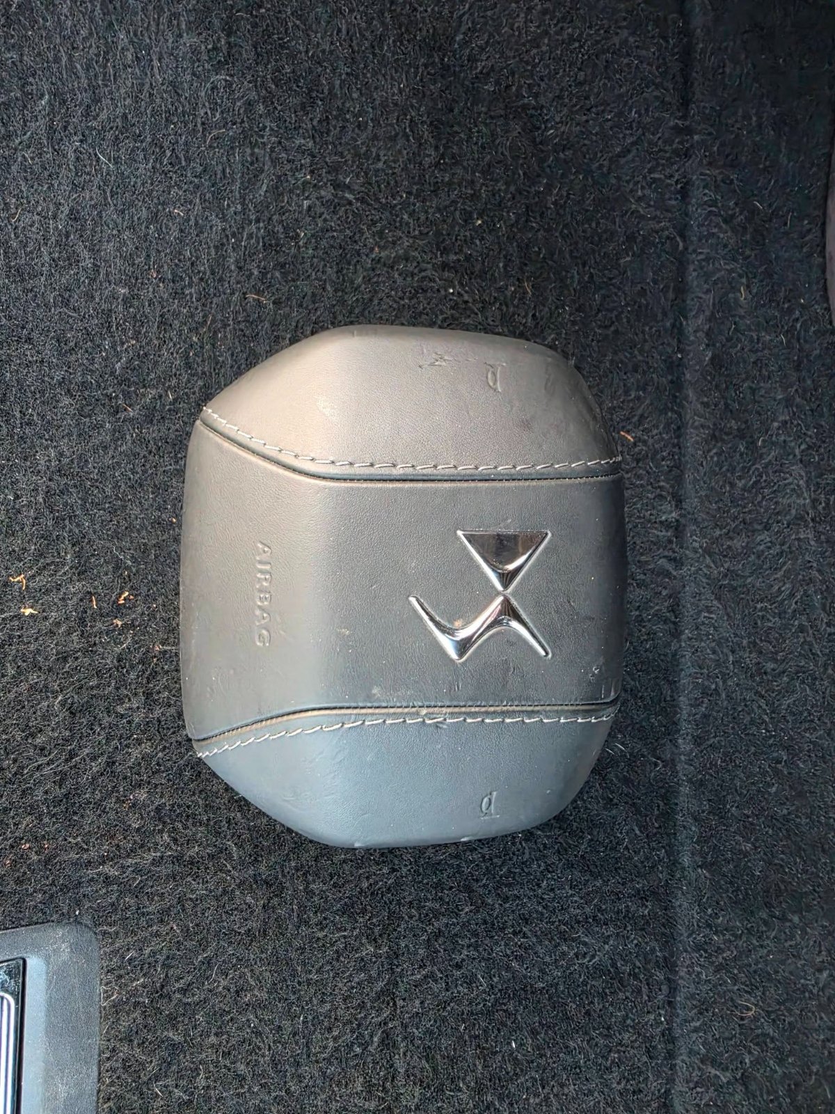

New installation Today. DS7 stalk (wiper - indicator - Cruise). DS7 performance Leather Steering Wheel, and DS7 Leather Airbag.
Installation is straight fwd but you need to make an adapter (i did) or to repin the Plug. Need also pay attension with the stalk center position (otherwise an esr/esp error wil apear).
Software Modifications have been accomplished using Vluds Psa-Arduino-NAC/RCC to let the Car understand the steering Wheel.
The new steering wheel is smaller but thicker in the grip.
For those who replacing the rt6 to nac with Scirroco this modification is a "must" because is adding more advance controls and is more suitable to the new modern cars.

Could you send config for cirocco? I did this same in my ds5 but without the steering wheel, I don’t know what to change in vlud arduino tool, also nac config would be helpful.gstrouzas wrote: 07 Mar 2026, 18:31 New installation Today. DS7 stalk (wiper - indicator - Cruise). DS7 performance Leather Steering Wheel, and DS7 Leather Airbag.
