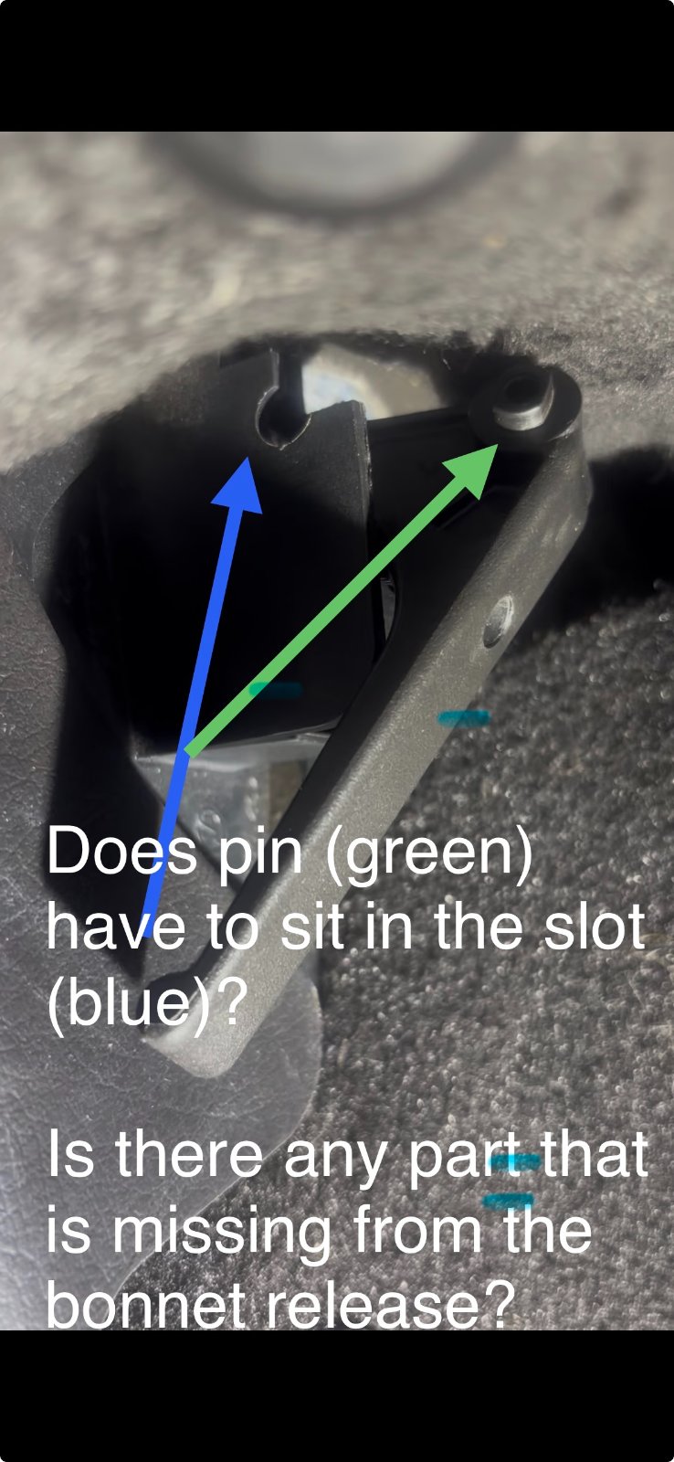

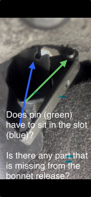

But first I need to get the bonnet open. Yes, I know how to do that, but only when the lever in the front passenger footwell is connected and working. :P
The bonnet release lever has disconnected itself from the side firewall. I don’t know if this shows very well what I’m talking about, but I can try! If you need to ask me questions about it, go ahead.

I cannot make head nor tail of that picture. Sorry!

Yes. I can. I guess so. It looks identical.
Try using an index finger and thumb to act as fulcrum whilst 'pulling' lever with other hand and see if that works.
I’ve been trying that but I don’t think I can get enough leverage. I think that’s what the problem is.

I wish you luck with that lever. It's in a horrible position to try and resolve though it does look as though it will clip back in. You might have to give yourself some slack by unhooking the bonnet end. But, then again, you cannot get IN!!!

I wish you luck with that lever. It's in a horrible position to try and resolve, though it does look as though it will clip back in. You might have to give yourself some slack by unhooking the bonnet end. But, then again, you cannot get IN!!!
I agree that it looks like it should clip back in. But I haven't been able to find any images online of it in situ. There must be some, but my searching skills are not up to the task.
I'd also be surprised if I'm the first 307 owner who's encountered the lever coming away from the side wall. I can't remember exactly when the 307 was introduced, but it was in the early 2000s, I think. In 20+ years, am I the only person to have encountered this problem? Am I the only person who has tried to fix the problem themself? And there are no videos online with guides to repair? I know I'm unique, but this is ridiculous! A 70ish year old back isn't ideal for getting down into that space and twisting to be in a good position for re-inserting (or whatever else is required) the lever into the 'holder'.

ozfrog wrote: 22 Feb 2026, 04:10I agree that it looks like it should clip back in. But I haven't been able to find any images online of it in situ. There must be some, but my searching skills are not up to the task.
Is it, I was going to say Mark 1 or Mark 2 then realised we're talking about a Pug...
ozfrog wrote: 22 Feb 2026, 04:10 I'd also be surprised if I'm the first 307 owner who's encountered the lever coming away from the side wall. I can't remembere exactly when the 307 was introduced, but it was in the early 2000s, I think. In 20+ years, am I the only person to have encountered this problem? Am I the only person who has tried to fix the problem themself?
Unlikely!

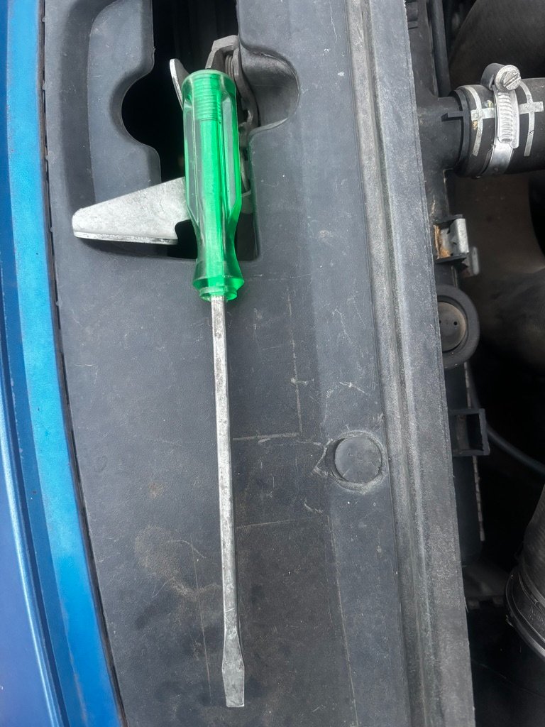

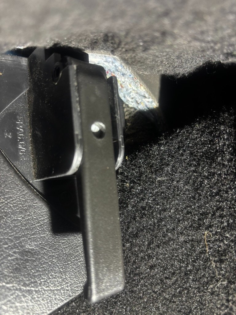

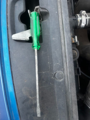

Success!
Bonnet release lever reinstalled
I'm sure that I was correct about why I hadn't been able to do it previously - not enough leverage. Because today's success was made possible with the help of
One medium length reinforced screwdriver
Now, back to those other faults!

That's fantastic news.
Makes you wonder why it came out in the first place. If it feels REALLY stiff when actuating, it might be an idea to try and get some lube into the cable and drawn up by capillary action.

Thanks. I really appreciate that. Little successes mean a lot some days.
Ever since I purchased the car, I think, in late 2014, the handle hasn't felt 'right'. I always felt like it was going to break, but I didn't know what was going to break. I wasn't in the least surprised last week. I just had to figure out what had 'broken', and then how I was going to fix it.
I contacted a dealership yesterday afternoon and explained the problem to the service manager. He said that I'd need the parts department to send me the exploded view of the cable handle. I thought that was a sensible idea. What I received was a full breakdown of the cable from the bonnet latch to the handle, but not including the handle. They also sent me the removal and refitting instructions for the cable. In other words, nothing useful to me!
In the end, I went back to what you suggested, and what I had initially thought. Pushing down on the top end of the lever, but using the screwdriver to get the extra leverage.
