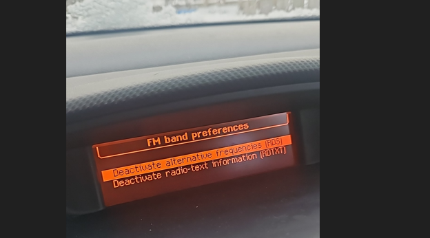

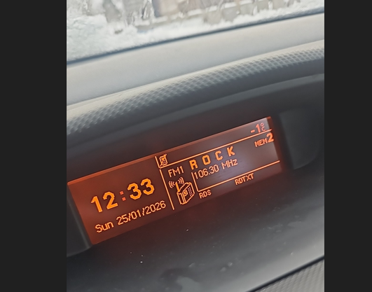

I recently upgraded from RD4 to RD45, got a new display also, i finally have bluetooth music and handsfree calls. But i cant seem to get TA (Traffic announcements to work). Using diagbox 7.40, i checked the region which was China, the only i could change to was:
China
Japan
South America
USA
Other Contries
Since i live in Sweden i choosed other countries, i have double checked that everything with TA is enabled in diagbox, TA worked perfectly with the old RD4 Radio, any ideas? The new RD45 radio only has a "mute" button and not a TA button. Thanks!
