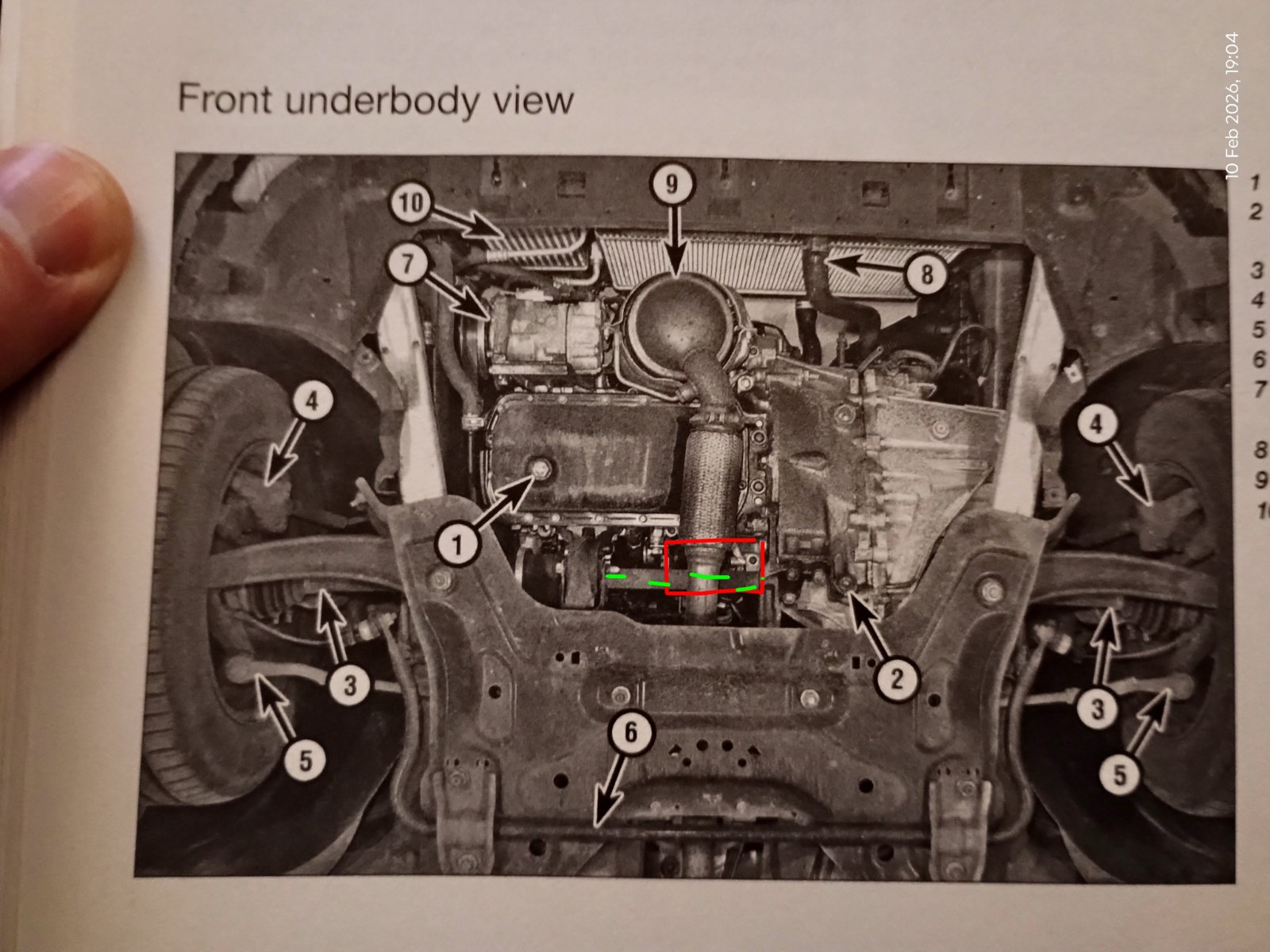

Go from underneath (undertray off, if fitted and) it'll be roughly central, behind the sump. Find the long driveshaft and follow it towards the gearbox, then it's vertically above the end of the shaftAuldalliance wrote: 10 Feb 2026, 18:11 A little bit of progress today, dodging rain showers.
Battery and tray are out. There's a lot of water leaking in to that area, running down the windscreen. So I won't be surprised if I find some corroded wiring.
I still haven't managed to catch a glimpse of the starter. From the videos I've watched it should be somewhere underneath the battery?
Picture courtesy of Haynes: Red: approx starter location.
Green: long driveshaft

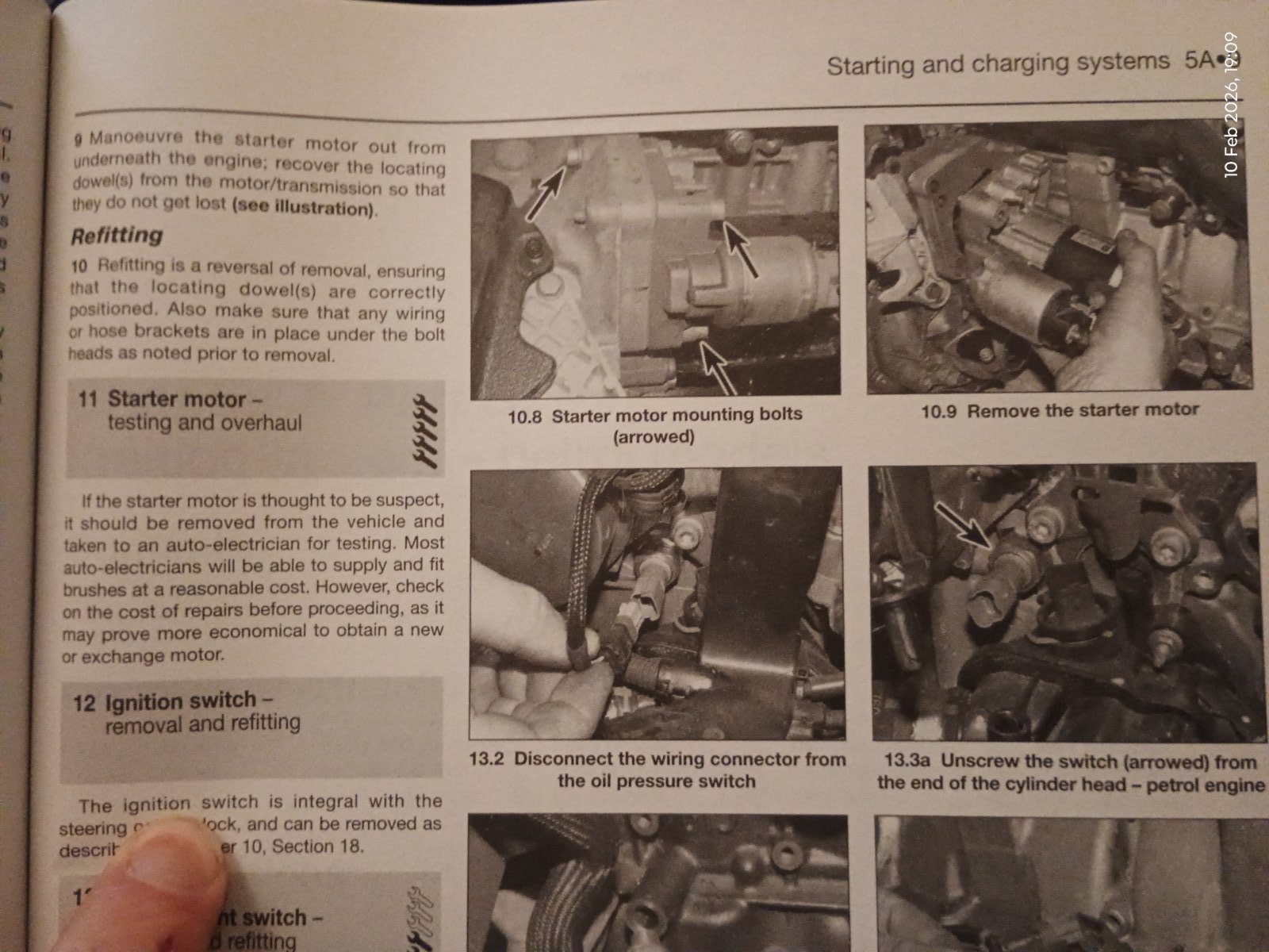

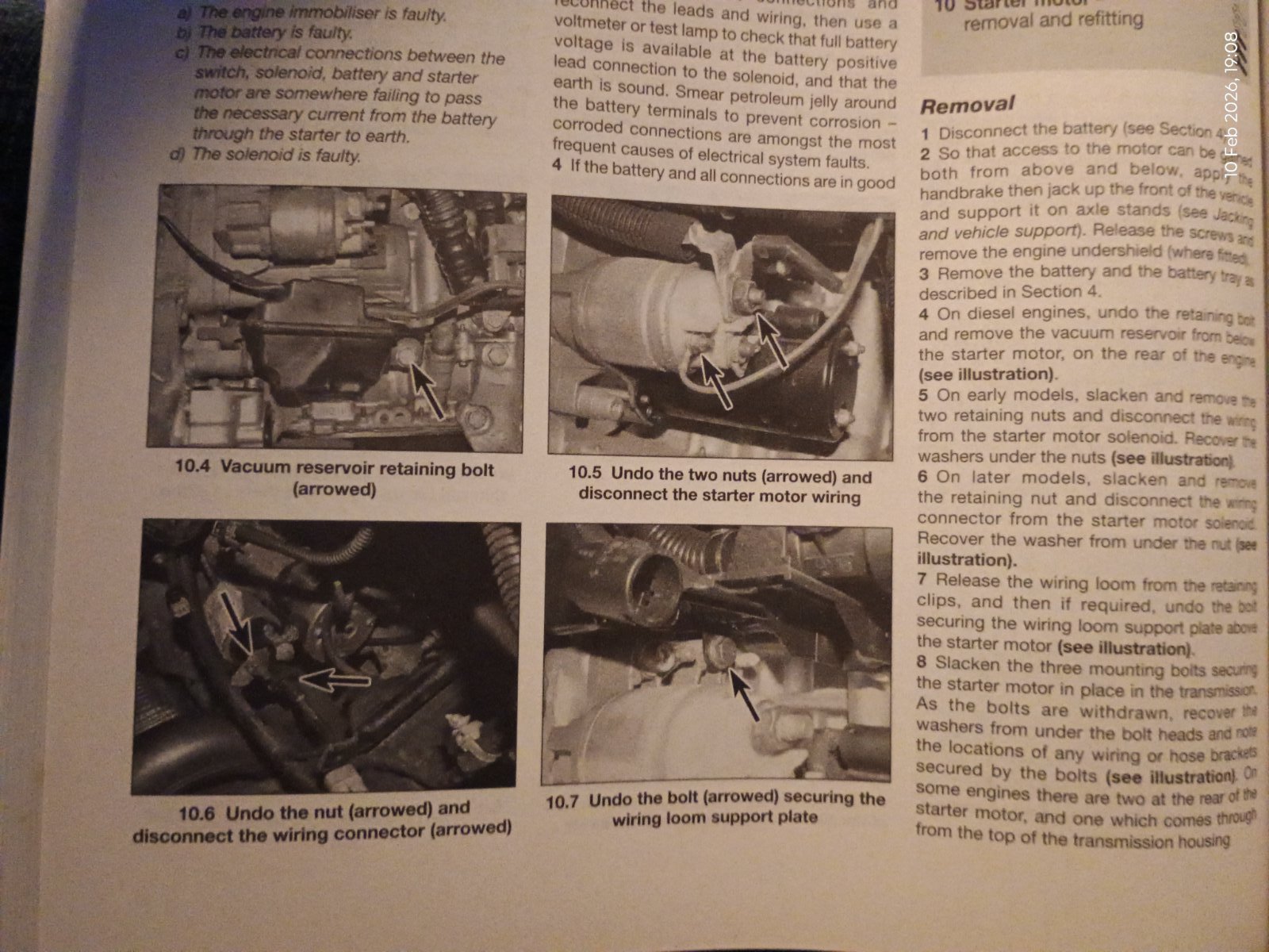

Re: 1.6HDi not starting...
In fact, here's Haynes lies about the process of getting the motor out.

Starter motor located... from underneath. Not an easy place to work, is it!
I must be missing something because I don't see any reason to remove the battery and tray, as Haynes and various videos have said to do (I've also done this and there's no way I can get anywhere near the starter from the top).
