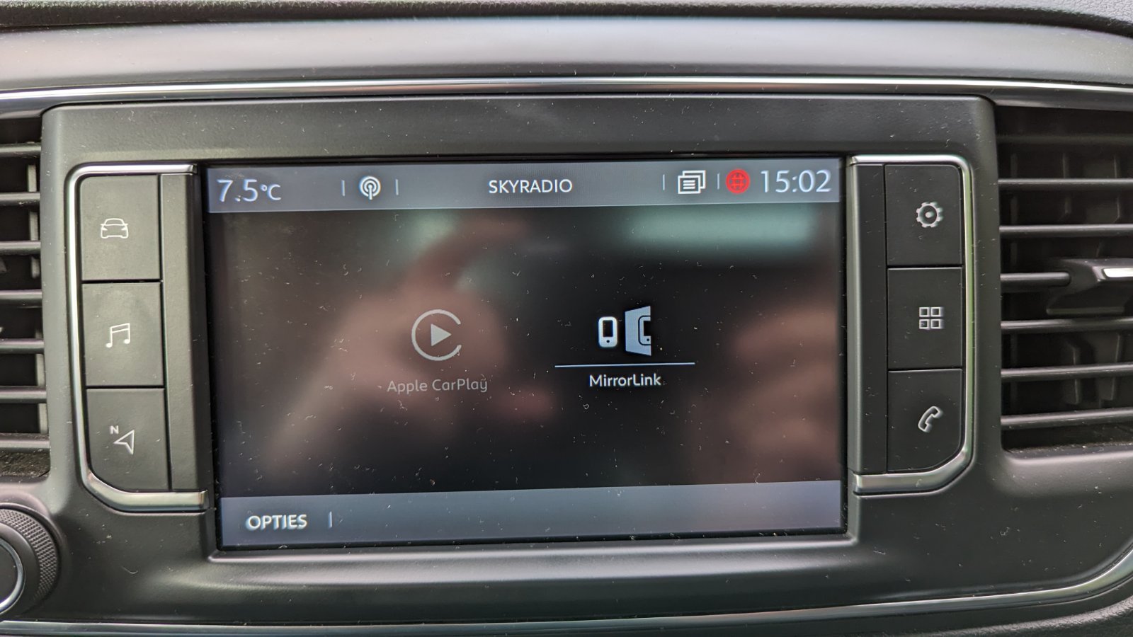

Hi all. Bought a 2017 SpaceTourer. Love the van. However, only the Apple CarPlay and MirrorLink icons are visible in the app menu. Android Auto is not there. The Android Auto compatibility site however, shows that the this model is compatible with Android Auto. I have updated the NAC firmware, tried multiple cables and Android phones, including a Google Pixel, but doesn't work.
When connecting an iPhone, it works perfectly. Here a picture of the NAC:
Anyone has seen this before? I feel like the feature should be there, it just needs to be activated. Maybe through OBD2 port?
*update* I have put some more research in this. My SpaceTourer has a Wave 1 NAC. I read on some other forums that Wave 1 does not support Android Auto because the hardware of the main unit doesn't support it. To add Android Auto, you would have to replace the main unit of the NAC with a Wave 2 or higher NAC. If this is true, Android Auto will never work on a NAC Wave 1. Is this true? Is there anybody with a NAC Wave 1 system with Android Auto? The firmware would be 7.3.1-r1.
Cheers!
Cheers!

The NAC Wave 1 infotainment system (NAC_EUR_WAVE1) doesn't support Android Auto (AA) and never will because it lacks hardware.
With the NAC Wave 2 (NAC_EUR_WAVE2), it really depends on the firmware version: you need a 21.0*.*.*_NAC-r* version to support AA (older 5.15.*.*-r0 versions, released before Jan 2017, don't have that support). This is the only case in which you could enable AA with a firmware update.
For the RCC units (without satnav), either Wave 2 or 3 (RCC_EU_W2 or RCC_EU_W3 / RCC_EU_W3_ECO), there are 4 different hardware variants:
The MirrorScreen is what PSA/Stellantis calls their systems that support Apple CarPlay (CP), Google Android Auto or MirrorLink.
So to have AA support, you'll need an RCC A2 hardware, which could be identified by the last letter of the system version, either a xxxC or xxxD. For instance, with the latest RCC Wave 2 firmware, 1_076_16.1B116.4, you should see a "076C" or "076D".
NAC Wave 3 and 4 systems (NAC_EUR_WAVE3 and NAC_EUR_WAVE4) should all have AA support, except some Toyota vehicles that have it disabled (but CP is enabled). Those are the only ones that could be enabled through the OBD port and telecoding.

Thank you Rui, that's really helpful, I hope to get the car tomorrow so presume i'll be able to check system version through the interface. In the meantime, I'd set up a MyCitroen account and in the app; the vehicle touchscreen indicated there was a firmware update due, I emailed myself the link to download the software update and it dropped the firmware update onto a USB stick, I'll try figure out which version it downloaded and check against your RCC updates list. I've tried to check the MyCitroen touchscreen update since, but the updates service seems to be temporarily unavailable. Many thanks again.

I checked the downloaded firmware that Citroen's update software downloaded and dropped to my USB key, it concurs with the latest RCC Wave 2 firmware, 1_076_16.1B116.4 as listed on your NACC-RCC versions site - https://sites.google.com/view/nac-rcc/, so I should be upto date. I will note the existing revision before I perform the update, just in case.
Checking my VIN on your site confirms the head unit is an RCC Wave 2, it definitely has Car Play and MirrorLink so from your table above it should be an A2 unit, and I can't 100% remember, but I thought it had DAB, either way, it should still be an A2, and I will look for the firmware revision ending in a C or D.
My latest question based on having read through other threads on this forum, about NAC-RCC updates is that firmware updates are usually bug fixes rather than feature updates, my car was registered in April 2018 and I understand that Android Auto was installed on Spacetourer head units from 2017, does my assumption suggest that it was installed and subsequently removed, or was it perhaps never installed - perhaps the vehicle was manufactured outside the dates from which AA was installed?
Either way, have any firmware updates resulted in Android Auto being installed or would that be a completely separate task requiring a different installation process?

In the RCC systems, installing any firmware update won't change the state of the AA. Either it has support (and I mean hardware support) from the factory (C and D variants), or it doesn't (A and B). And it is very unlikely that AA support was disabled through telecoding.
Did you use a good USB cable? Some cheap USB cables only have 2 wire conductors inside (VCC +5V and GND) and no data wires (DATA+ and DATA-, 4 wires in total) and can only be used for charging. That USB port should also read any FAT32-formatted USB flash drive with some .mp3 files.
