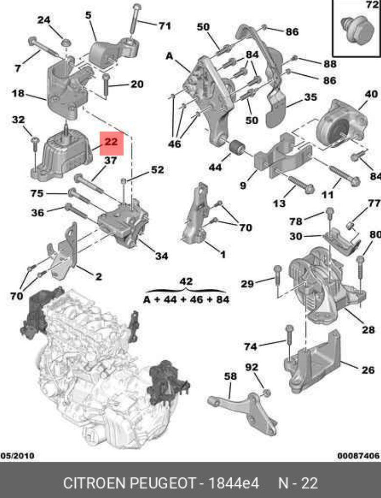

The only help I can give you is to show you the page with part numbers for your car, item 34 I believe:

Thank you!mickthemaverick wrote: 06 Oct 2025, 18:00 The only help I can give you is to show you the page with part numbers for your car, item 34 I believe:
C5 (X7) - 0610 01 348060A - FIXING POWER UNIT.pdf
Although I figure it's more like item 22, but that one doesn't look at all as the one I just demounted.
/Björn

Hello, I have the exact same one installed as in the diagram, number 22, but the car vibrates. Could you take a picture of exactly what you removed?

Hi,ivo lambov wrote: 01 Feb 2026, 19:42 Hello, I have the exact same one installed as in the diagram, number 22, but the car vibrates. Could you take a picture of exactly what you removed?
I'm on vacation right now but I'll try to take a pic when I have the possibility. Although, I replaced a lot of stuff at the same time (timing belt, water pump, oil cooler, diesel filter + +) and removed "everything" up there and used an engine support bar. I don't remember right now which parts I would have had to remove to only change part "22". I also replaced the other engine mount, part number 5 in the diagram.
Before I replaced the engine mounts I had pretty significant engine movement but it's totally gone now, and no vibrations whatsoever.
