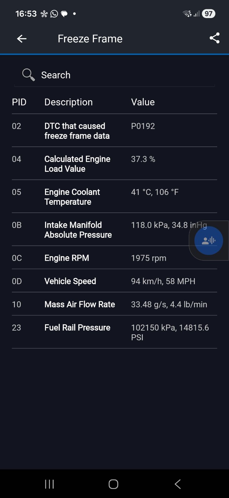

Just had a chance to look at freeze frame, and it shows 102150KPa, 14815psi.
That's quite a bit, and up in normal range I think ? Looks like the sensor was reporting diesel was pumping OK?
No diagbox yet. Replacement laptop has refused the virtual machine copy and I'm starting afresh!

Possibly 1021 bar fuel pressure is too low at 1975 rpm but I have no reference values. In this topic a similar fault was fixed by replacing the pressure regulator on the fuel pump. PF Jones sell pressure regulators, reconditioned ones as well as new one and could be cheaper than a Peugeot dealer. If you can check the high pressure fuel pump it may have a label on it with its part number which will help getting the correct part. viewtopic.php?t=80521
