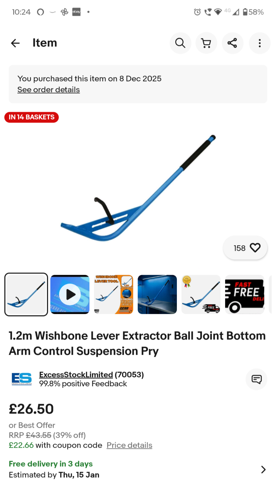

Getting the wishbone low enough to pop the ball joint into place is the challenge. A length of timber (I have a length of 3"X2" (50x75mm) timber about 1500mm long) a few shorter blocks and something to wrap around the wishbone (e.g. tie down strap (not a bungee rope!), or even some old mains cable will do. If you set that up you can use your bodyweight on the timber lever and then have both hands free to shove the hub about.
I've recently got one of these: But not used it in anger as yet!
