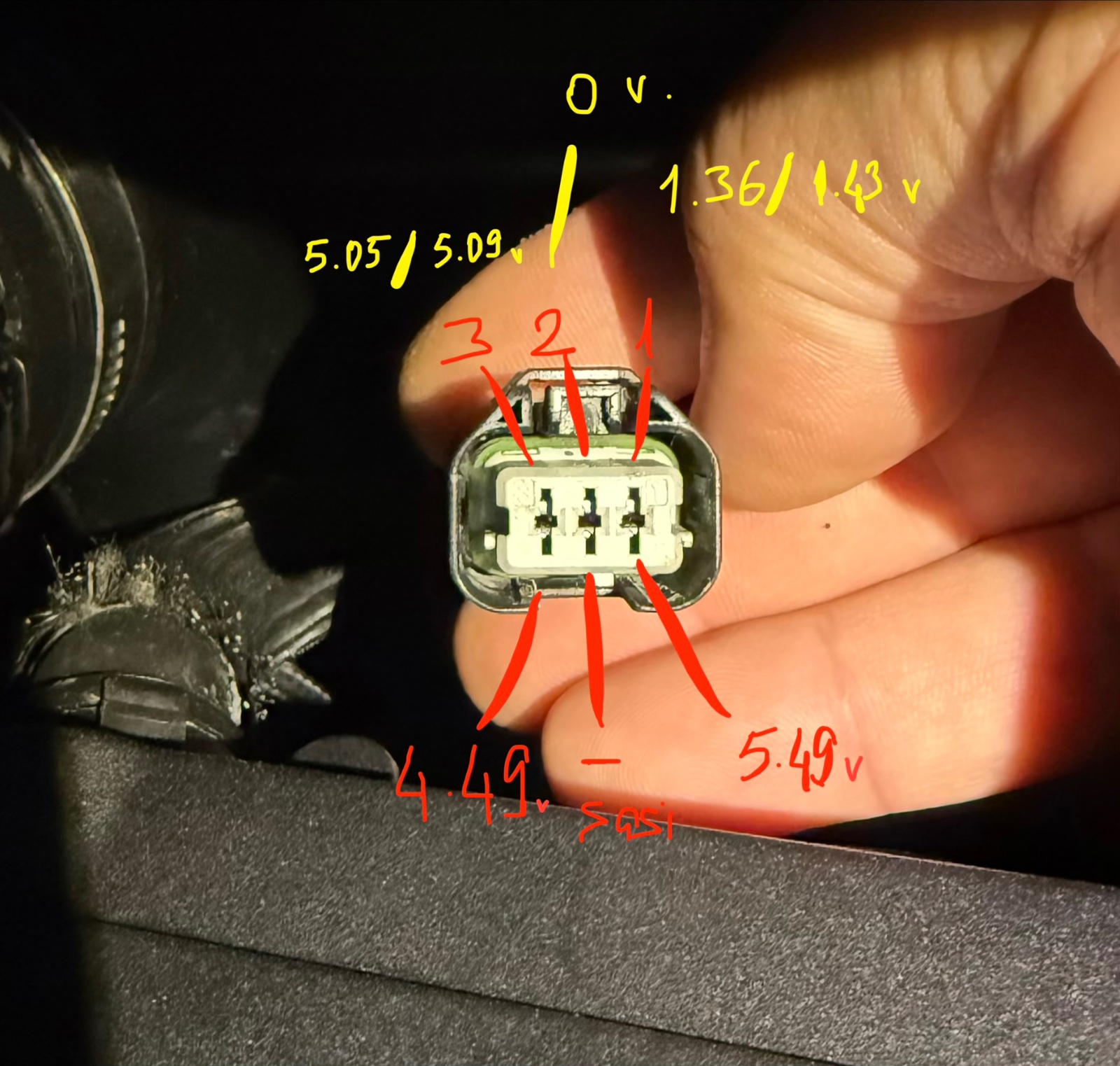

I disconnected the MAP sensor socket while the car was not running and measured the readings. The readings in red in the image below are the ones I measured. Then I reconnected the MAP socket and measured the pins from the back while the car was running; those are the yellow readings. Isn't that strange? I disconnected the MAP socket and started the car; the manifold pressure continued to read around 1000-2000 something. Then, to measure the ECU wiring, I applied 1.29 volts to the negative and signal terminals of the socket and checked the data with the diagnostic box, but nothing changed; it continued to read high. When I removed the 1.29 volt battery and reconnected the socket while the car was running, it started reading values ??like 180-40-50-250. Just when I thought it was fixed, the car was cold. I think it continued to read high values ??when it warmed up. Could the ECU be faulty? I measured the wires up to the middle socket of the ECU; there is a signal, and it's not grounding with a different wire in the socket.

The values ??written in red are only the values ??obtained when the ignition is on. Then I plugged in the connector and measured the connection from the back of the connector while the car was idling; those are the values ??written in yellow.

Yes, yes, when the car is running and the connectors are disconnected, the turbo pressure shows around 2750. I think this is normal because it's not reading correctly. The MAP sensor continues to show values ??close to these numbers: 105-250-800-1700-2350. If the MAP sensor wasn't working or there was a problem with its wiring, shouldn't it give a stable value like the turbo pressure? The manifold pressure continues to read very strange values. As I indicated in the image above, there's no communication problem with the connectors going to the ECU. The values ??written in red are the values ??shown when the ignition is on and the MAP connector is disconnected. The values ??written in yellow are the values ??shown when the connector is plugged in and the car is running.
