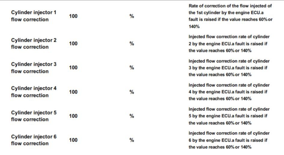

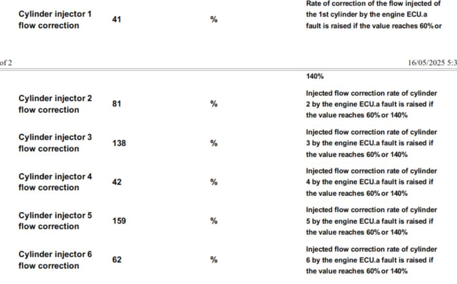

Diag global test seems to reports inconsistent injector correction readings (unless I am reading these wrong)

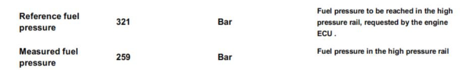

P1164 fuel pressure signal (pressure coherence) - seems to be an issue at idle based on the pic attached
eg - @ 640 rpm it is asking for 321 bar but only getting 259 bar

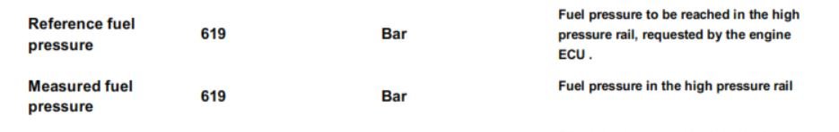

- @ 2944 rpm it is asking for 619 bar and getting 619 bar

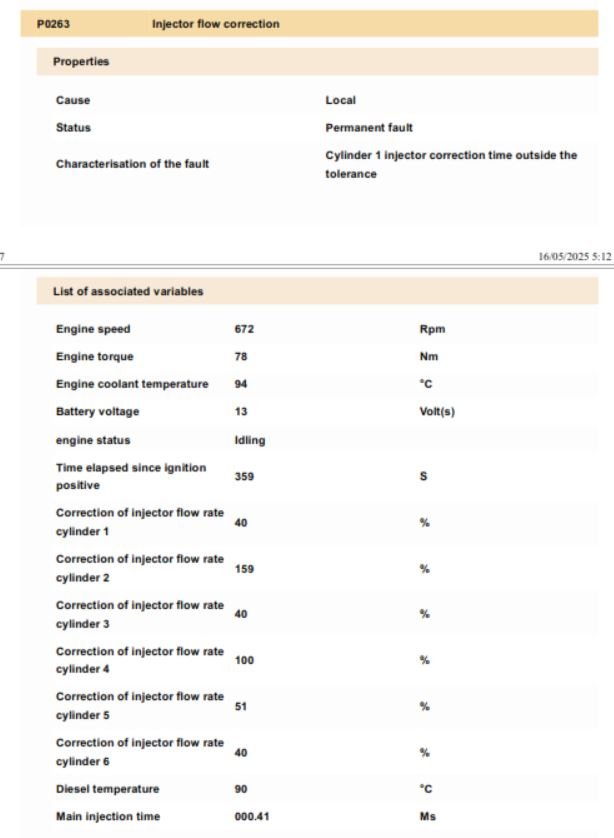

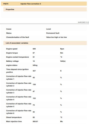

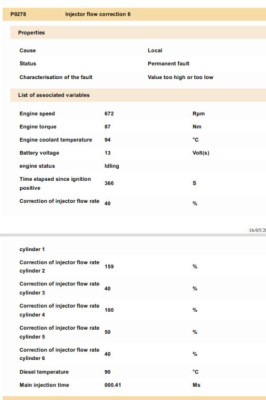

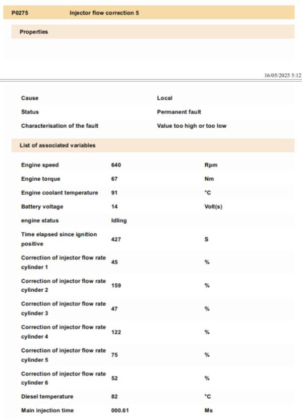

P0263 (cylinder 1 / injector 1) - 41% injector correction time outside tolerance

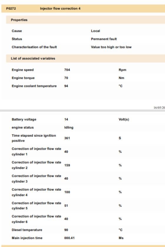

P0272 (cylinder 4 / injector 2) -100% - this makes no sense as 100% means it should be okay
P0275 (cylinder 5 / injector 4) - 50% or 75% - not sure why different reports have different % noting the ECU says it only reports if is it is below 60% and over 140%

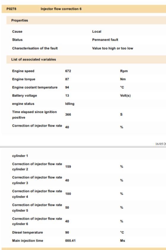

P0278 (cylinder 6 / injector 6) - 40% -below 60% so an issue for the ECU
Looking at other readings (see pics attached), I'm not sure why the ECU did not flag some of them eg Cylinder 2 / injector 3 - 159%, Cylinder 3 / injector 5 - 40%
