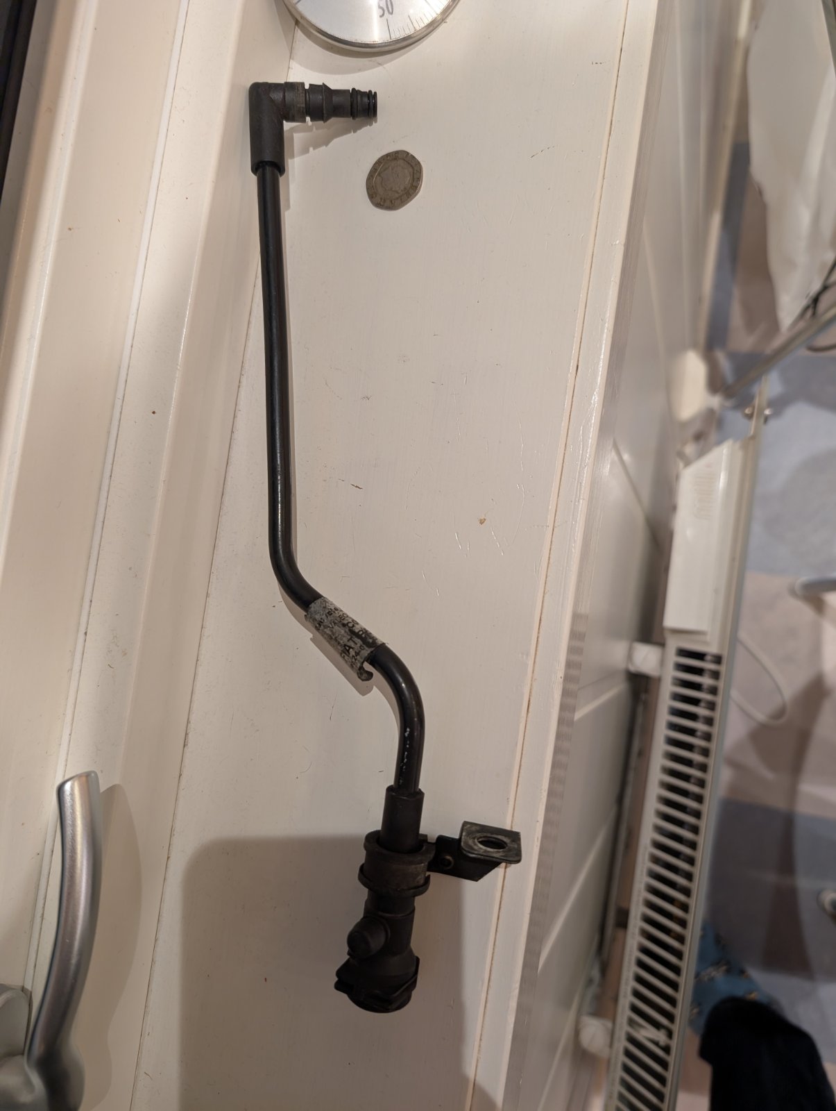

Does anyone have a part number for the hose going into the slave cylinder of a Peugeot Boxer with a 2.2 HDi?
I've just replaced the clutch and when bleeding the clutch the pedal won't return and I can see that instead of the system holding pressure it leaks out of the bleed nipple. Note it's a plastic slave cylinder where the hose coming from the master blocks off the bleed valve.
This was also pressed in with zip ties by the previous "mechanic" that had a go at it. As well as being held in with it's clip of course.
To be it seems like the bottom o-ring is a bit loose and doesn't seal properly, I haven't been able to find the right size o-ring that can stand DOT4 so I'll just replace the whole hose.
If anyone has experience with this and knows what the problem might that would be great. Otherwise I'll just try replacing the hose and slave cylinder as the slave cylinder is quite cheap.
