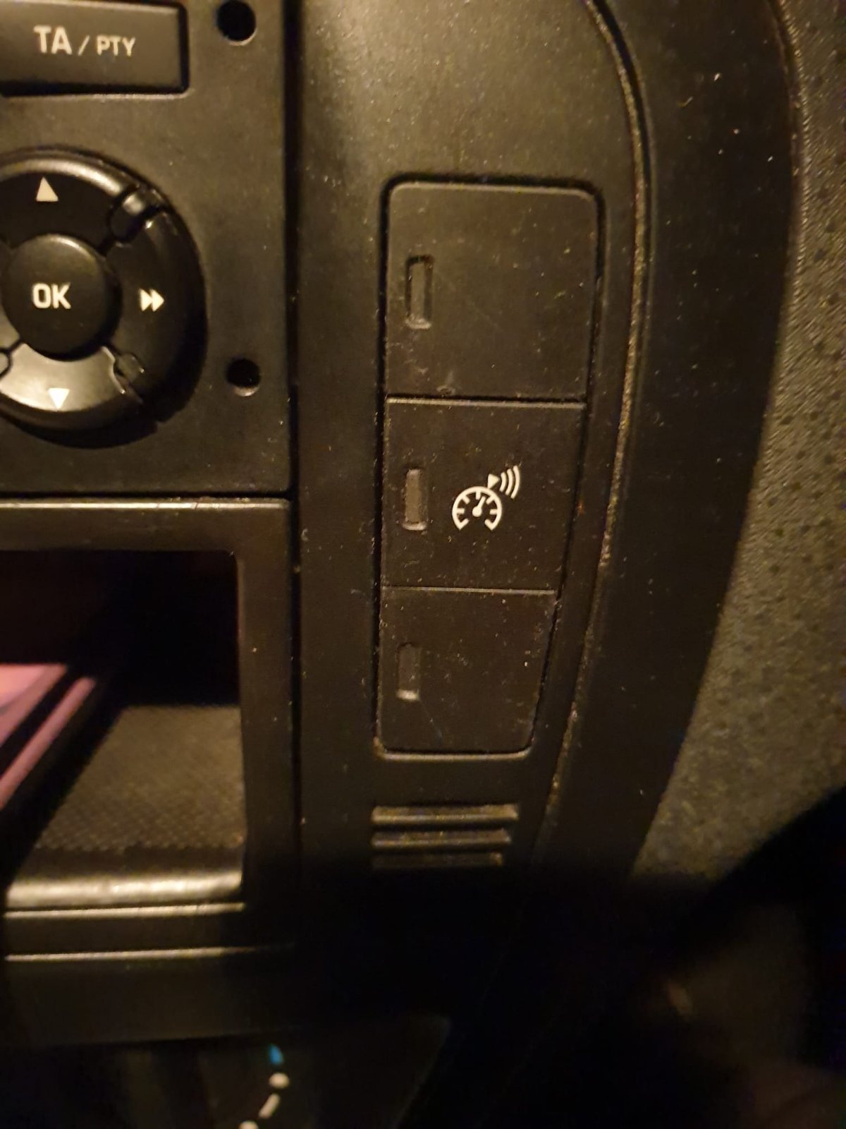

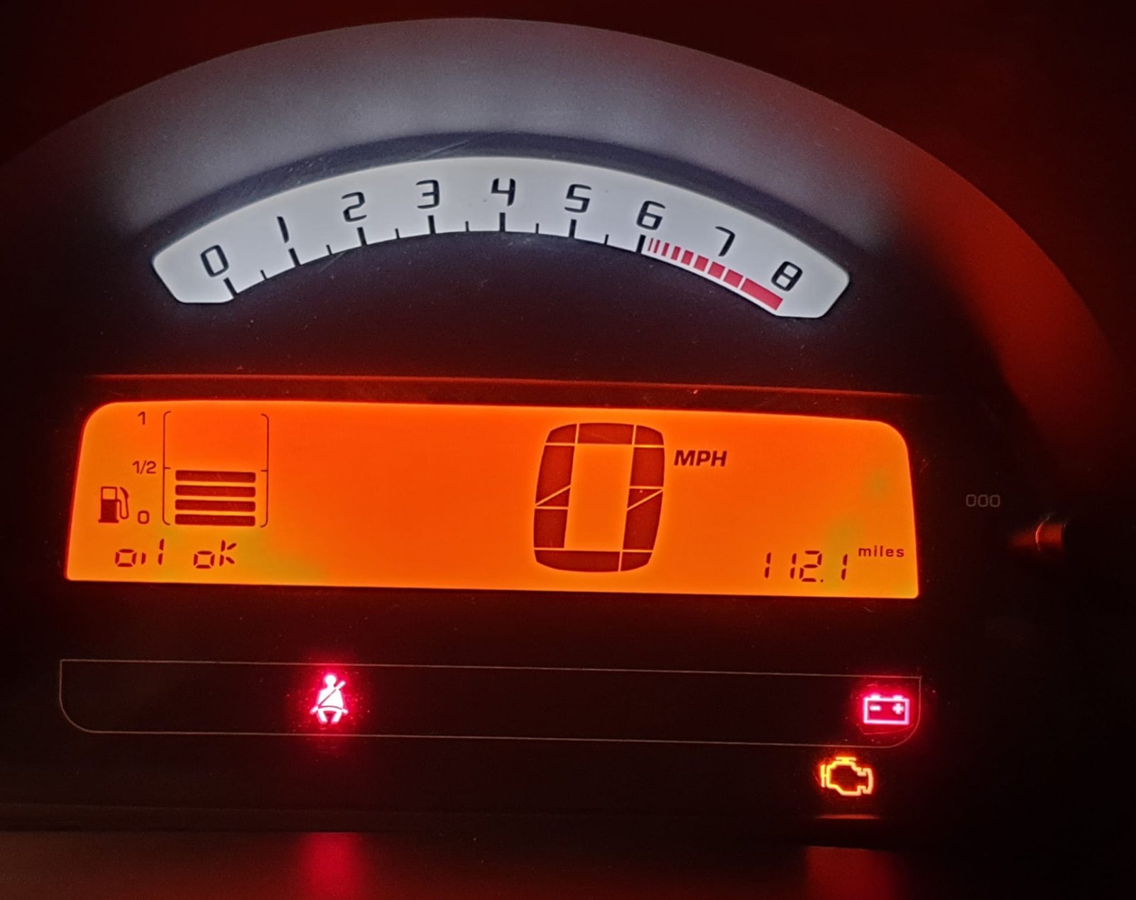

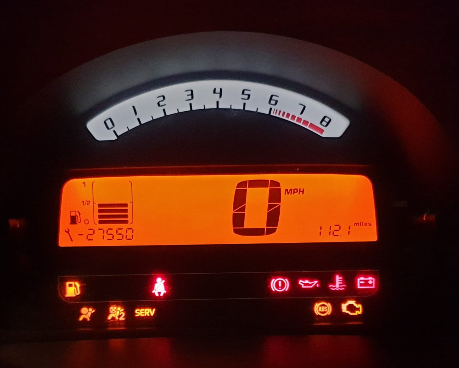

Hi, I do think I have ESP., See attached photos of the dashboard lights, which come on when I turn the key to ignition, and most of them go off.ozvtr wrote: 03 Dec 2025, 22:58I would assume you have ESP? The fault will be that the steering wheel position and the yaw sensor are not in agreement.Monty DIY wrote: 03 Dec 2025, 20:41 and how to check the steering wheel sensor fault. Can I reset the Steering wheel sensor?
I would seriously suggest that you get a wheel alignment at a shop that has a scan tool that can do the job (can interface with the C2). The steering angle sensor in the COM2000 will need to be reset.
I don't believe that there is just one fault in play here. The suspension is very simple, but you will require special tools to check the geometry.
The rear end cannot be adjusted. If the rear has suffered an impact that effects alignment, the car may not be economical to repair.
All I have done is change the ball joints, but the steering wheel issue was still there. During the changing of the driver side ball joint, the whole suspension moves outwards, dislocating the drive shaft from the gearbox. I am not sure if this could have caused these issues?

None of those lights or buttons indicate that you have ESP (not sure the C2 ever had that tbf?).
The button you're showing is a 'speed warning' function.
I agree with others, the wheel alignment is a purely physical mechanical thing, nothing electronic so if it 'looks' wrong then take it to a garage for an alignment check.

I notice the service countdown is showing 27550 miles overdue. It will be in the handbook on how to reset this after a service but is typically a button on the dash is held down (or possibly on the end of a stalk) and the key turned so the dash lights up. It will then countdown from 10 to =0 and then you can release the button and start the engine.

Thanks. I showed those buttons to prove that I do not have ESP.wurlycorner wrote: 10 Dec 2025, 11:22 None of those lights or buttons indicate that you have ESP (not sure the C2 ever had that tbf?).
I understand wheel alignment is mechanical. The car never hit any curbs or had issues with tyre wear. Now, only the passenger side wheel is wearing on the inside. Further, the wheel alignment will not cause the steering to become too loose. I will get the alignment done, but I want to sort out the loose steering.
