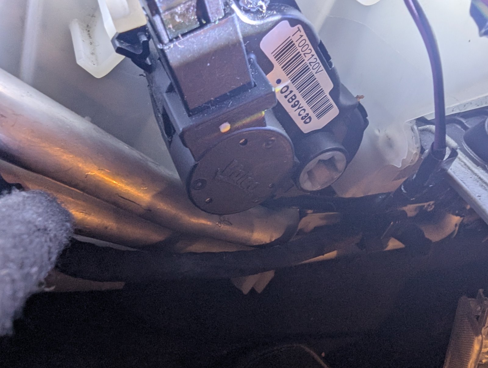

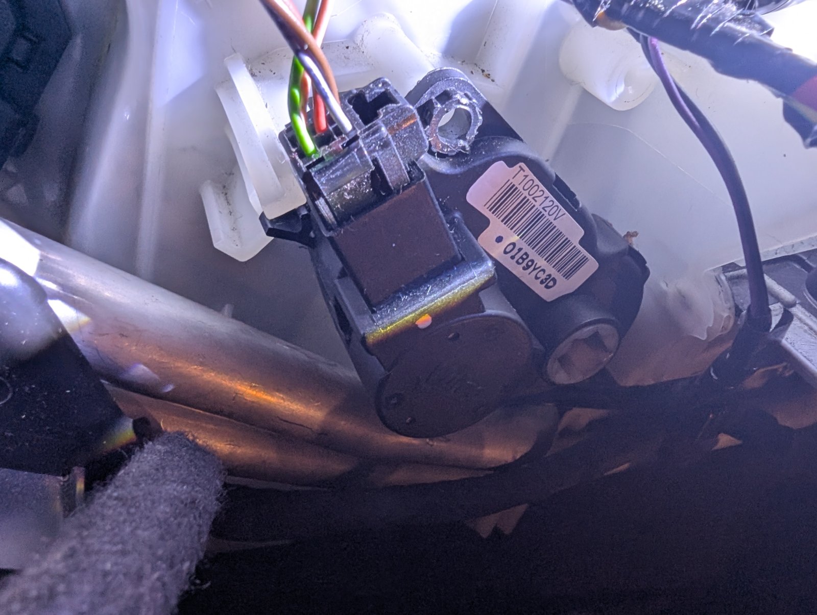

Hello all
Any tips on how to remove these from a Peugeot 308cc? No bolt but not sliding out.
Thanks
Justin

Are you trying to remove the plug or the unit? :)

Looking at pictures of this one on ebay, it looks as if there is a bit of a thread on the back so the motor will have to be twisted possibly a third of a turn to remove it. The photo one has a bit broken off so a bit of care might be needed. https://www.ebay.co.uk/itm/167949186340 ... gJTqPD_BwE
