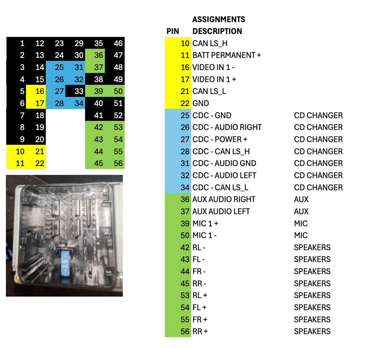

I have been searching high and low for help to wire in an RCC and so far found very little help. So I did my own research and have come up with this:
pins blacked out are unused. I hope this might be of help to someone. Please let me know!

Thanks for posting that, but I am afraid I am having a brain fade morning. Could you confirm what the RCC is and what your brilliant diagram actually portrays? :)

it portrays the plug that fits into the socket pictured

mickthemaverick wrote: 10 Nov 2025, 11:25 Thanks for posting that, but I am afraid I am having a brain fade morning. Could you confirm what the RCC is and what your brilliant diagram actually portrays? :)
jimster1905 wrote: 03 Dec 2025, 19:51 it portrays the plug that fits into the socket pictured
Apologies, it's a bit like "the ballonist" joke at present, I'm sure your answer is 100% correct, but still not quite sure what it is the socket of
Mick: jump in if it's perfectly clear to you at this point :-D
Judging by the terminology on your diagram I'd guess RCC is Radio Casette C-something???

MattBLancs wrote: 03 Dec 2025, 20:02 Judging by the terminology on your diagram I'd guess RCC is Radio Casette C-something???
Radio Couleur Connect, or something like that. Basically the NAC system but without satnav.
