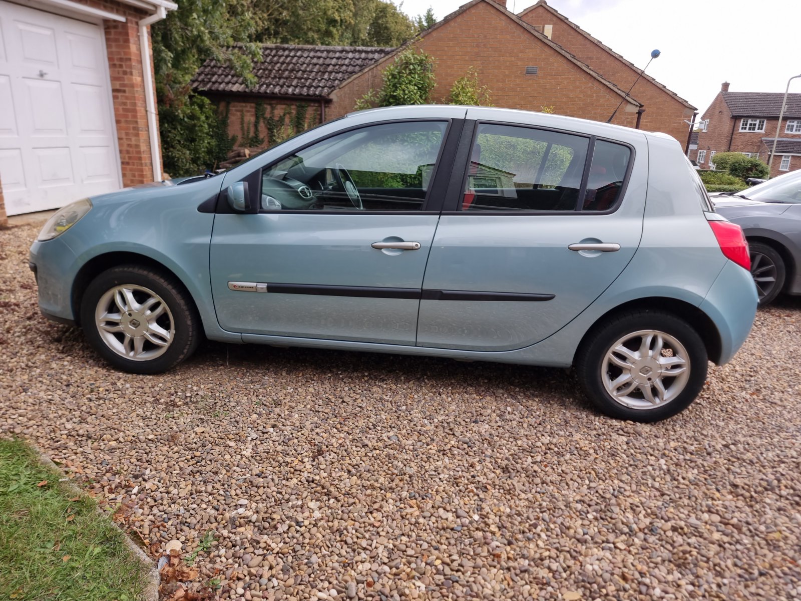

I bought a lovely Clio Rip Curl 1.2 (1149cc) recently for my kids to learn to drive in. It's 2007 but less than 60k miles and has been very well looked after, the interior is almost mint.
